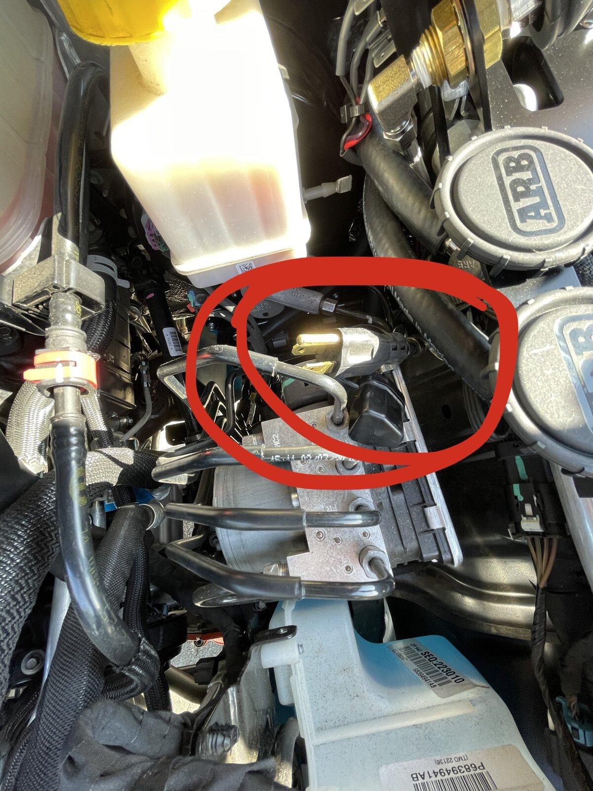

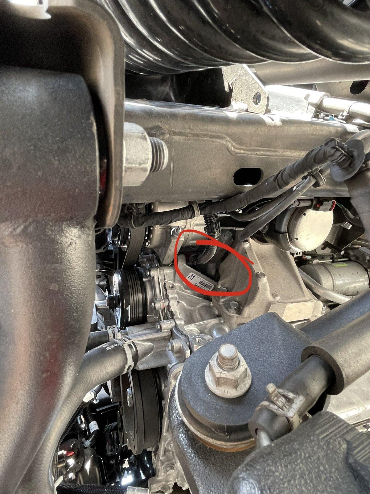

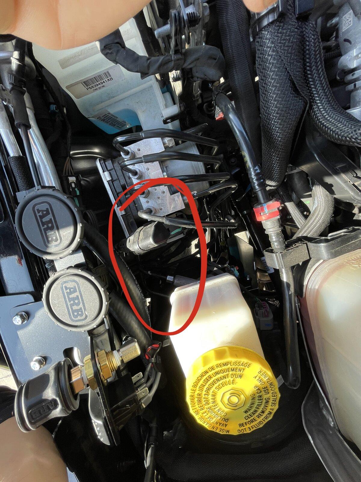

Anyone know what this is for???

Thanks guys! I learned something new today. Guess that’s something I’ll never be using here.
if you look closely in the engine bay you will probably see more cord that might be strapped together (tucking it out of the way).....most of us Canadians (not normally ohn VI where I live) have used them on many of occasions , usually the plug will be stretched to the outside of the hood so you do not have to raise/ lower the hood each time you use it.

We used to install types that went in the heater hose and literally pumped the warmed coolant through the whole system. You'd get in and start the engine and have almost instant heat out the heater.
I actually went looking for one of those types recently. Apparently they are not supposed to be used on late-model vehicles. No idea why.

That is correct it’s in the build sheet. I didn’t special order my truck it was part of the package but I had no idea that you plug in your truck. When is this useful? I’ve never even heard of this before right now.
Ugh, I wish I had never heard of it or had to use it.
Pretty much a standard feature on most Canadian spec vehicles.
They stopped working on many vehicles when they moved away from cable controls to vacuum and electric controls for the heater valve.............
We used to have to remind folks "leave your heater control on hot" otherwise the heater valve would close and they'd not be able to circulate the coolant.

I could see that as disappointing by not preheating the car interior, but if that was the only issue, it would still serve the primary function of warming the engine and the radiator. No, the warnings seemed more dire, that such devices should not/could not/must not be used on late model vehicles. I was thinking it had more to do with the way modern closed loop cooling systems work, maybe not enough thermal effect circulation?
If memory serves correct, they had a check valve installed, and were meant to be installed low in the system, either in a lower radiator hose, or a low heater hose. The warm water rising is what caused the circulation, they didnt actually have a pump.

If you go on a Utah ski vacation take an extension cord with you. Diesels don't like to start in below zero temperatures. Being from Southern California I learned this first hand during a January trip to Brian Head with my 1978 Oldsmobile Cutlass diesel.

The cord is long enough to put it out of the front of the jeep... on mine it was... its just ziptied in the middle if I remeber correctly.

Engine block heater does not come standard unless it is a Canadian market vehicle. Everywhere else, it is a paid option. Unless a Northern state dealer, most dealerships will not option it for on lot stock vehicle

I bought this one in AZ off the lot. One of the hottest places in the country lol. Weird.
