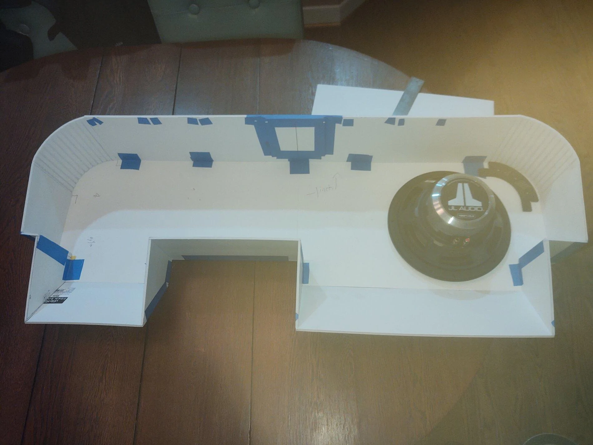

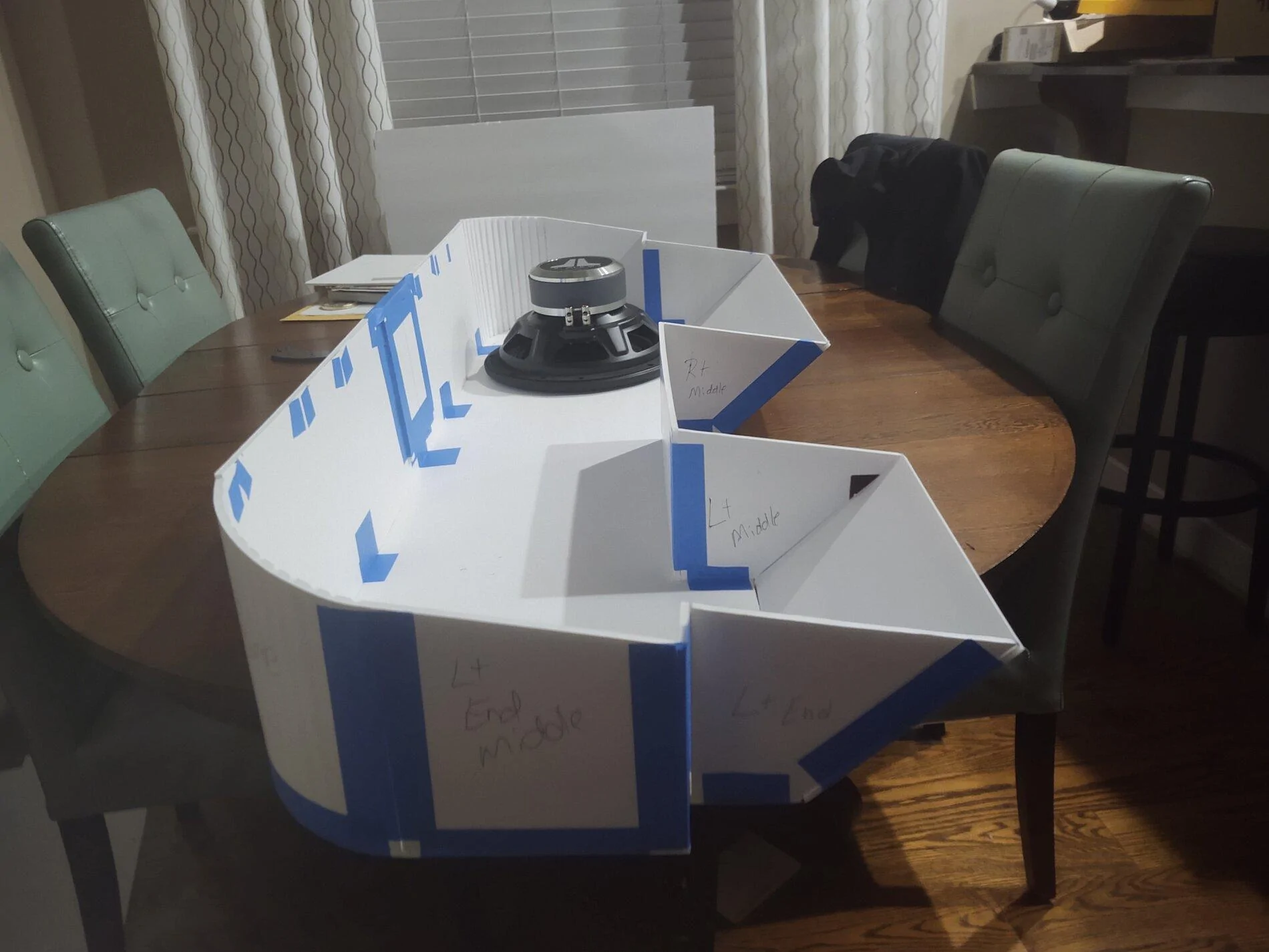

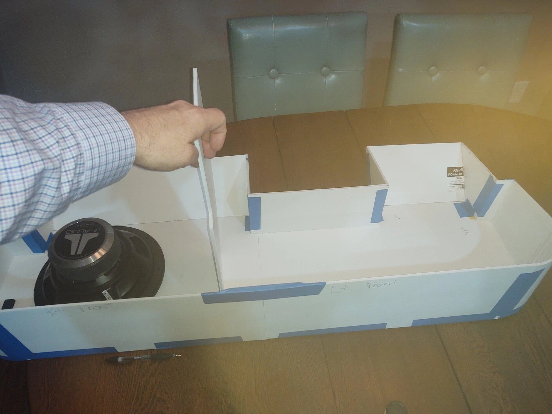

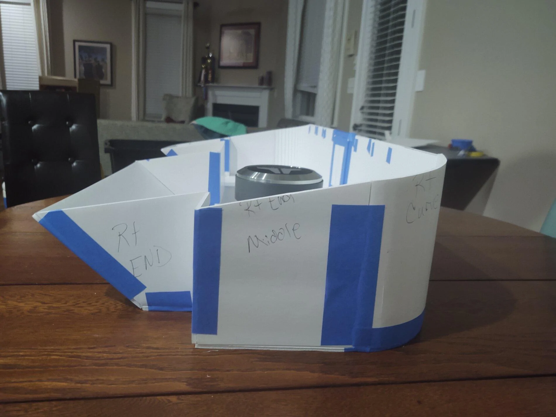

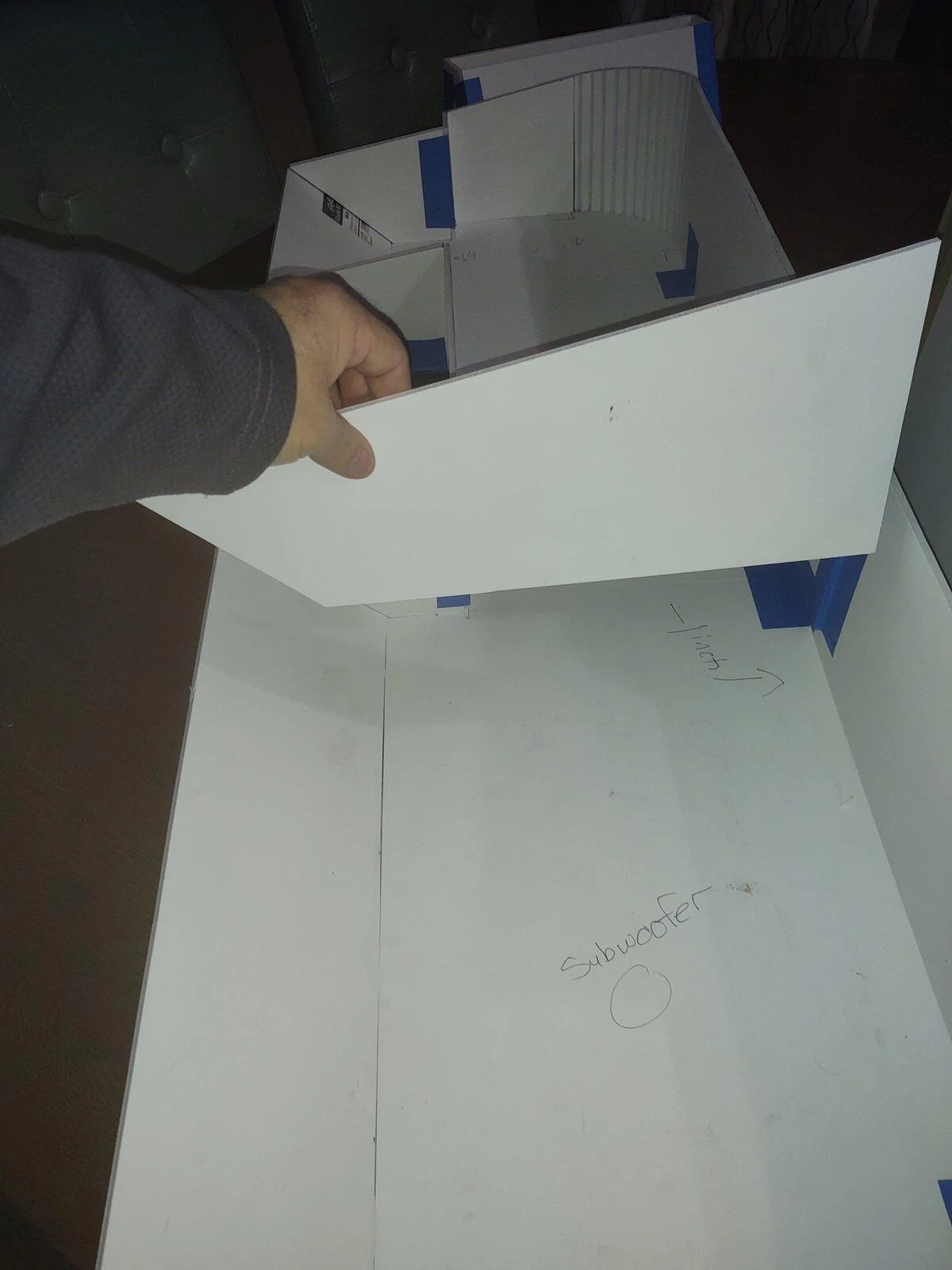

It has been a while since I have been able to pay some attention to Stereo Upgrade.

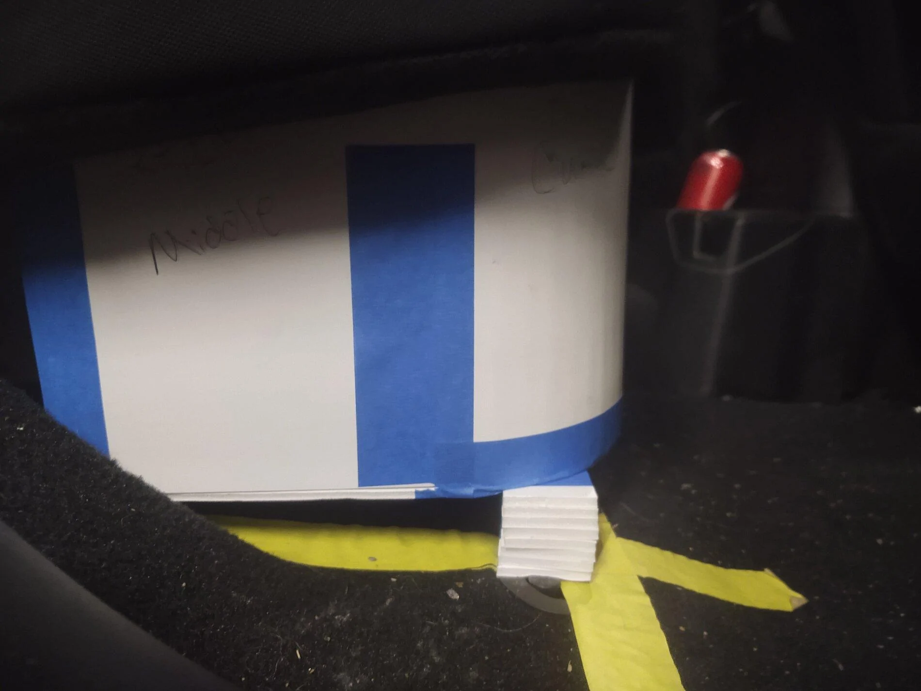

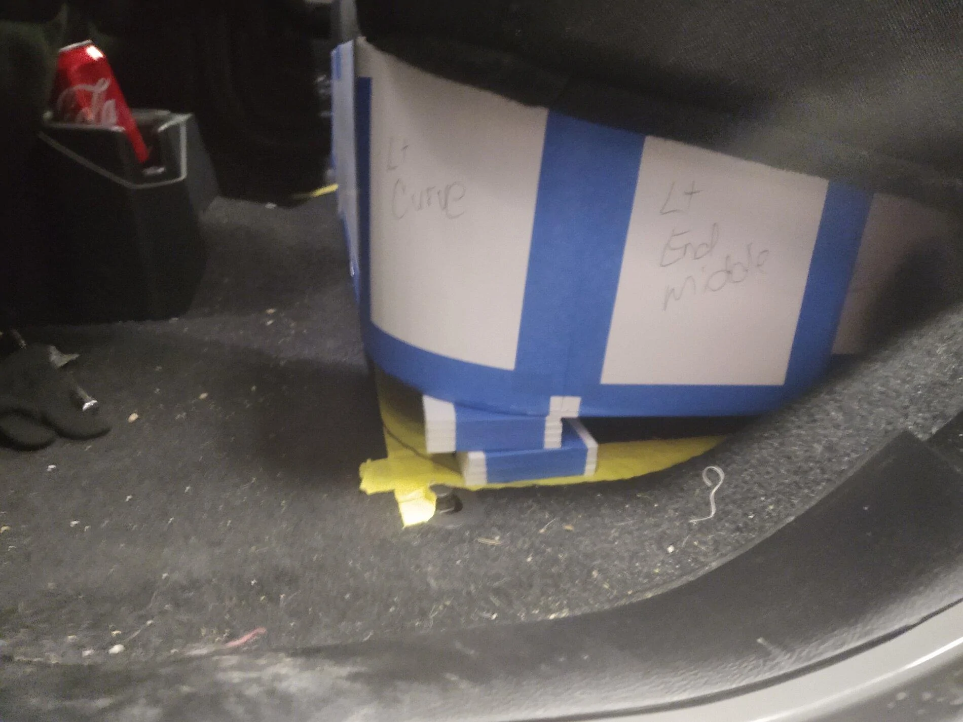

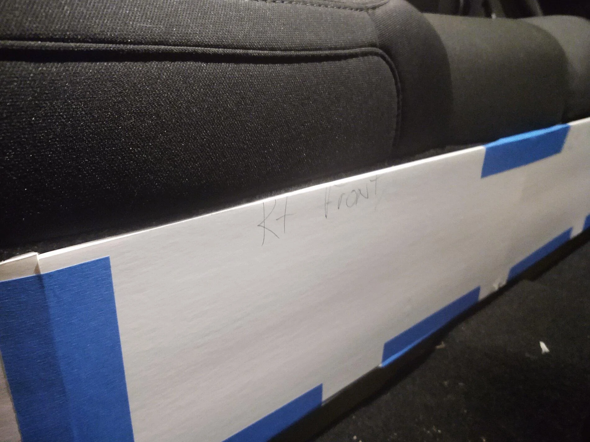

I decided to mock up my Subwoofer enclosure for my Back Seat area. I mocked it up with Foam Core Board. This will fit underneath the back seat and bolt down to the factory location where the factory storage container.

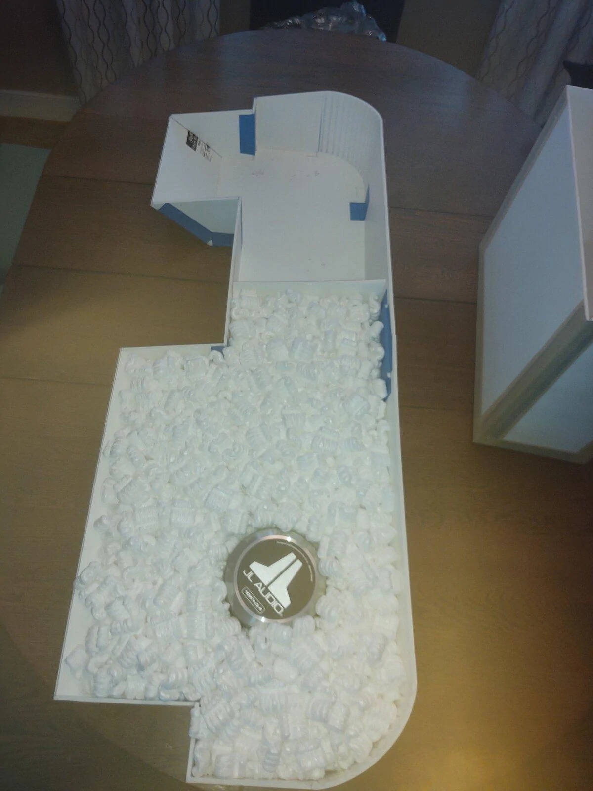

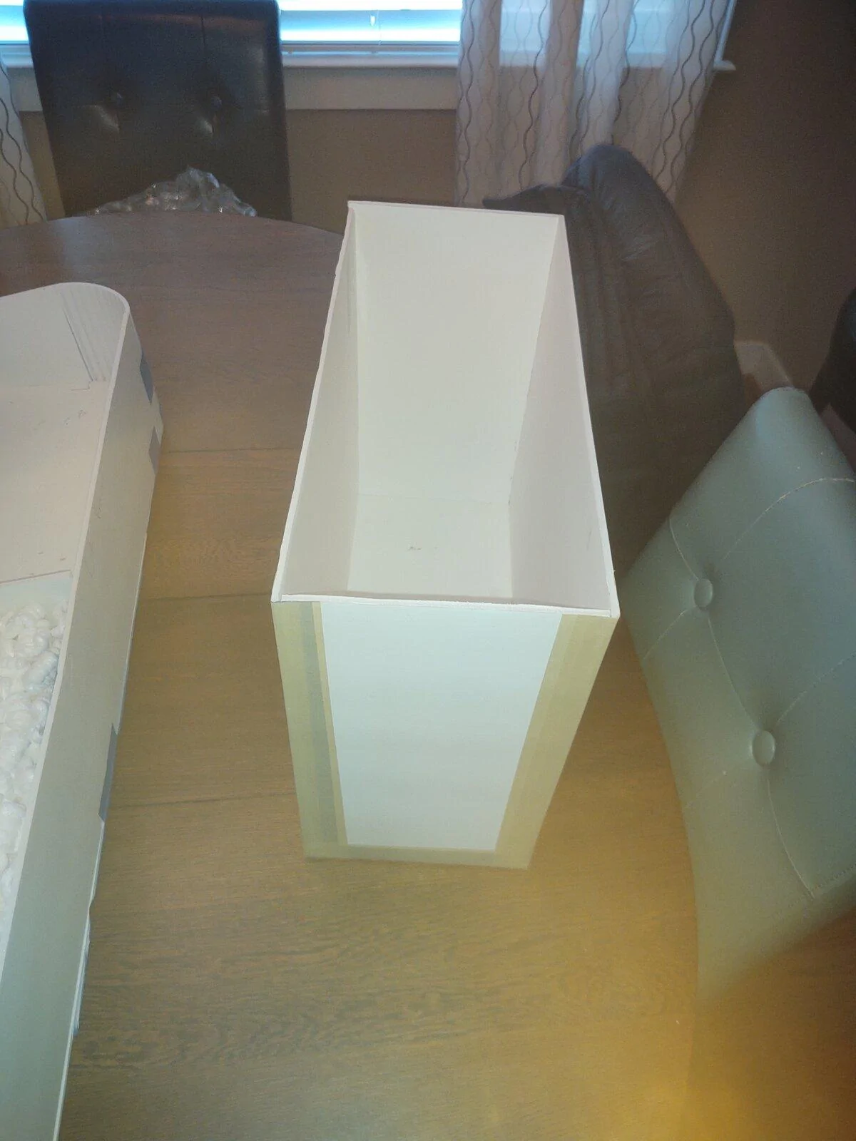

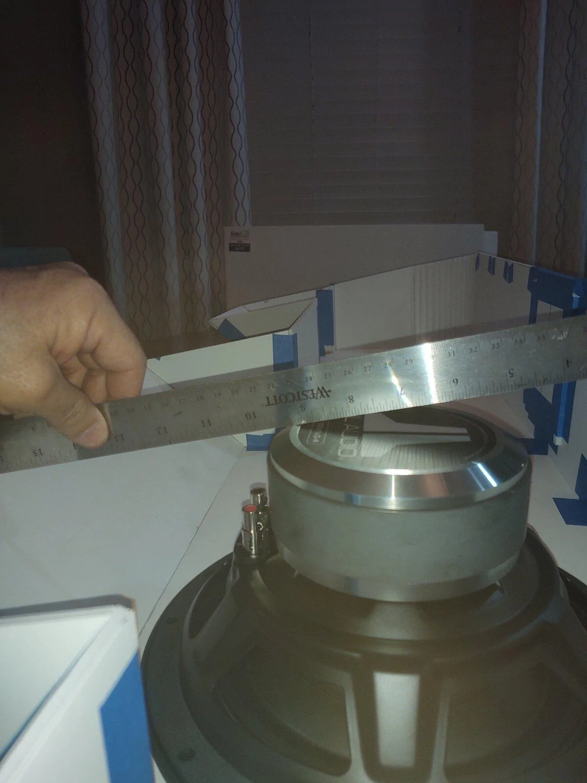

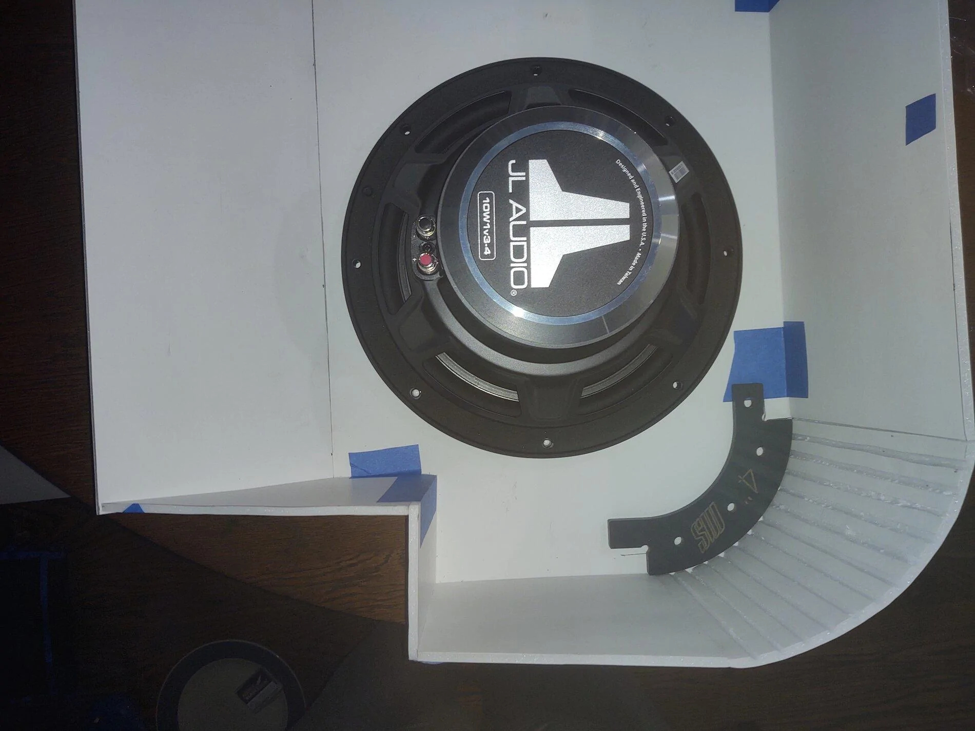

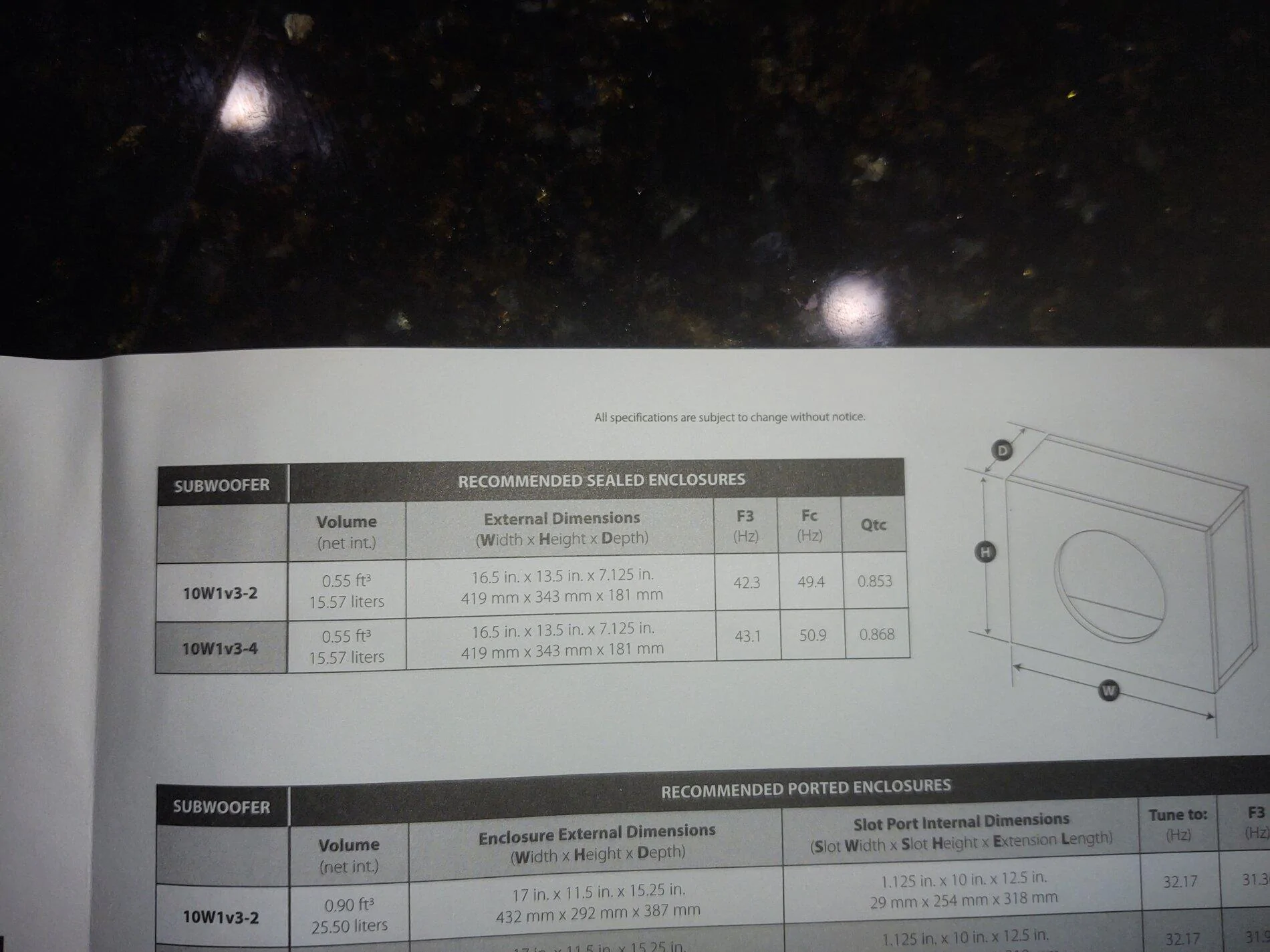

It is a JL 10W3-4. It requires .55 cubic feet of airspace inside the sealed enclosure. So, to figure out just how much air space that was required, I made a sample square box the size that JL suggests for the airspace. I then filled it with packing peanuts from the UPS Store. I then set my Subwoofer in the box along with the packing peanuts and made a piece that would separate the remainder of the box for storage. It took up a lot more space than I initially anticipate. But I now have the exact airspace designed within the box. I start my cutting of the 3/4 inch Baltic Birch Plywood and start assembling the box. I believe I will have to cut a small circular hole on the very top of the box and cover it with a larger circular plug to ensure the Subwoofer motor doesn't hit the lid and potentially hurt the subwoofer in any way.
Darkamet, if you cut the storage box in half, I am not sure you will have enough airspace for the subwoofer unless you get a lower profile subwoofer. JL does make a Lower Profile sub, but I didn't care for the sound. I wasn't willing to compromise on the sound, so I went with a conventional subwoofer. I hope this helps.
I have included some photos for reference. The plain box is just so I could measure the exact airspace required. Then there is a photo of the packing peanuts inside the box. I also have a sample wall I made to separate the airspace and the storage area. There is also a photo of the JL suggested airspace.
I hope this will help someone out in the future.
