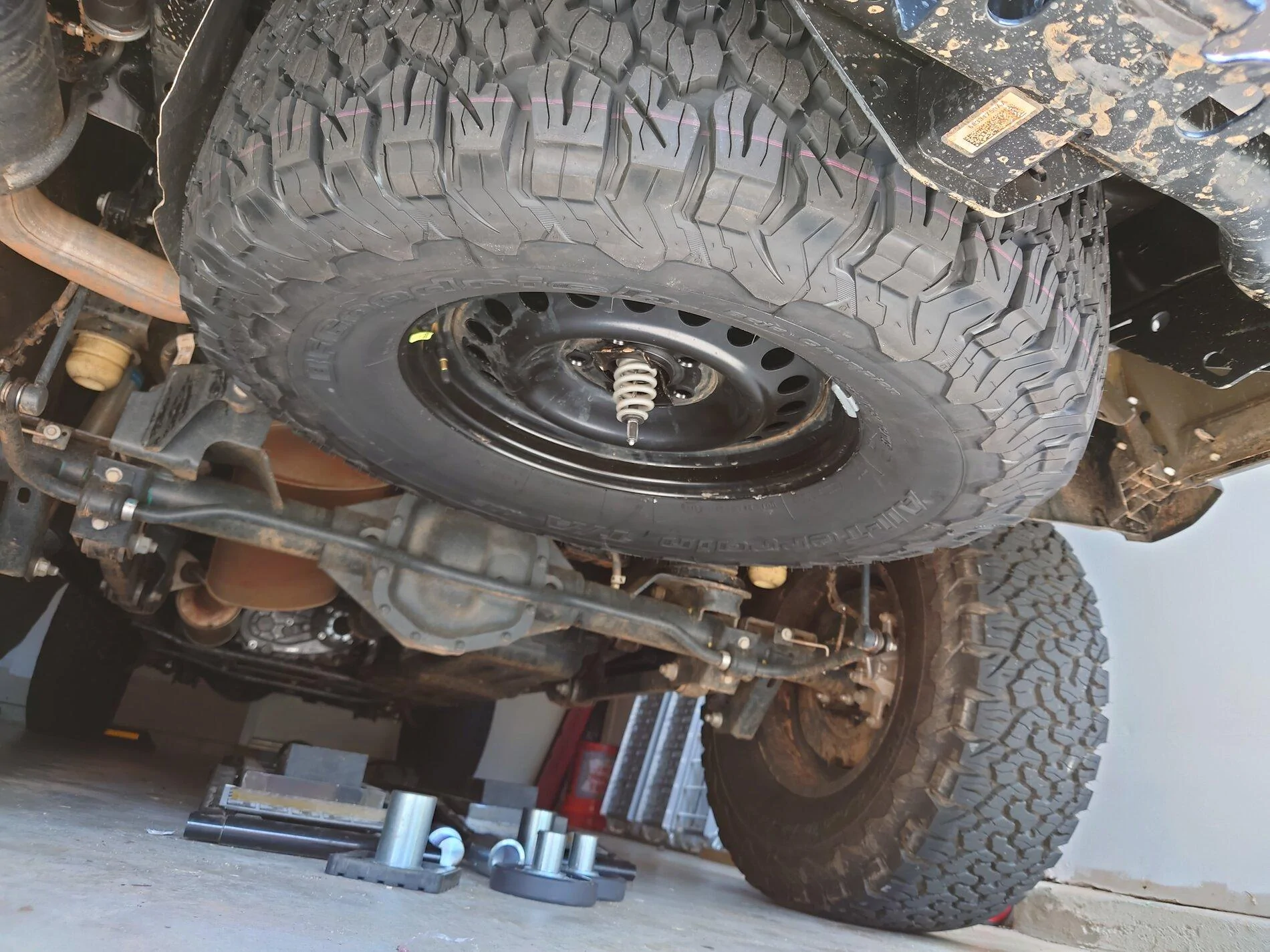

Installed the Mopar extended LCAs, they are heavier (Thicker steel) and .25" longer.
Installed the Daystar .75" rear spacer and Bilstein 5100 shocks.
I have a super handy trick for the rear springs. I used a paint pen to mark where the alignment nub goes on the spring mount and on the rubber isolator itself. I also zip ties the upper rubber isolater to the spring, so it didn't fall off or move.

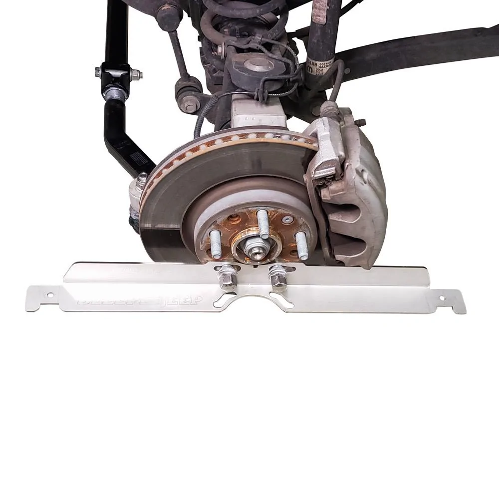

I ordered the BleepinJeep alignment plates, but for now I adjusted toe and straightened the steering wheel with good ole tape measurers and levels.

One thing... I have an extra set of rear sway bar links coming tomorrow. Even with a 1.5" lift in the front, the factory sway bar links are a no go. The sway bar is at an extreme angle. I'll install the extra rear set up front tomorrow
