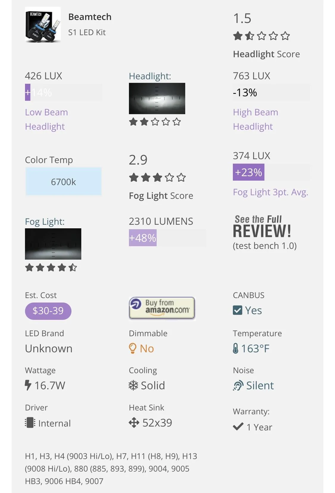

Oddly enough, the Beamtech S1 (which tends to be the most popular for Jeeps), isn’t much brighter than standard halogen (14% more Lux on low beam). In fact, on high beams, they have a lower Lux than halogens.
