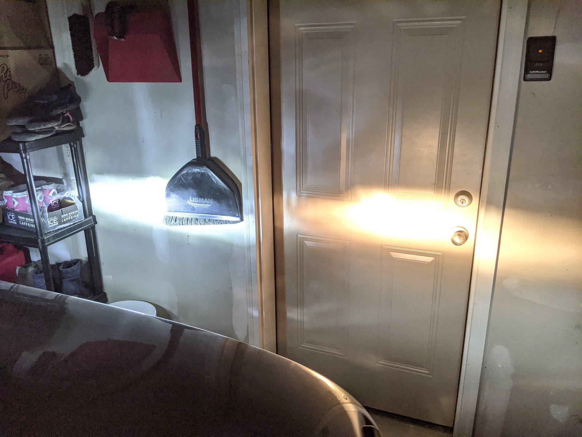

If you have a clean cutoff line with the beamtech LED bulbs and you're still getting flashed, you need to aim them down more.
An easy way to know if they're too high (besides getting flashed by everyone) is to watch where the bulbs are illuminating the backs of vehicles in front of you when in traffic while you're behind them 25' or so, you should be able to tell if you're shining your lights into their side mirrors. I pulled my JT up to several parked cars on side streets at night (creepy, I know) to test this way and made sure my cutoff line was a few inches below where they'd start to hit their side mirrors.
Keep in mind if you don't have them quite down far enough and your vehicle bounces on the road as you drive oncoming traffic is going to get a repeating flashing effect of getting the bulbs full brightness and low brightness because of the bouncing cutoff line. I'd bet you're right at this point which arguably is worse than if you had them way too high and oncoming traffic was just getting the bulbs full brightness without the bounce.
Fine tune yours a little more and I'm sure you'll be good to go, I've been running mine for 2 years now and no flashes after proper aiming.
Edit, added a pic of the bulb differences to show they have very similar patterns in the OEM housing.
Can you describe what you mean by a clean cutoff line? Would it be at the deadbolt on the door in the picture?
