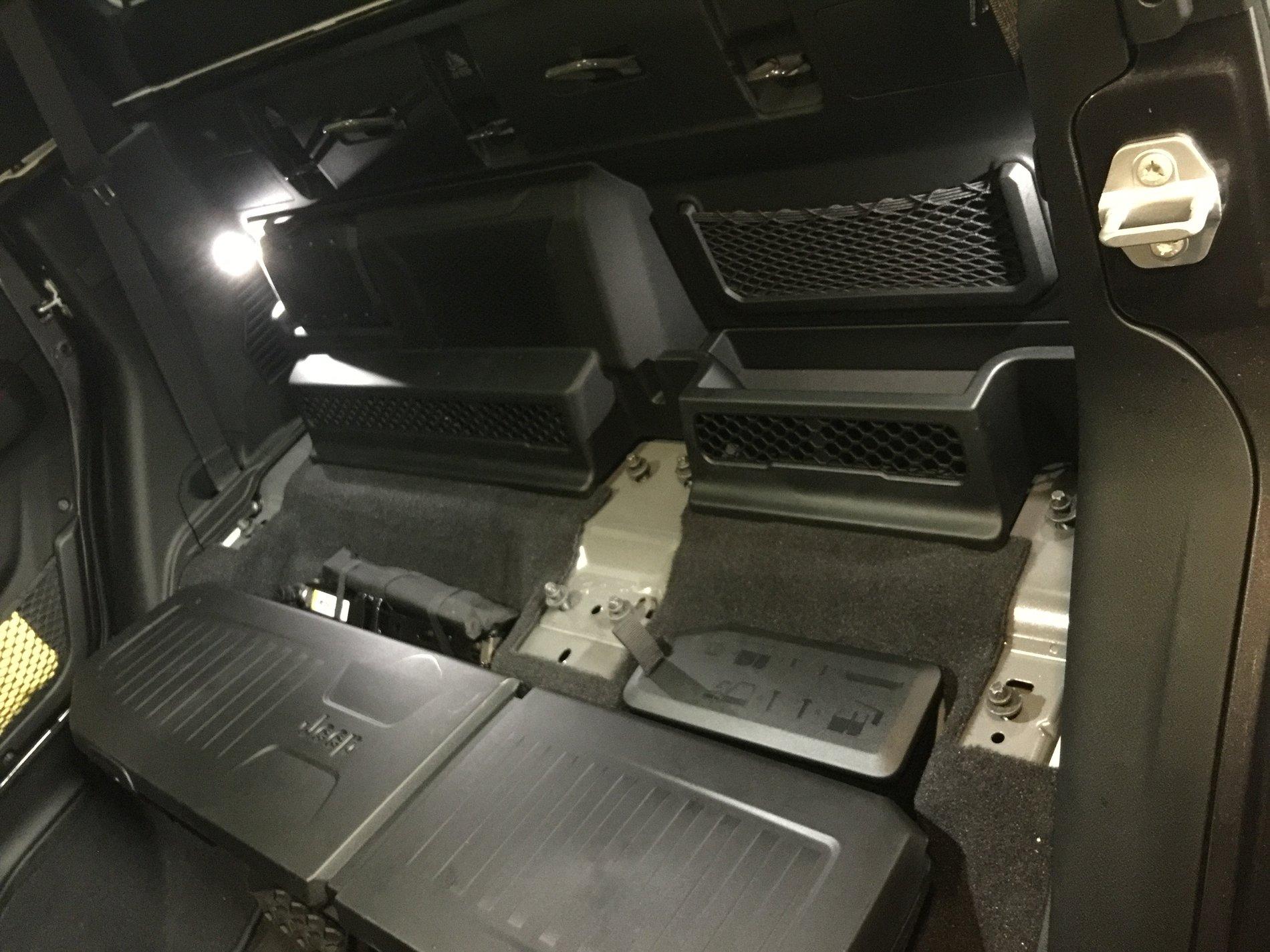

Sorry, I do not have photos of the underside of the floor. I took it out last weekend to install risers on the front passenger seat and could have taken some then...but had no reason to do so at that time. Basically, I cut a 50.5" x 27.5" piece of plywood, laid it in the back and carefully marked the locations for the 3 bolts that hold it in place and for clearance around the console and bolt box..
I unbolted the larger seat and tried to remove it. That's when I discovered the 2 bolts holding the seats together. It's much easier to remove each seat separately.
Thanks for the additional info.
Can you tell us:
* How you bolted it in place? ("the 3 bolts that hold it in place")
* Is this correct: You unbolted the entire back seat (both pieces) from the floor and then you found the 2 bolts holding the seats together and you removed them to separate the seats?
Thanks again!
