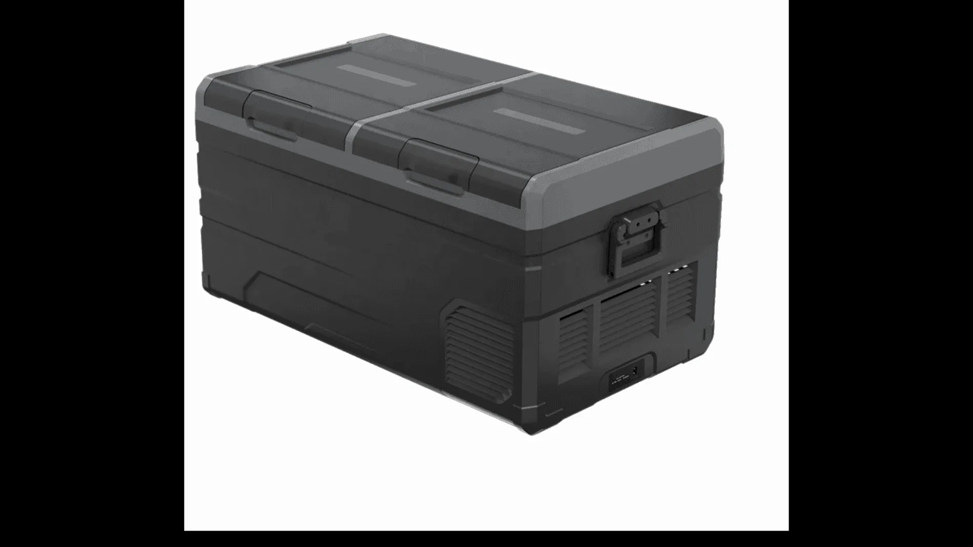

I ordered some AlpiCool coolers that I am going to test. I envision myself building power systems and coolers for campers, Jeepers and anyone else who wants a killer setup. I have two 75L dual zone coolers ordered that will be here by the end of the month.
