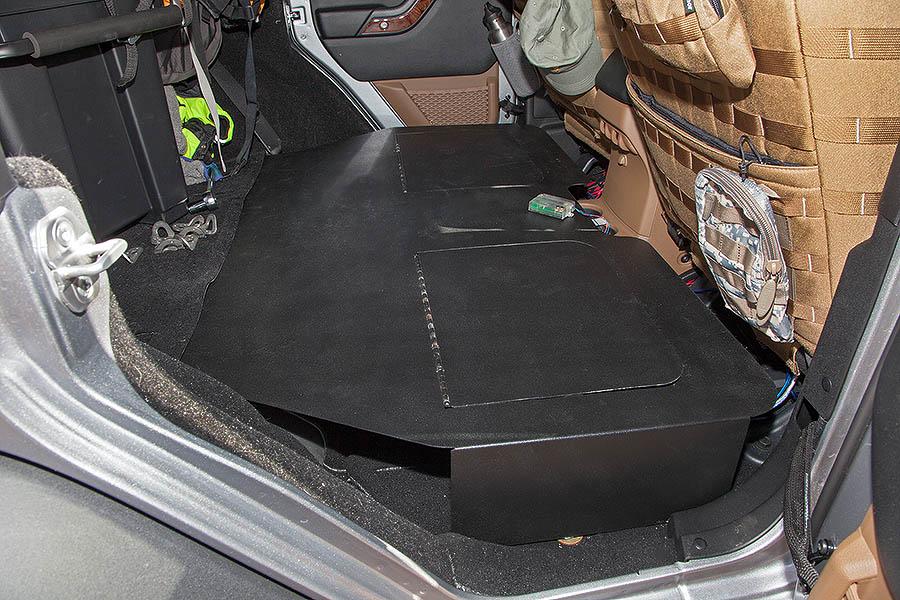

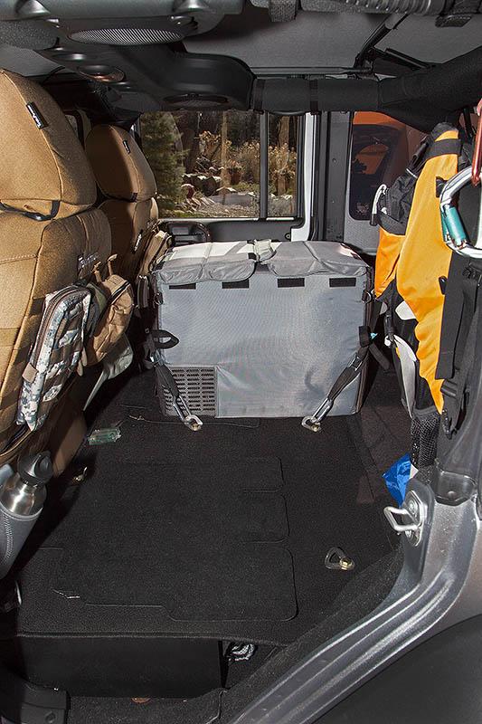

Here are a couple of photos of what I had in my '13 JKU. I will remove the rear seat and do something similar in the JT and will mount my 63-qt ARB back there.

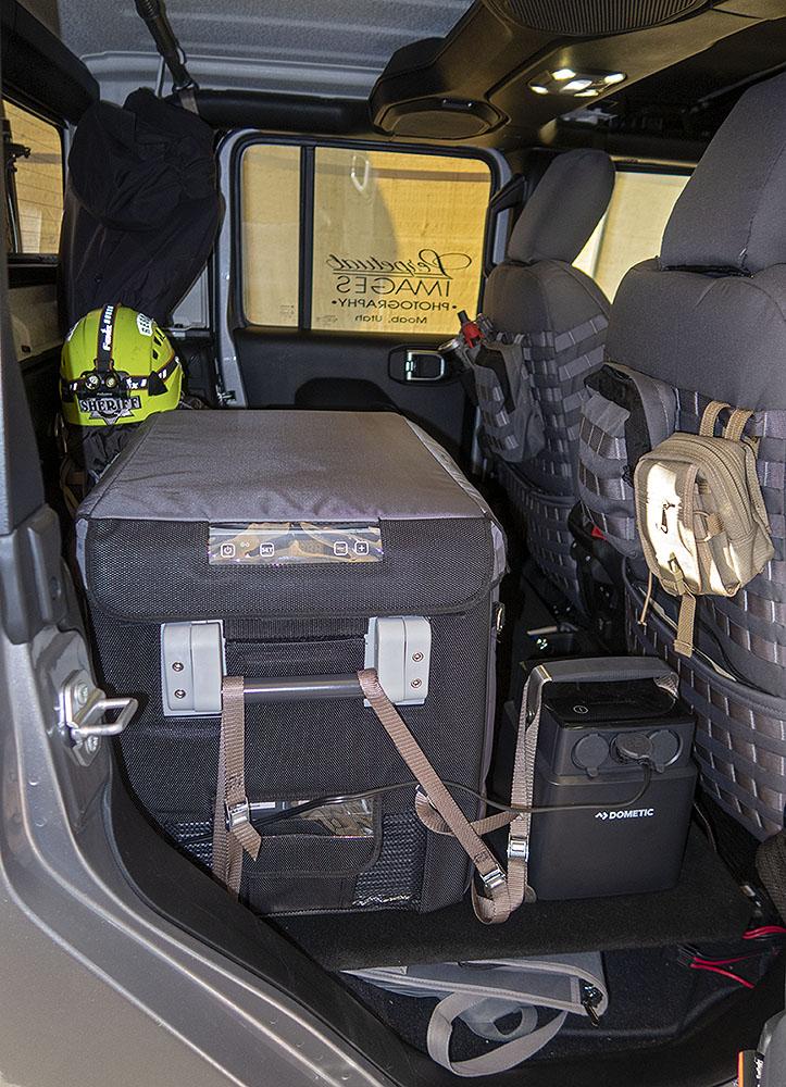

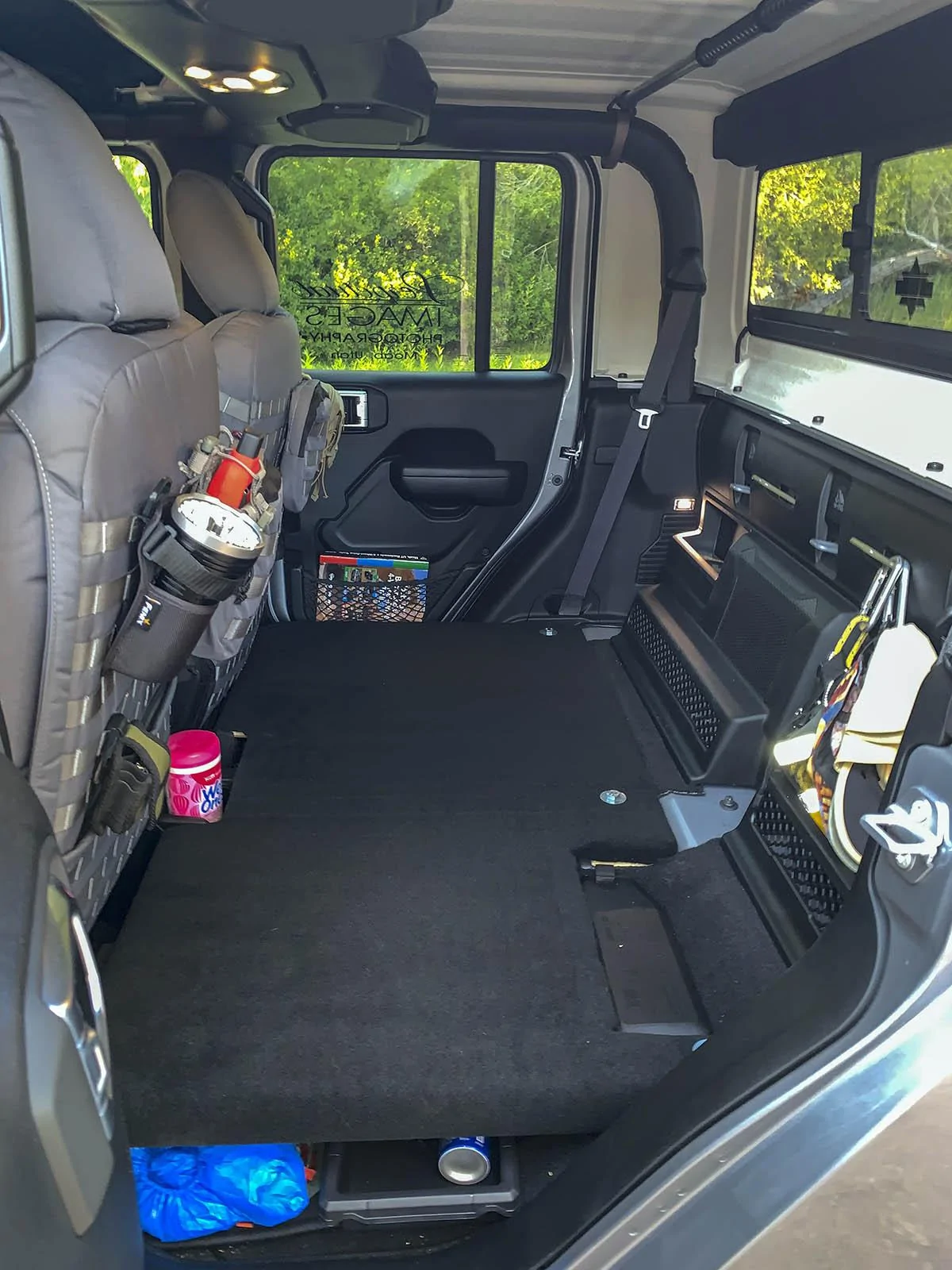

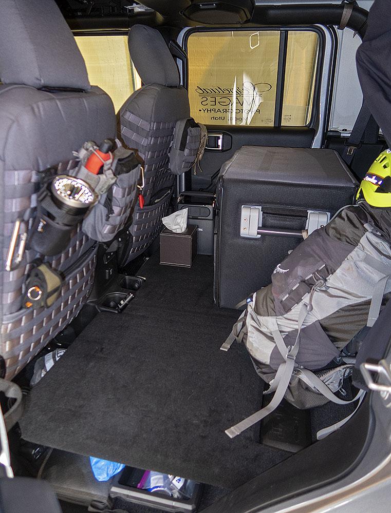

You will need an E14 torx socket. I could not find one anywhere in Moab but was able to locate a set of the female torx sockets at an auto parts store in Grand Junction.
I bought an impact wrench strictly to remove the bolts on the back seat in my JKUR, but the bolts on the JT seats were much easier to remove...no breaker bar needed. A 10-12 inch wrench should do it. There are 4 bolts for each seat (if I remember right) and 2 bolts that hold the sections together. Total weight on the seats is about 90 pounds. The seats are quick and easy to remove and I'm sure would not take long to put back in.
My 63-quart ARB took up too much space in the back, so I bought a 40 qt. Dometic. It fits perfectly. I've had several Dometic/Waeco fridges in the past and they were all great. The controls are easily accessible from the passenger door and there's plenty of room for the lid to open all the way. Plus I can control and monitor it with an app on the iPhone.
I installed a dual battery system in the JKUR to power the fridge but went a different route this time. I picked up Dometic's PLB40 Lithium power supply. It's only 17 pounds and easily powers the 40 qt. for a full day (maybe 2) in temperatures well over 100 degrees...MUCH longer when ambient temps are lower. It can be re-charged via solar or from the vehicle's DC power port when running, or from AC.

Great post - great help, thanks! :like:
Thanks for the info on the Torx E14 socket and the bolts and weight estimate.
I assume the pics are all of your JT Gladiator. It looks like you built a platform and covered it with black auto fabric.
Any info on the platform you can provide to us?
Thanks again!

The floor is half-inch plywood with some 1x4 along the bottom of the back edge to bring it up to the right level and along the driver's side edge for bracing. There are three 2x4 legs attached with metal L-brackets...two near the front corners and one near the center. This is the carpet I used, but when I click on the link now, it only shows a tan color available: https://www.amazon.com/gp/product/B071SG24KY/ref=ppx_yo_dt_b_asin_title_o05_s00?ie=UTF8&psc=1
I removed the locking storage box that came with the Rubicon but left the bolt storage box and cut the plywood to retain access to it.
This is super helpful! I'm planning on doing the same thing.
If you have more info and/or pics on the bolt locations and what the bottom of your platform looks like please do post them.
In your previous post you said, "There are 4 bolts for each seat (if I remember right) and 2 bolts that hold the sections together."
Did you take the seat out in one piece and then unbolt them or did you unbolt the seats from the floor and then unbolt the seats from each other and take them out one at a time or ???

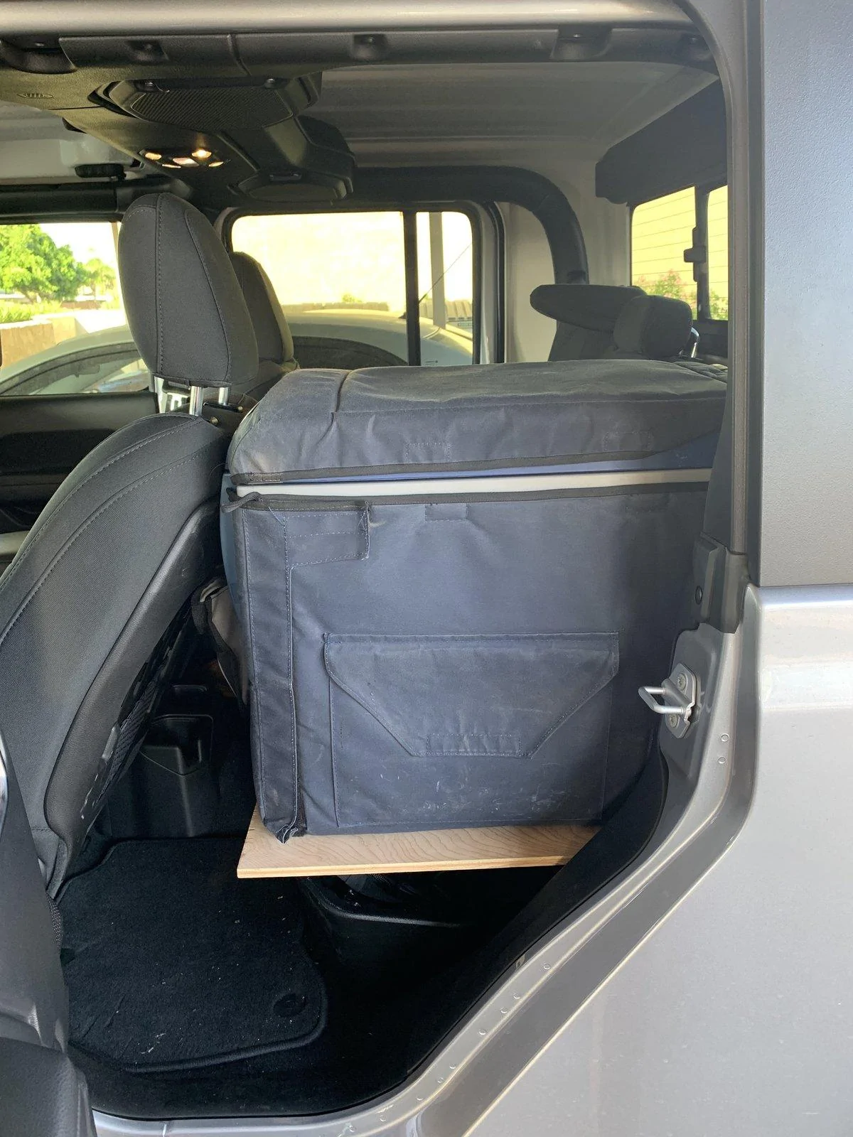

expfinn
Ryan
Sep 15, 2019
60
54
Arizona
Jeep Gladiator ARB Fridge Install 8052BCC4-C928-4B51-9555-FF13E0B06BF6
Here’s where I’m trying out my fridge. Just removed the 40 portion of the 60/40 split seat.

Sorry, I do not have photos of the underside of the floor. I took it out last weekend to install risers on the front passenger seat and could have taken some then...but had no reason to do so at that time. Basically, I cut a 50.5" x 27.5" piece of plywood, laid it in the back and carefully marked the locations for the 3 bolts that hold it in place and for clearance around the console and bolt box..
I unbolted the larger seat and tried to remove it. That's when I discovered the 2 bolts holding the seats together. It's much easier to remove each seat separately.
