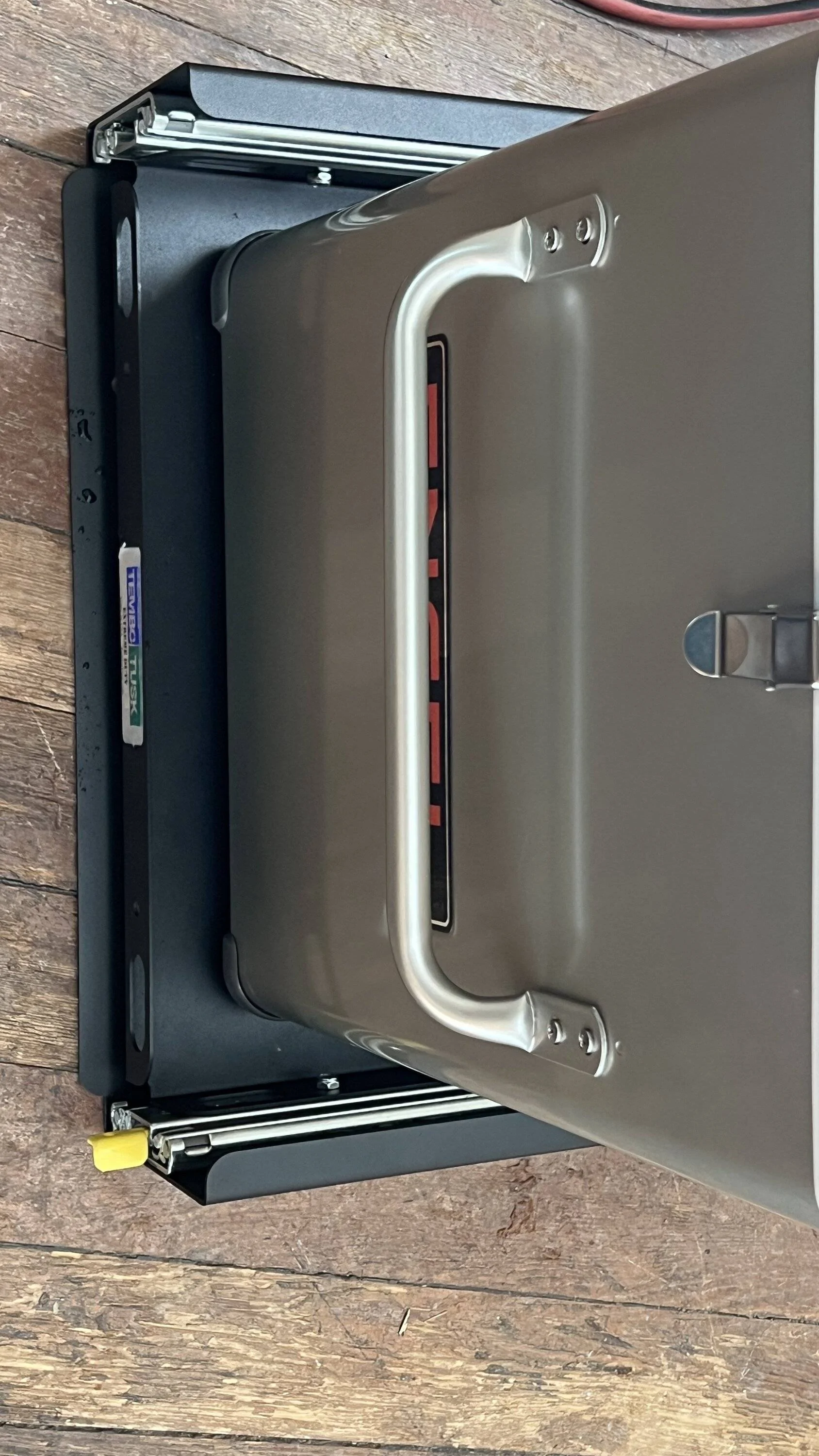

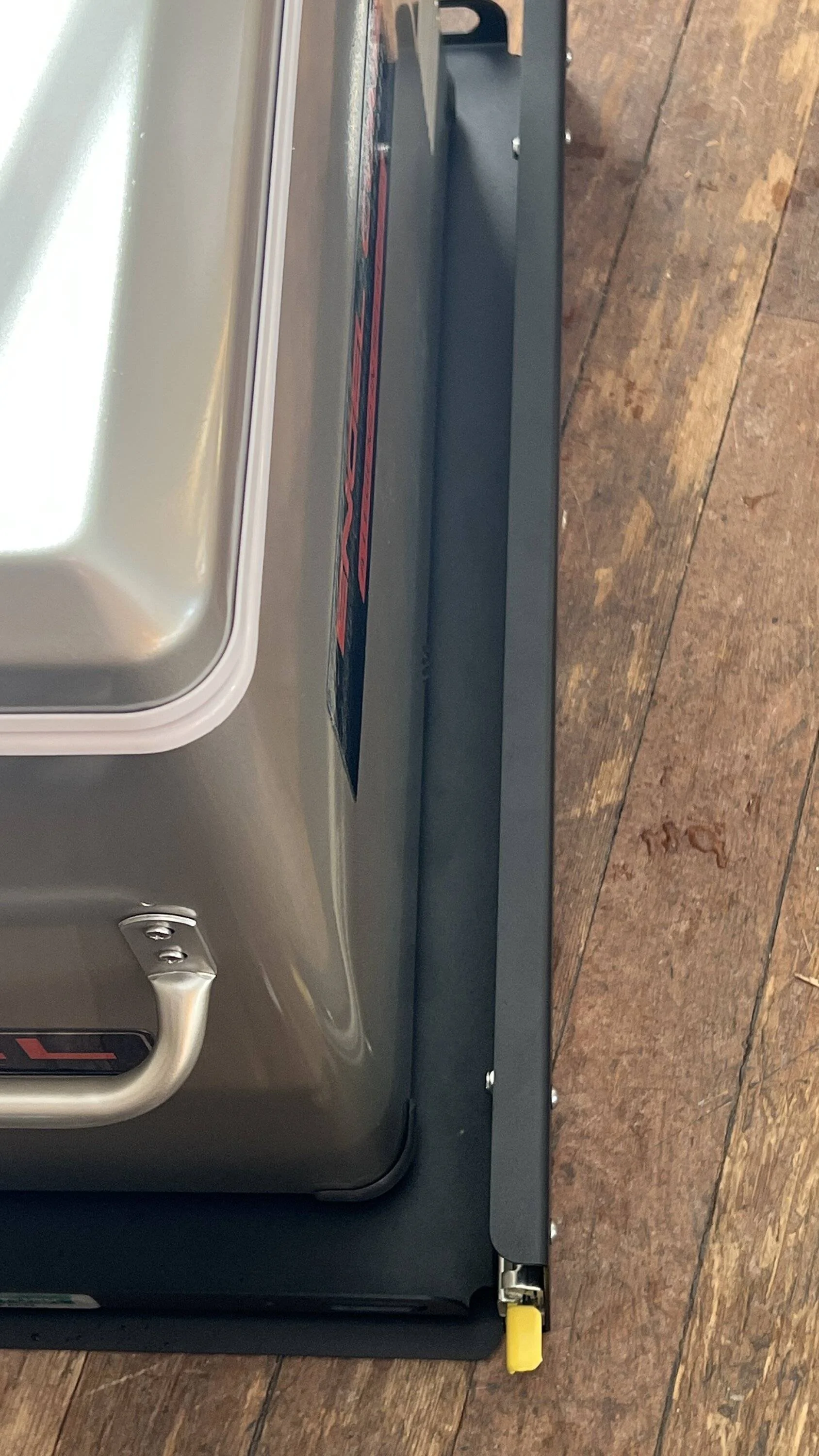

So I weighed the slide last night and wow its heavier than expected. 38 pounds…. I should have asked for soecs before buying since its pretty expensive. I also dont really like how much wider it is than the fridge and the sides come up a good few inches.
So looking back at Engle site today I saw this
https://8020.net/addoncomponents/gravityrollercomponents.html
It got me thinking about other threads and discussions and so I also found this
https://www.accuride.com/en-us/prod...de-with-latch-disconnect-lock-in-and-lock-out
Thinking about extruded aluminum, I explored this site
https://8020.net/catalog/category/view/id/4/?dimensions=5563
It has me wondering if i can make my own slide using that engle slide lock posted above. It would also eliminate the need for tie down straps

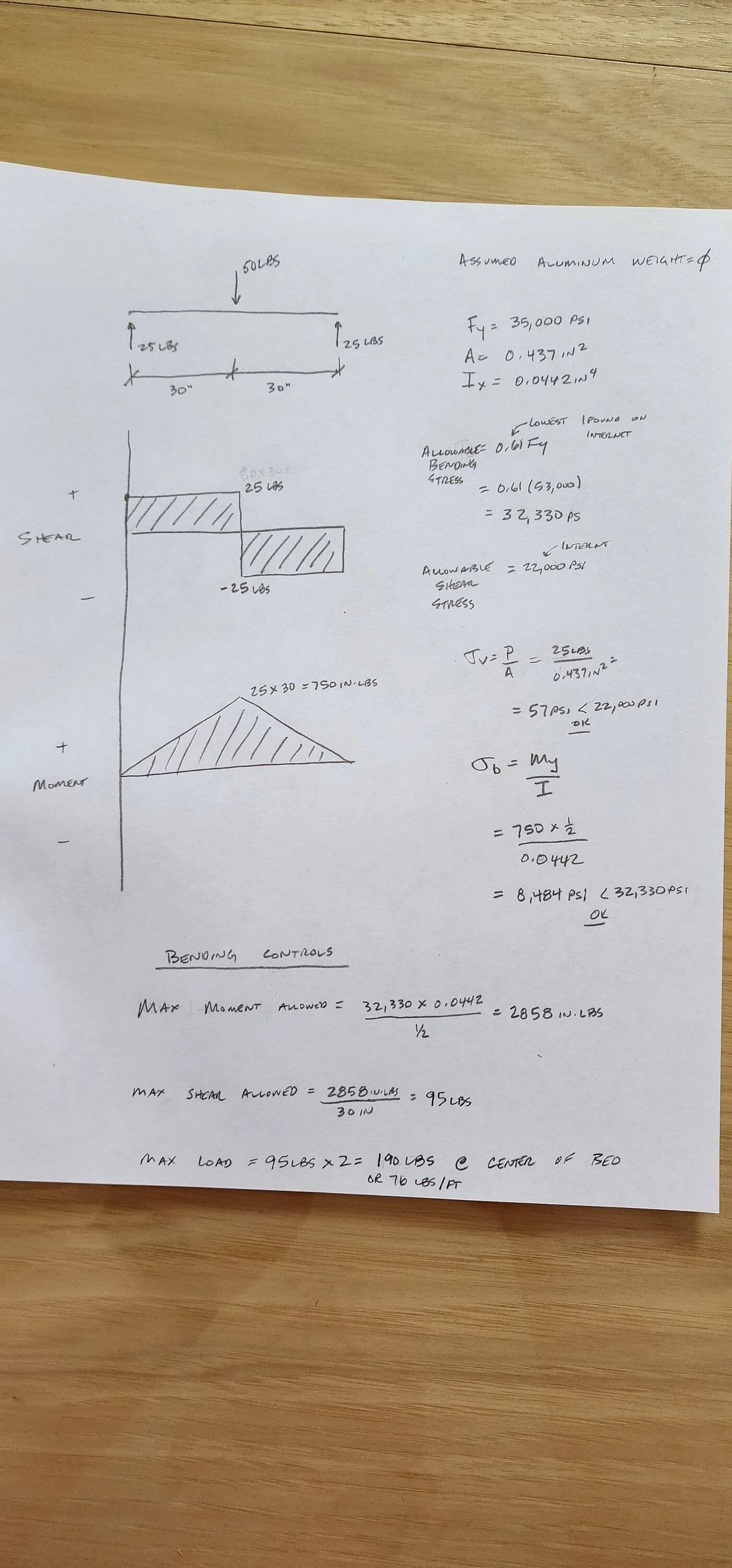

not sure how the extruded alum would hold up. My guess is fine based on culdbbi previous discussion in another thread
So I used a 50lb load in the center of the bed, neglected the weight of the aluminum and the 1010 is totally fine. I then worked backwards to find the maximum point load, or load per foot. Turns out this would be about 190lbs in the center or about 76lbs/ft.
Now that is assuming just one piece of extruded aluminum, and you are going to have to build a frame to set the tubs/containers on, so you should be plenty good.
As for affixing they have a ton of clips and such. I would look outside of Amazon, like https://8020.net/ and see what they have first, then you can see if you can find them on Amazon.
