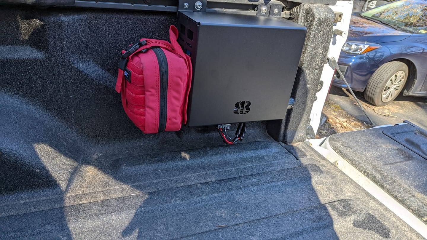

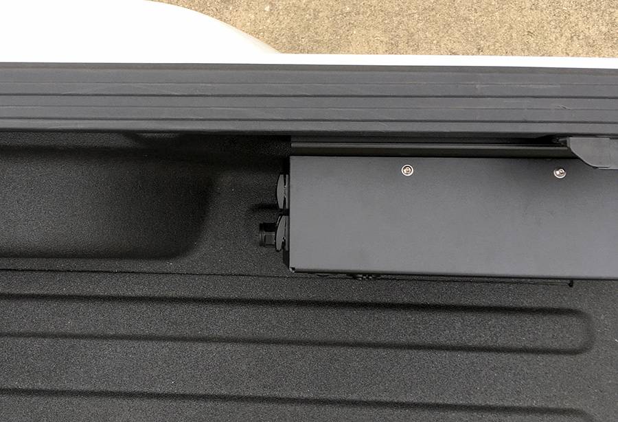

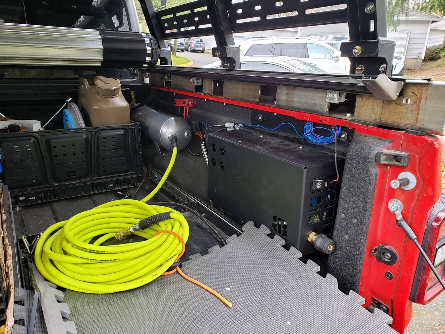

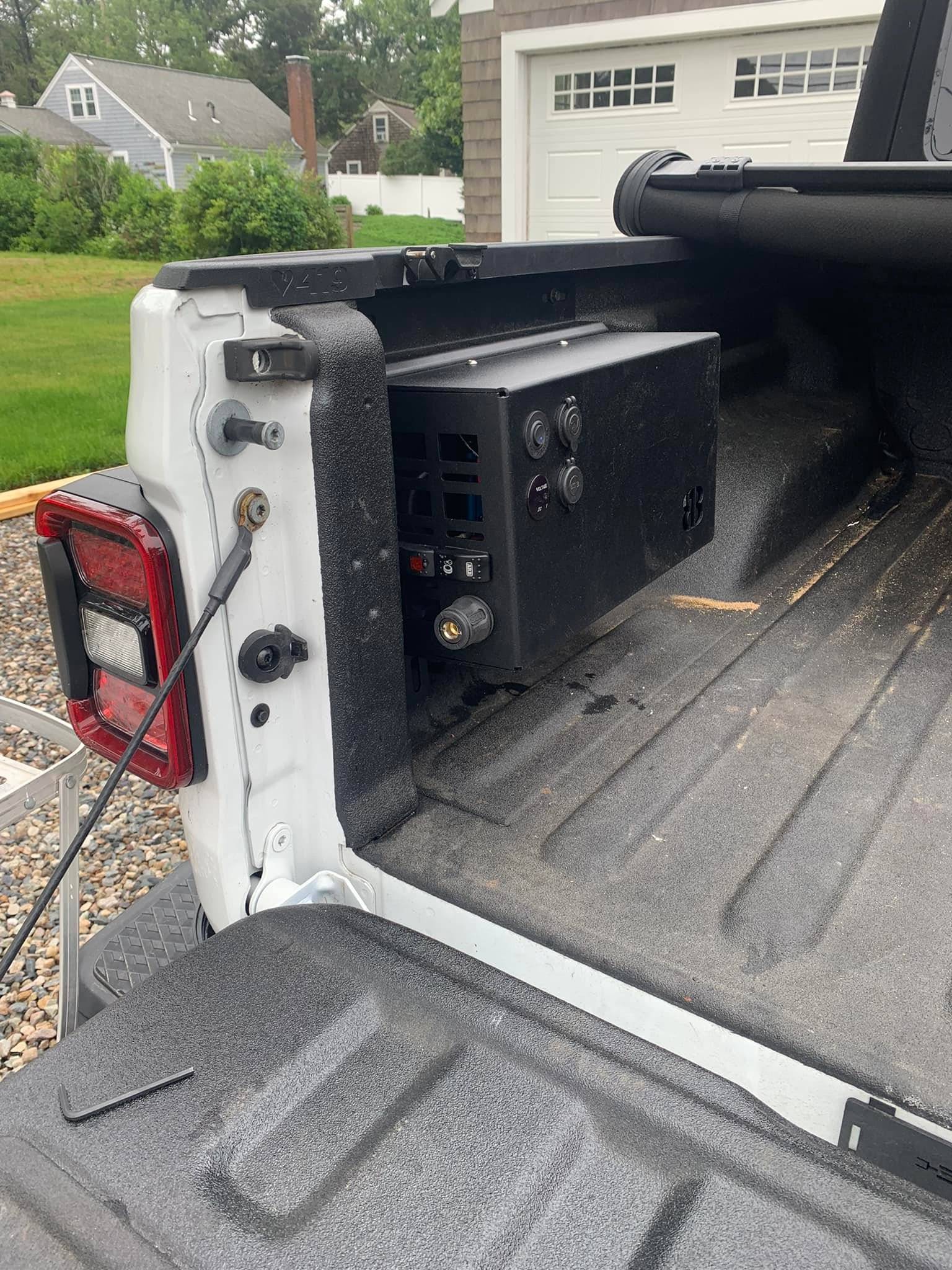

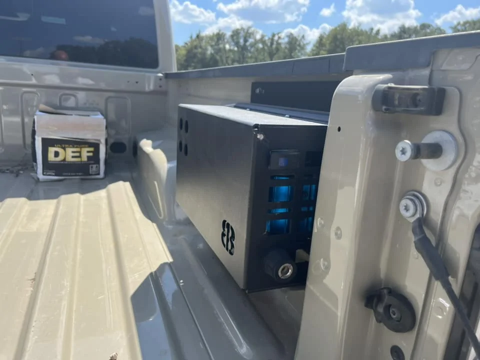

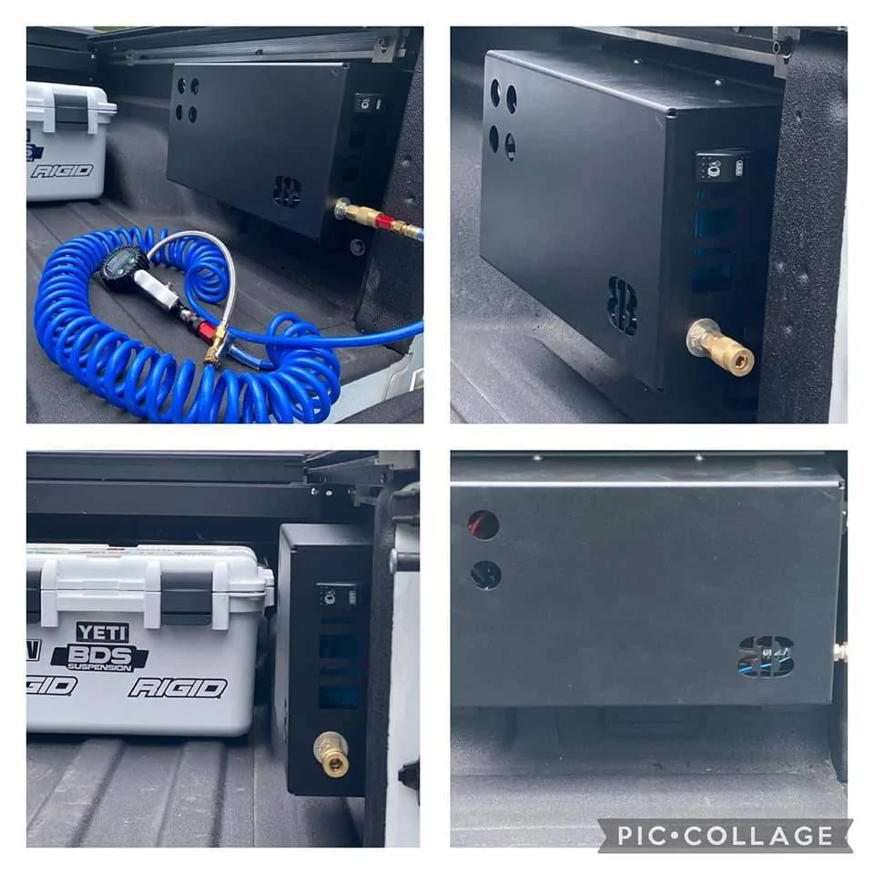

Here are a few customer photos of the Bedside Compressor Enclosures to help show how they sit. They sit inside the wheel well distance. Let me know if there are any other questions you have.

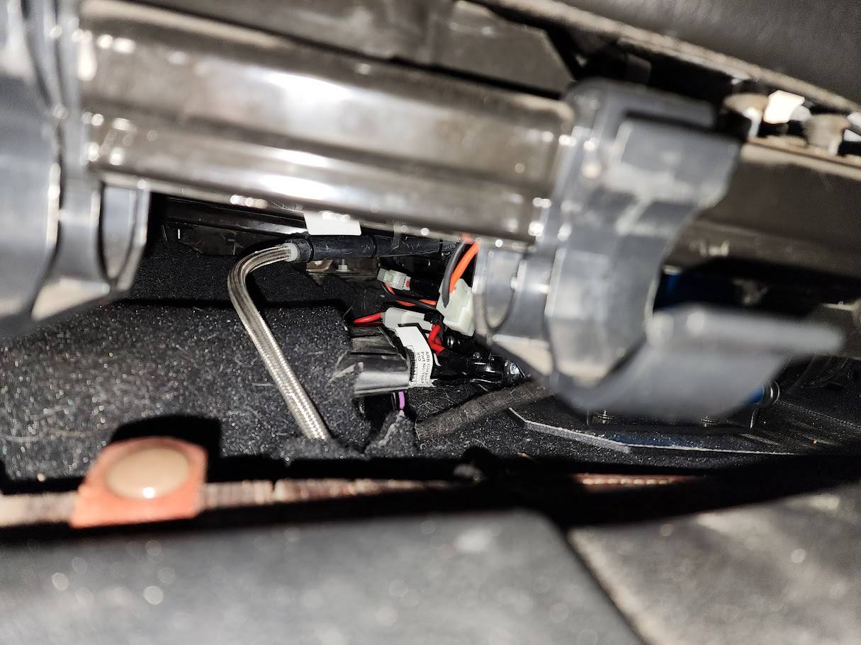

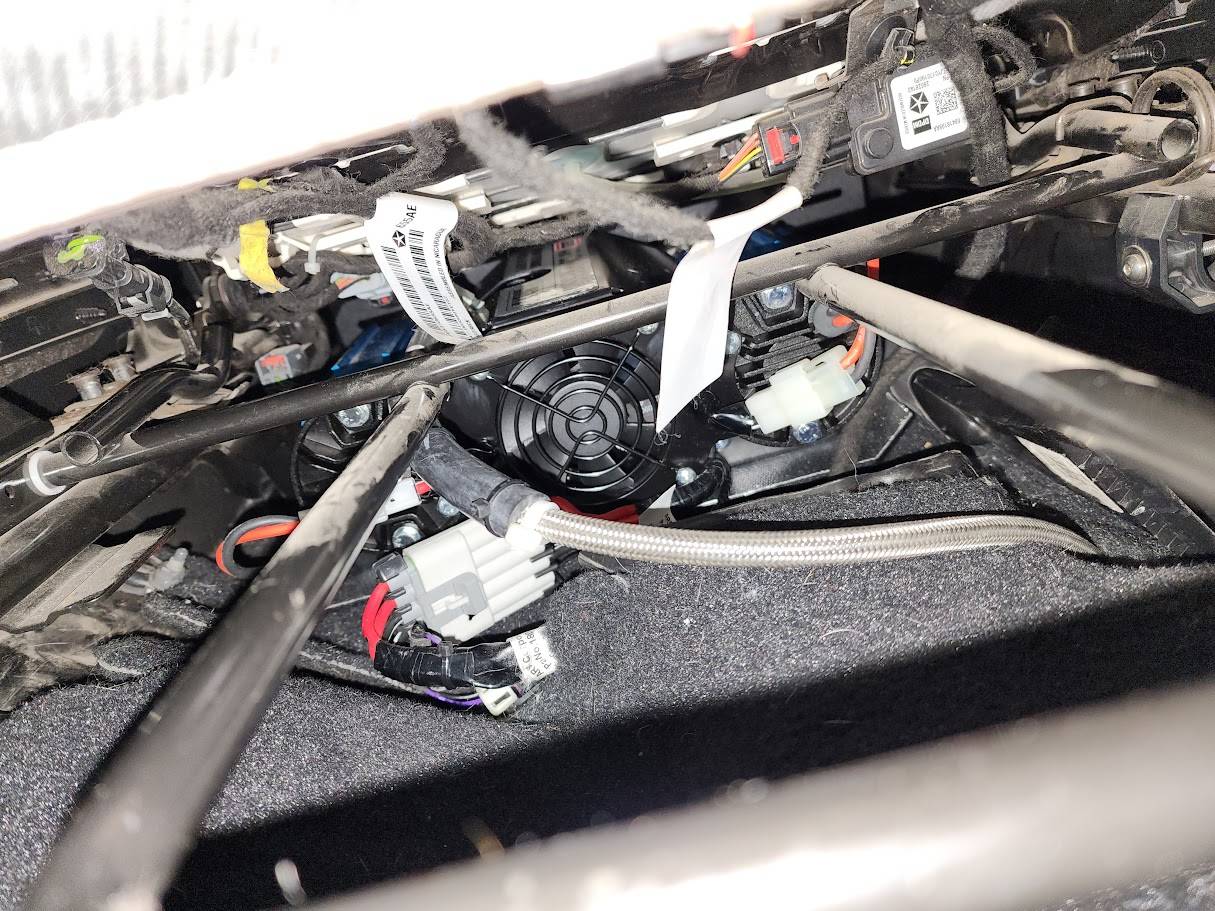

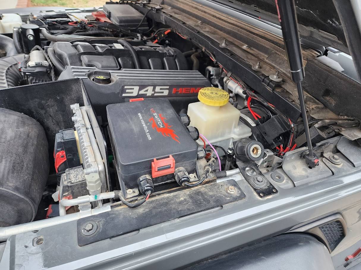

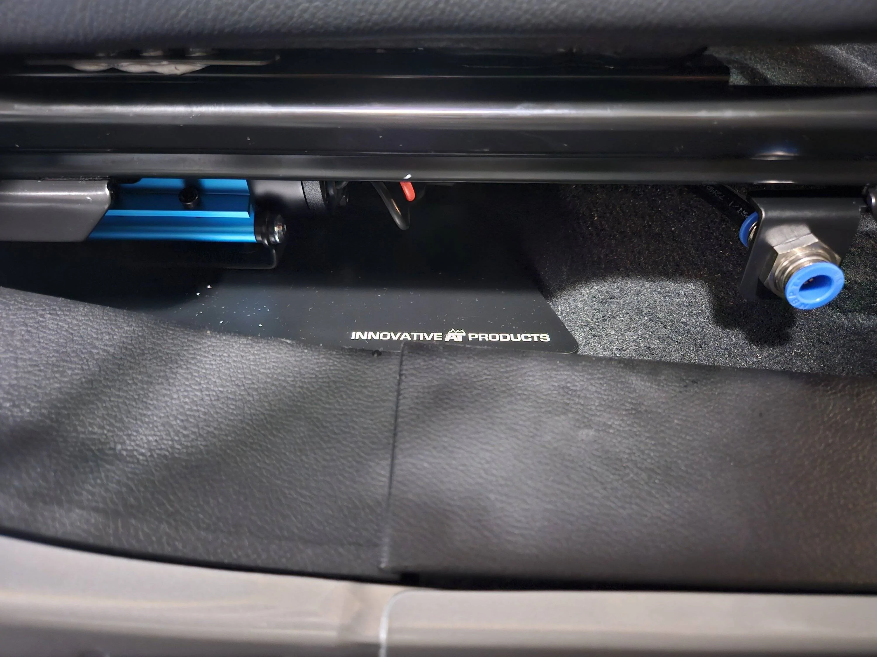

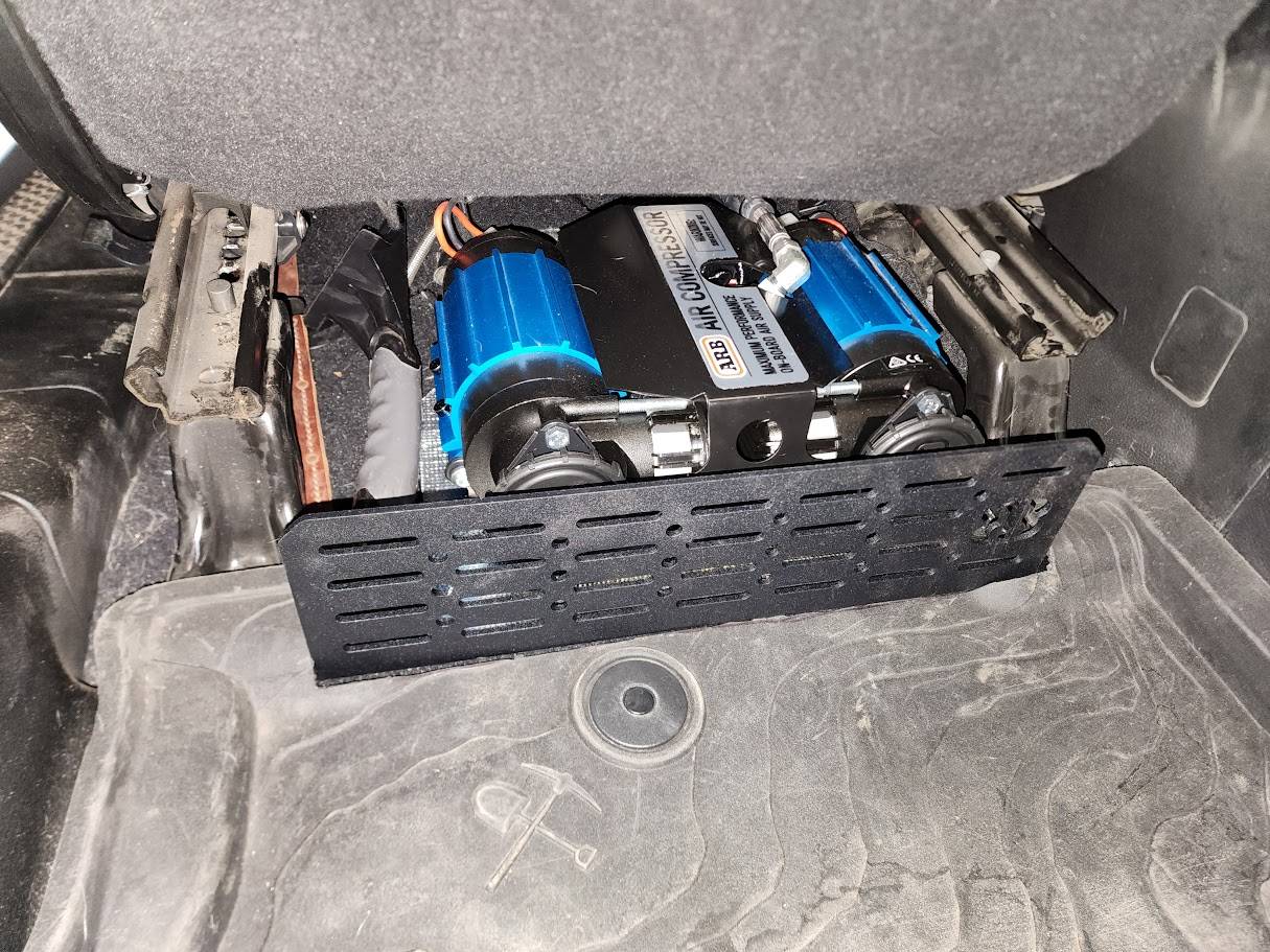

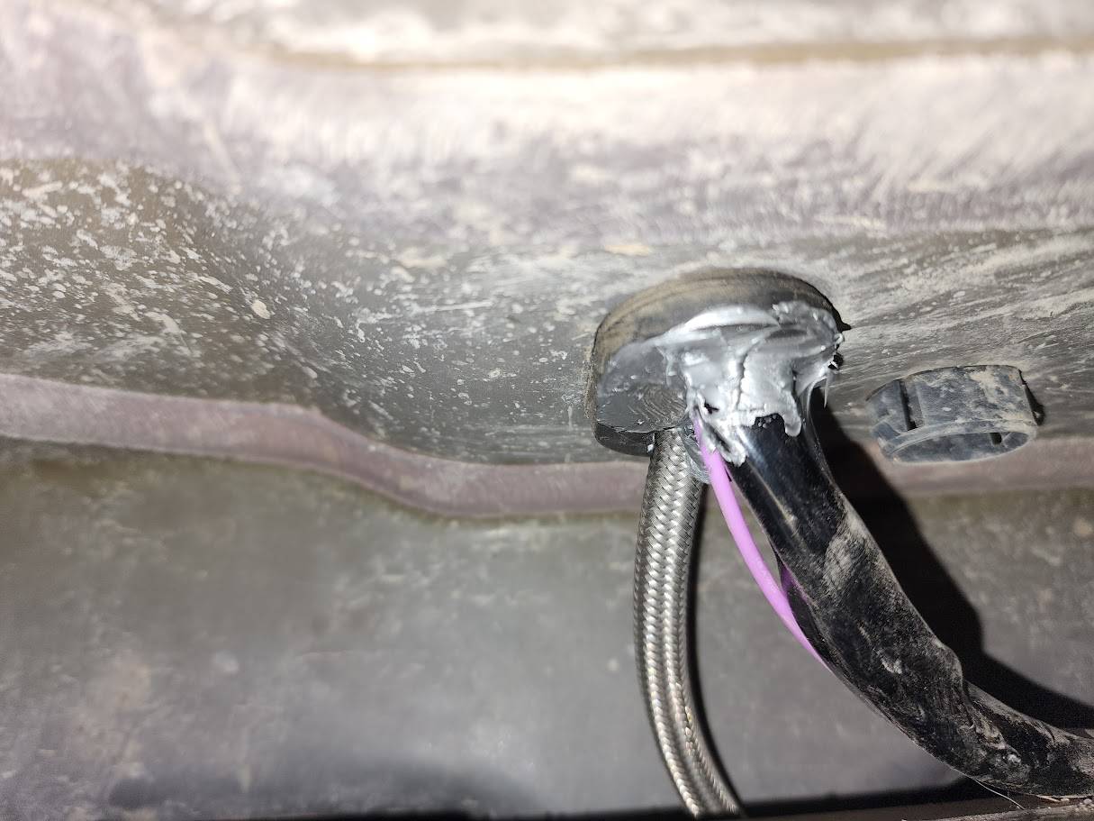

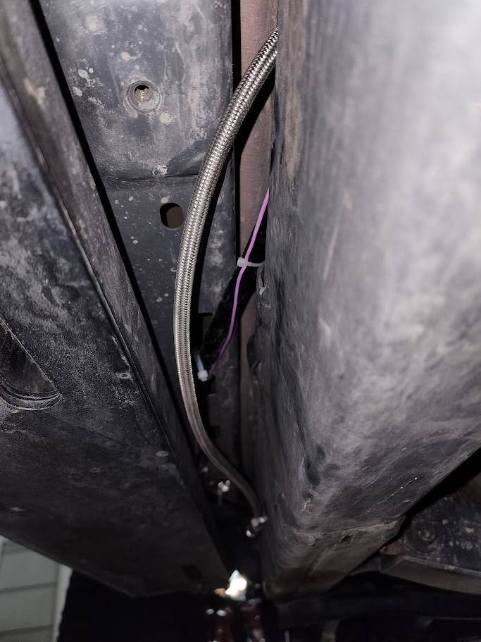

Thought I would follow up with how the install turned out. I had a day in the 50's so I did what I could on installing the ARB twin. Got it mounted and plumbed. Got dark and cold so I was not able to get it hooked up to the battery as I need to extend the power and ground wires to reach the battery.
As mentioned I went with the 813 Designs under seat mount, mounted under the Drivers seat. Ran the electrical and air hose through the floor drain plug to the engine compartment. Got the switch wire connected to my VOSwitch and will finish up the wiring when I have a warmer day.
