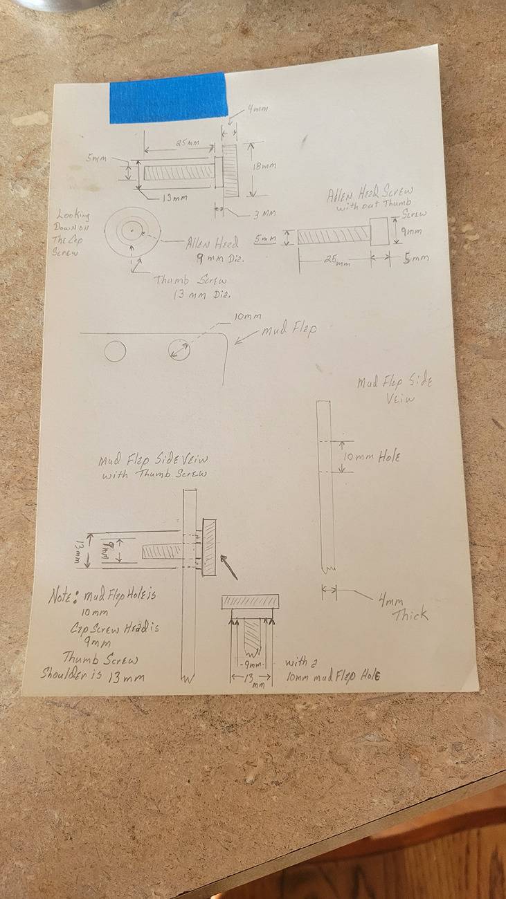

After loosing 2 thumb screws that attach the mud flaps I contacted Rokbloks on their web sight to see if I could get some replacements and after waiting a week and a half with no response I went and did a search on the interweb and found the parts needed.
Any one that owns these needs to read this because there is a slight flaw in their design and this will happen to you.
I found that the 10mm hole in the mud flaps and the thumb screws used to mount them that the base of the thumb screw is 13mm and the allen head screw that is inserted in the thumb screw is 9mm. So when you tighten the thumb screws you are putting pressure on the thumb screw head itself. You have a 10mm mud flap hole with a thickness of 4mm with a 9mm thickness allen head and the thumb screw base not going into that 10mm hole because it's 13mm wide so when you tighten the thumb screw you are putting all the pressure on the thumb screw head allowing the allen screw to be pulled out of the thumb screw head.
Also if you are thinking to just drill the mud flaps out to have the thumb screw fit the hole you will still have a gap because the hole in the mud flaps is 4mm and the thumb screw shoulder is 3mm so there will still be pressure on the thumb screw so it could still be pulling the thumb screw head away from the allen screw itself . I have gotten new thumb screws on the web that are a direct replacement and also I had found 5mm Id x 10mm W x 5mm thick to fit in the mud flaps to take up the spacing.
Thumb screws: https://www.ebay.com/itm/3342968560...OsxVUutR-m&var=&widget_ver=artemis&media=COPY
Spacers : https://www.ebay.com/itm/3563725593...OsxVUutR-m&var=&widget_ver=artemis&media=COPY
Jeep Gladiator Attention RokBloks owners 20250204_124555
