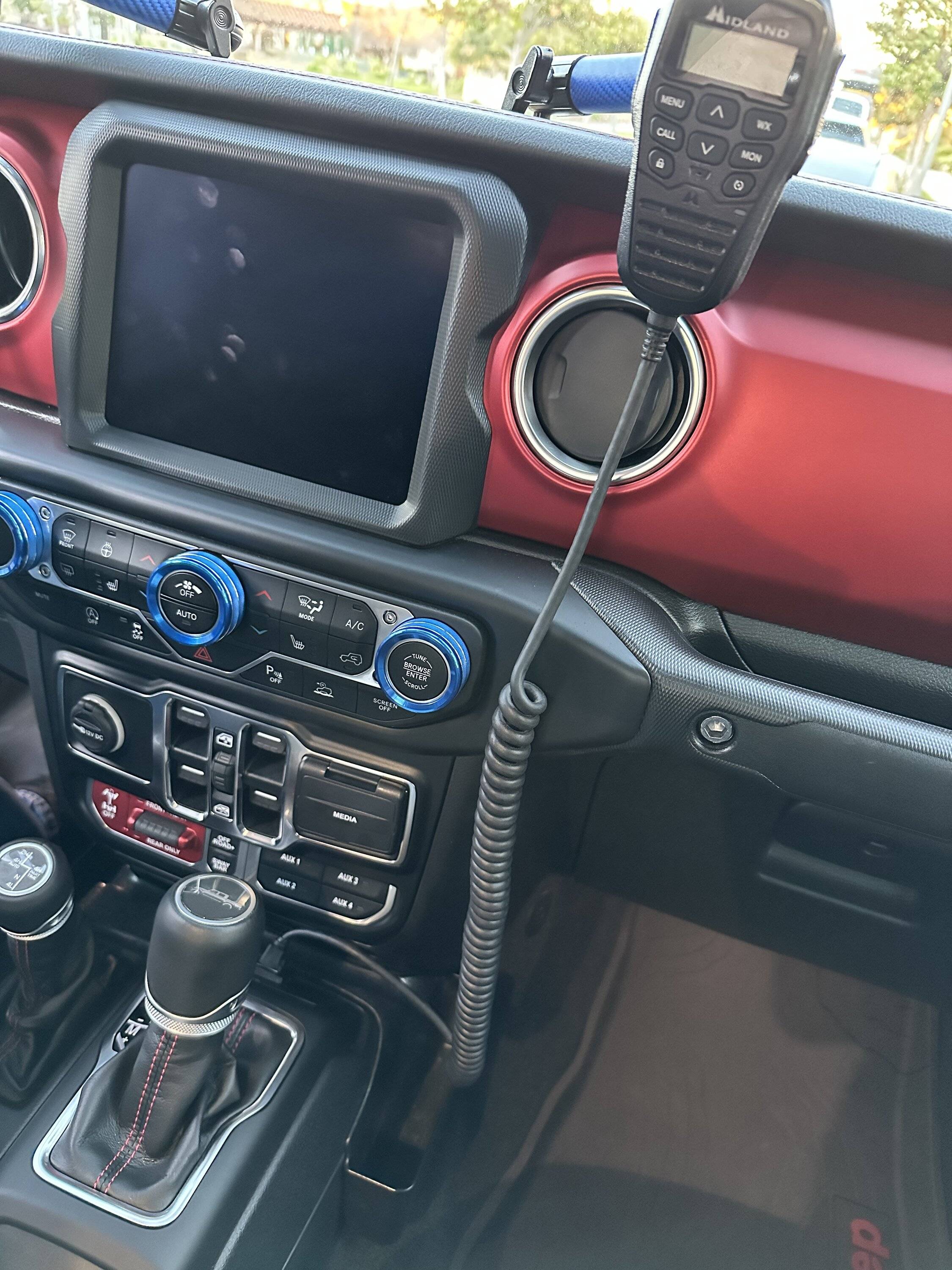

This is probably the best idea I've seen yet. Least invasive, and for me, the closest connection to where the mic is hung. I think this will be the way I go instead. Thanks for this.
Glad i can help! Because that panel can be removed it also makes cutting accurately MUCH easier.

Oh like this, I'd rather not drill into the side of my center console, this is perfect, just a small plate to replace if need be.
Does Bulletpoint have a mic hanger? I might have to grab one of those too
Yeah they do. Works great for the Motorola GMRS radio mics. Apparently the same standard as CB.
https://www.bulletpointmountingsolu...-holder-with-20mm-ball?variant=40630810509427
The ability to easily and (presumably) cheaply replace the panel was another big reason I chose the location. It’s also very easy to get the cable to from under the dash.

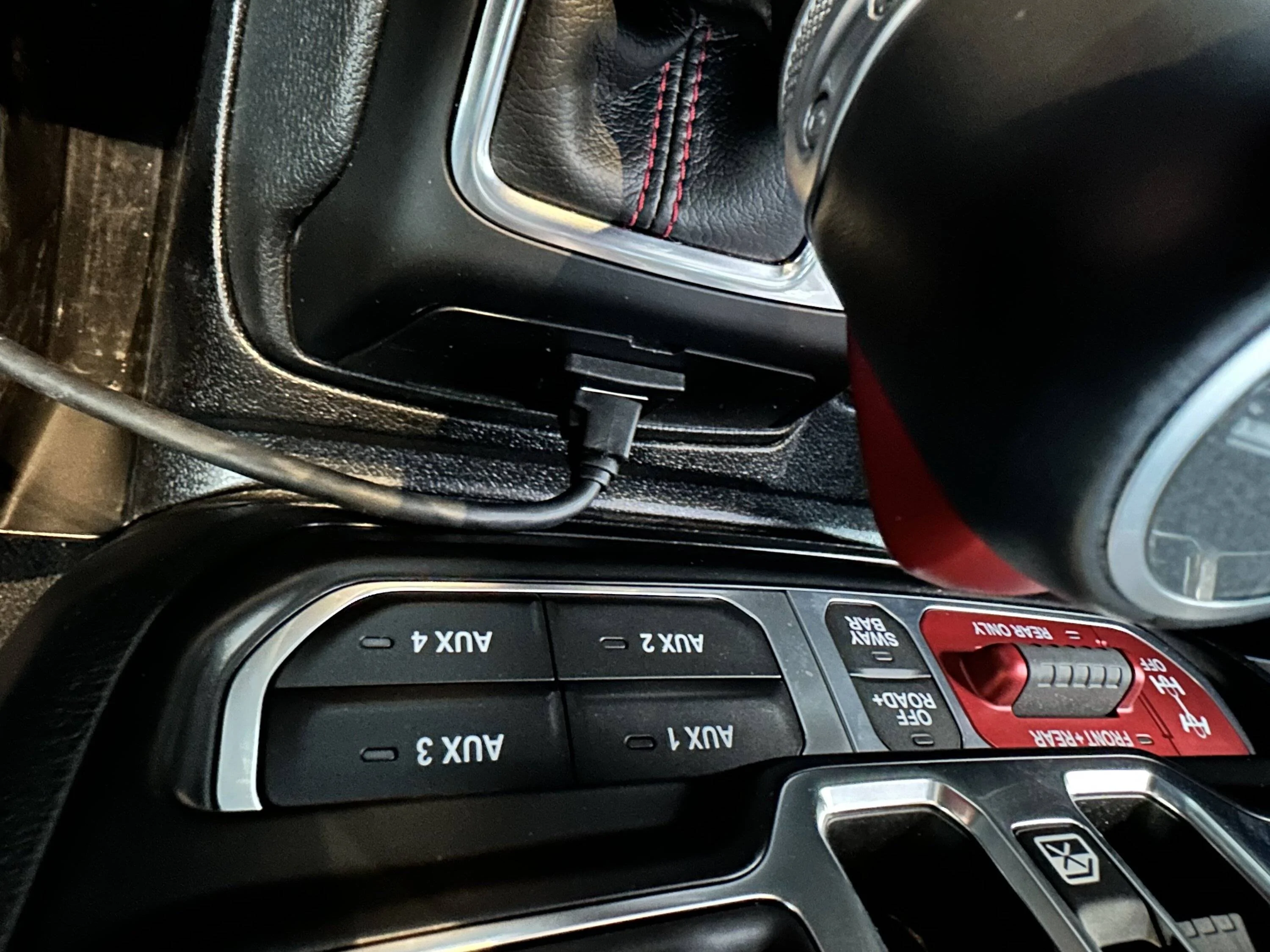

I can take others if there’s a view you want to see. It looks a little like the cable is bent hard over but it isn’t.
That is perfect! Been trying to find a spot like the others have and just did not want to put a hole in the dash or side of the console.
Mind mentioning what plug you used?
Happy to, nothing special:
CERRXIAN RJ45 Male to Female LAN... https://www.amazon.com/dp/B01MRZAN3R?ref=ppx_pop_mob_ap_share
For reference I have my main unit mounted above my steering column and this flush mount cable reaches behind/under the IP to the main unit with room to spare.
Awesome, thank you. That actually is the one I have had in my list for sometime now.
I have my main unit under the passenger seat. So should reach easily

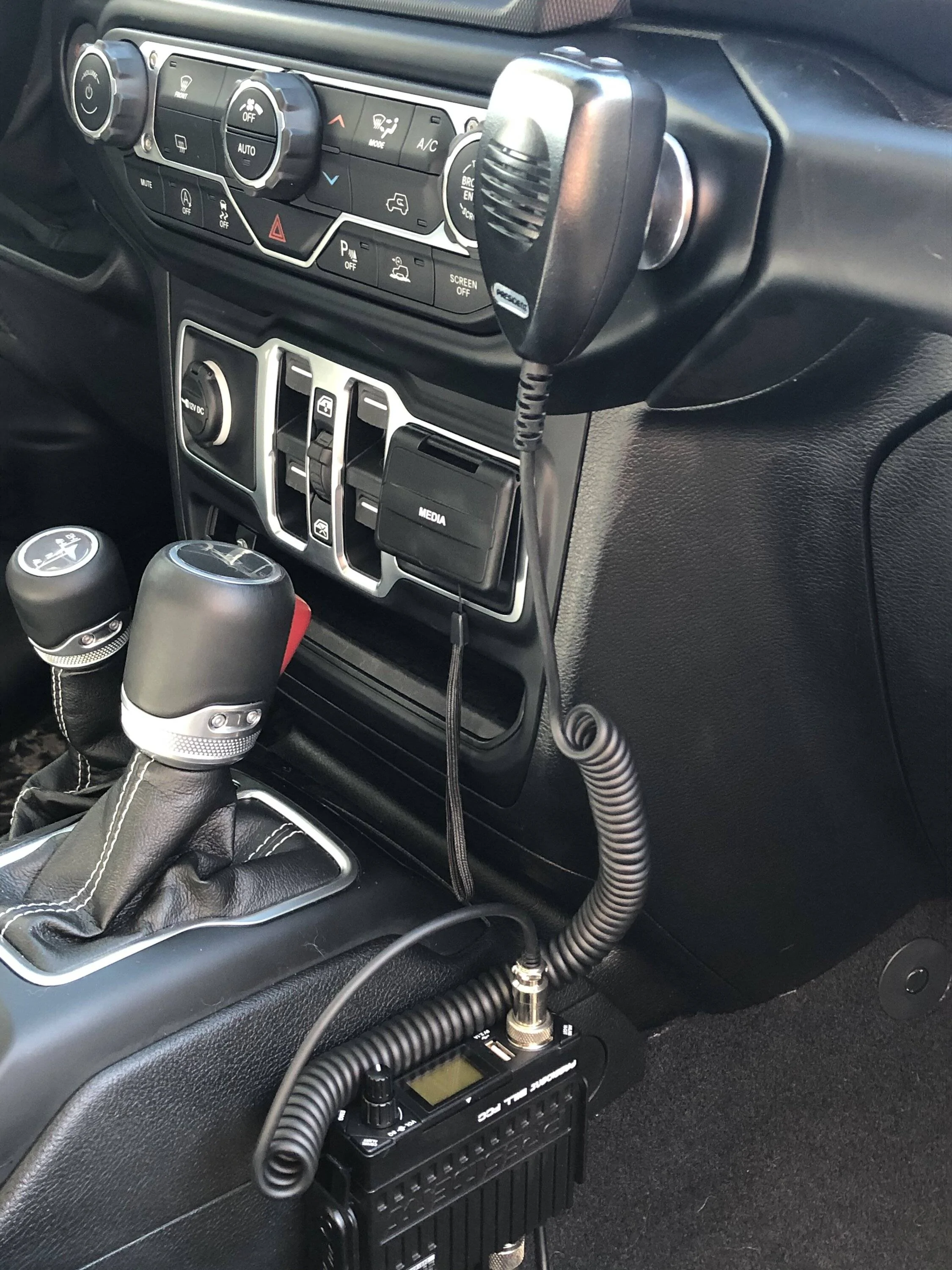

I have the Radioddity CS-47 AM/FM CB Radio with all controls in the mic. This model also uses the RJ-45 / Cat 6 cable. And I run a Midland MXT-275 GMRS.
I also have FRS and MURS hand helds just to cover everything. :rock:

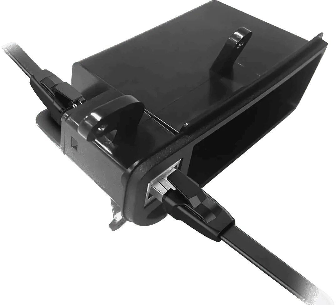

Lasfit offers a left side cubby that has a mic, RJ45, connection built in. I installed the Lasfit left side aux switches that includes the mic connection also. Installation is simple and fit and finish is good.
Anyone have a link for this ? Site doesn't show it.
