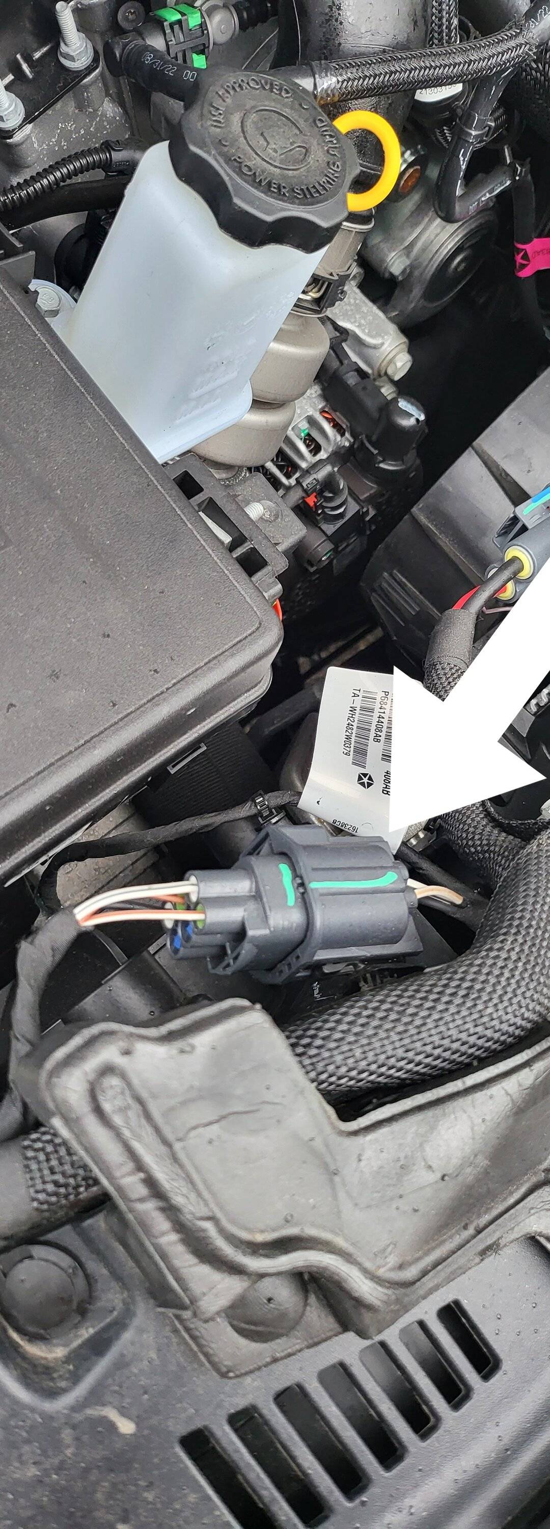

Can someone identify this plug for me? This goes from body harness to the headlight on 2023.
It passes 3 wires to the headlight connector.

That is the headlight end. I need the other end.

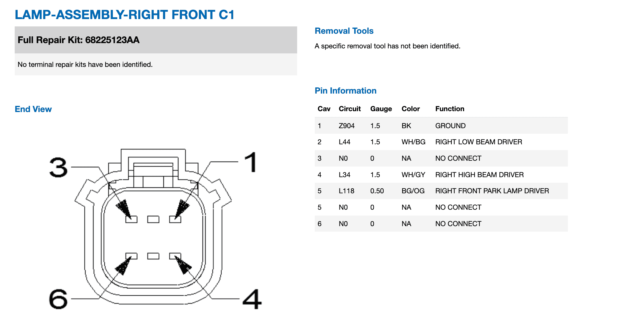

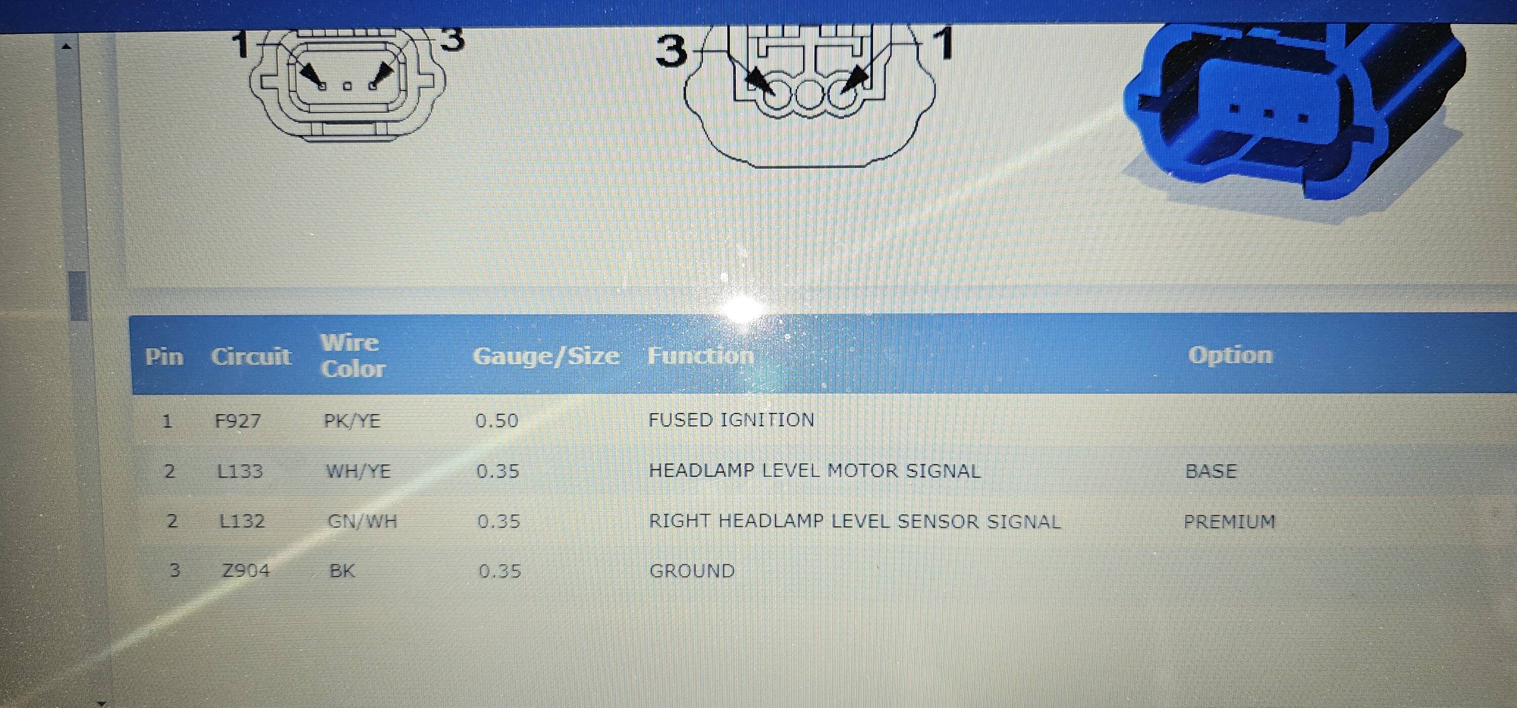

Where do you get these diagrams from?
That's an awesome find!
Thanks
I have the USB wiring manual. It is locked so sharing is tough. Afraid to let someone try to unlock it.

I was trying to see if I can get terminal parts for that connector so I can hack the existing one connectors in the Jeep to connect the halo on my LED headlight on passenger side.
My driver side has 4 wires. The passenger side has 3. Jeep sells the harness (68414409AB) with 4 wires already. It is quite challenging to find the components for this connector let alone identifying it.
It is cheaper and easier to buy the new harness so it is ordered.
