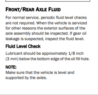

The information you are looking for is in the Owner's Manual. It is 75W85 synthetic for the M210 front & M220 rear axles. If you search around a little on the forum, you will also find the listed capacities for the M210 and M220 differentials on the Rubicon. IIRC, it's 1.53Q rear and 1.09Q front. Regardless of the quantity, per the manual, make sure to fill to approximately 1/8" below the bottom edge of the fill hole with the vehicle on a level surface. Always fill to the proper level regardless of capacity listed.

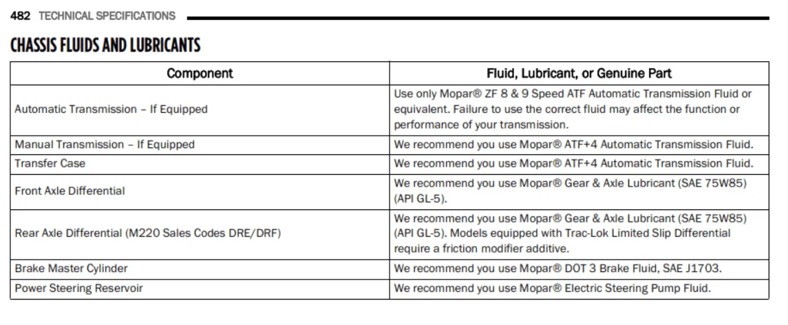

From the 2021 Gladiator Owner's Manual:

Wow. New one on me. 75W140 has always been the spec for towing applications. Just checked my manual to confirm. Yep.. 75W85.

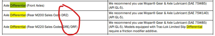

So here's my question, what is the difference in these sales codes? My vehicle info on the website doesn't list sales codes, and the distinction between these is not reflected in the previously snapped OM referenced. This is from the online owners manual (which i assume gets revised?)
Just got reageared, and am changing oil this weekend.
What does it say on your window sticker/build sheet? Mine lists the M220 axle, not the M200 axle.
Shit. Major brain fart. I didn't even see the numbers were different :LOL:
I've got the M220.

What Gladiators come with a M200 rear differential? Have seen it listed in the manual but never understood it actually being in any Gladiator I know off. JL sure, but not on the JT Gladiator.
