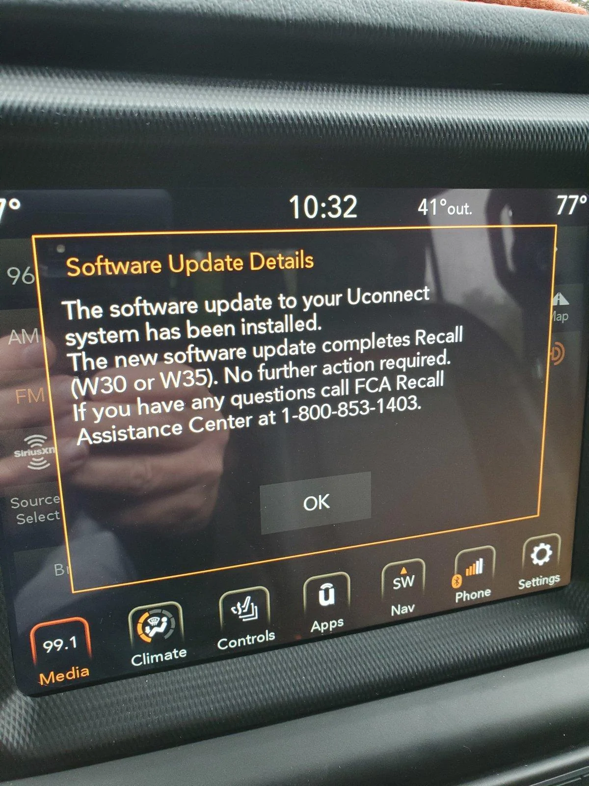

I got the message on my screen today to do the update. After I agreed it shut down and came back up like a phone update. Said it would take 45 minutes, so got out, locked the truck, went into work, came back out this evening and when I started the truck it told me the update was complete, attached is a photo of the message. I had only had trouble with the back up camera once, it simply wouldn't work, no "unavailable" message like others here. Hopefully this will fix it from getting me in the future as mentioned in this thread.
Jeep Gladiator Back Up Camera stopped working 20200520_103214
