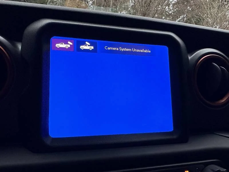

Mine came up with the blue screen this morning, ugh
Photo of error:
Jeep Gladiator Back Up Camera stopped working i-sLnWfPT-L
