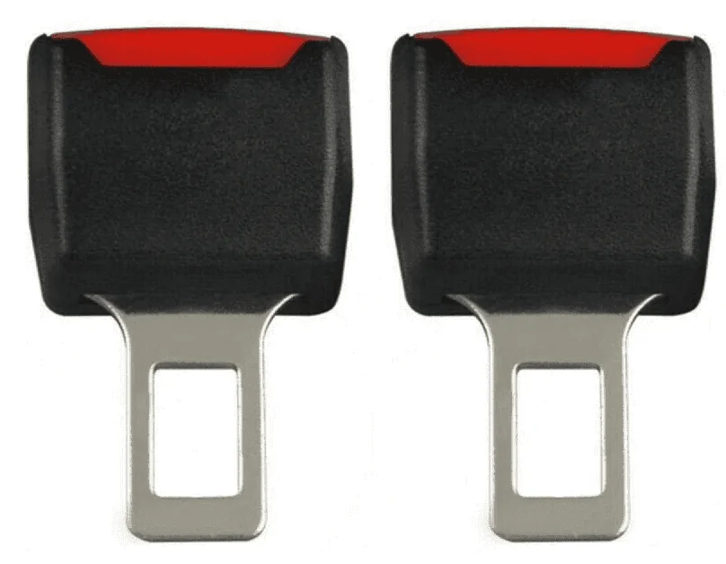

Just fasten your seat belt or buy some seat belt extenders. Who needs to back up with the door open anyway.

I use a seatbelt extender..I assume its habit, but I always have my door open when backing a trailer or a boat.
My first experience with nanny mode was in a 2017 Ram backing down a boat ramp...absolute mess. And I know for certain my resulting tirade cost Chrysler at least 2 sales :punch:..okay, really, rant over...

I disagree. I find this "feature" incredibly annoying. If you are jockeying a trailer, backing to a loading ramp, or positioning for any other kid of loading where you are in and out of the Jeep many times this is more than a little annoying. Seat belts are for the highway, not using your truck as it was intended on a farm.
In other words, there are people and use situations where this is more than a first world problem: more like a "nanny state" problem.
Thanks for the tip on the seat belt extenders, I will check that out.
