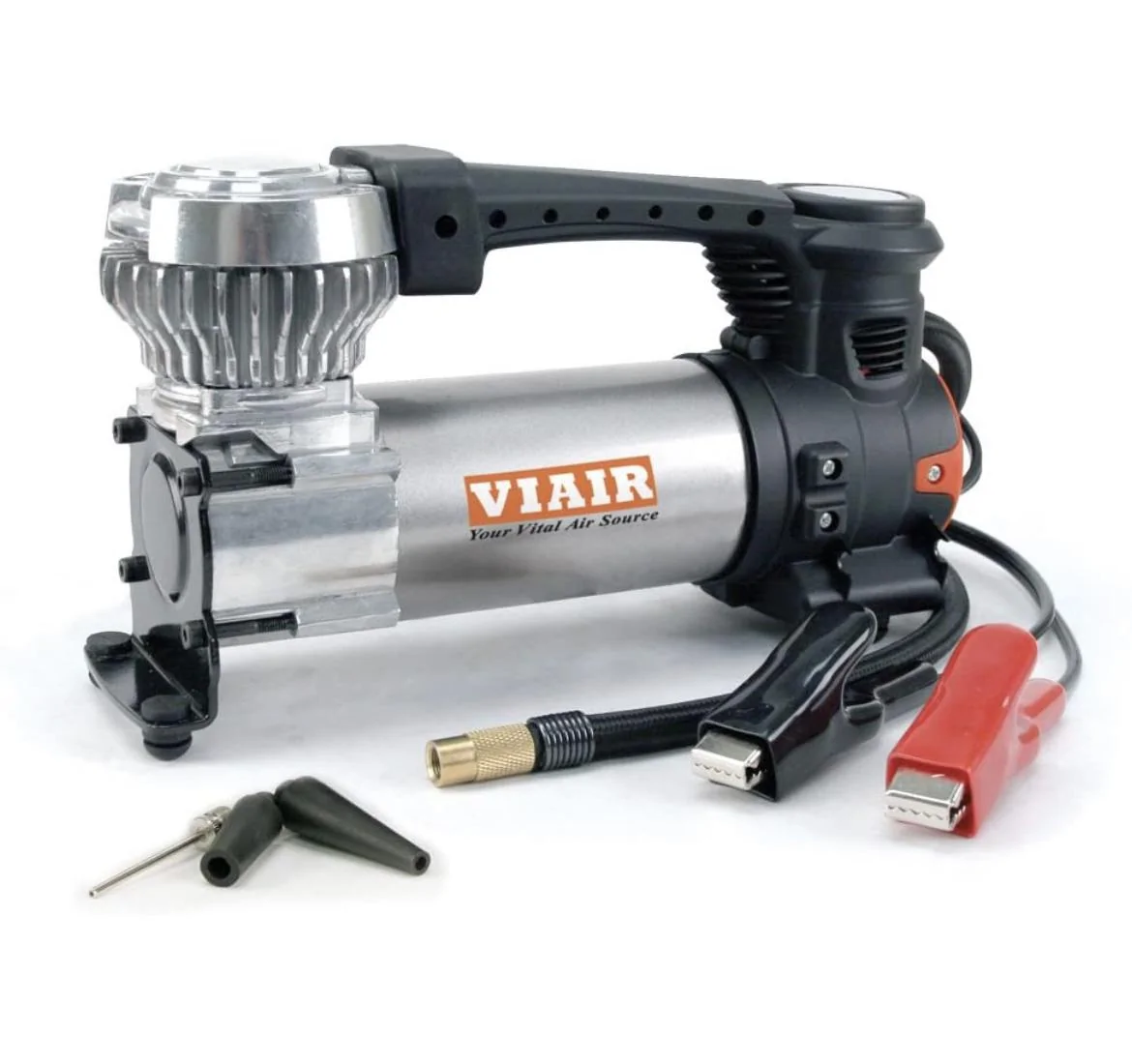

Look into a Vlair. Very reasonably priced. And they have different models made for larger tires. I have an 88p which is good for up to 33s. Stays in a bag under the rear seat.

Well, I got my Mojave about a month ago and the VIAIR 400P days ago...Tried the 400P out on my STS first. It is a nice set-up, but I find the gauge on the hose pretty worthless. While the compressor is pumping the meter shows like 100 PSI (my STS tires are rune an 32PSI). So yea when you shut the compressor the included gauged show a "relatively" accurate reading, but not close to the digital gauged I've been using...So I called VIAIR tech support in CA and the fella tells me it is normal that the gauged shoots up that dramatically when it is running. This is at odds with what the manual says (something light slight difference vs when it is shut off).
I guess the question is, how do you folks with the VIAIR's know how long to run the compressor, given you can't even get a reading until the thing is shut off?
