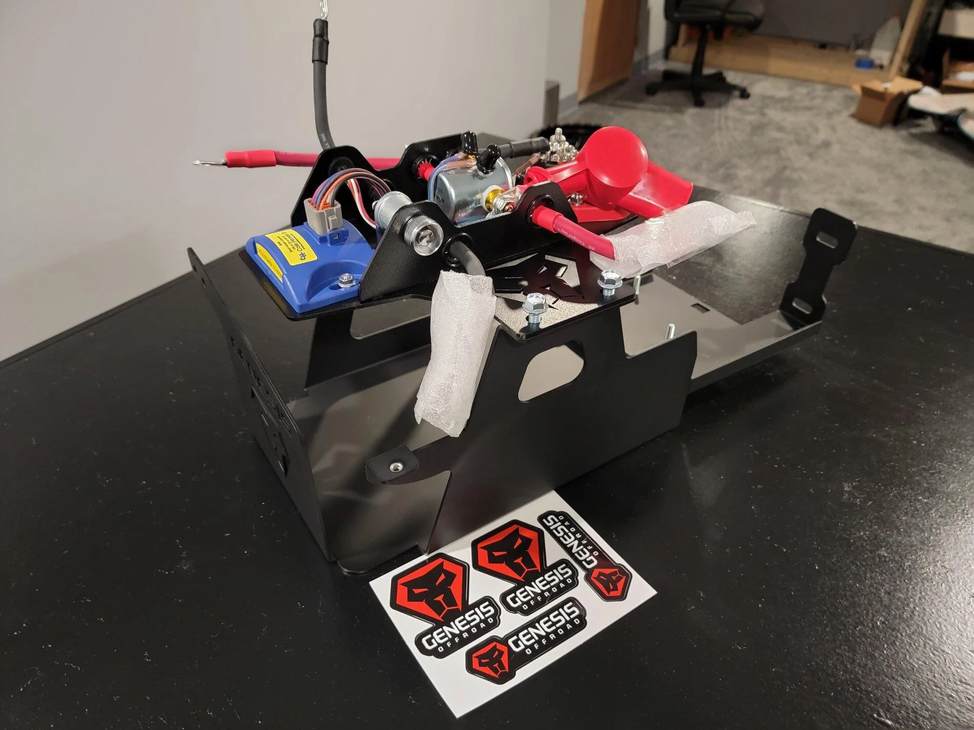

The best kit on the market is from genesis offroad, I have known Shane for years and he makes very high quality battery kits. I have one in my truck.
the JT kit from genesis removes the little battery from the truck and replaces both of them with group size 34s iirc. And it has way more mounting plates for accessories over stock.
take a look at their install video, it's very informative.

You didn't read my post. I have a Diesel. You can't do the Genesis kit.
