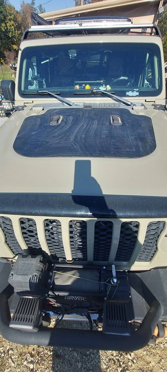

I'm one of the early adopting the Cascadia solar systems on my JT. It's been good for me overall. Now, I'm not sure it will be quite up for what you want to do. I'm sure it helped me on extending the OEM batteries life on my JT (except ESS battery) out to almost 5 years life. It has kept the batteries fully charged when the truck hasn't been started for a week or more.
For running the fridge/ freezer in mine I've got a 100 amp LiPo battery with 200 watts of solar panels for it (semi) separate from vehicle batteries.
these have got to be the best option IMO for solar on a truck that hits both the function and looks check marks, id rather dedicate a small amount of hood space over a boxy unit.
I like the ability to keep the system trickle charged when im away from the truck, 👍 thanks for the review.
To further information on it the larger battery is still working and good, not the small one it was fried though.
