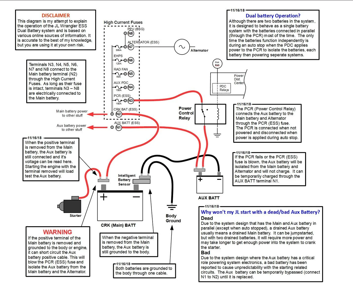

I had AAA come out this morning to install as I planned to replace the main battery now that I replaced the Aux battery. He ran a test on the battery before it had been started, then started the engine. It dipped down to 12.4 when ignition started then was a consistent 14.5 as it idled for 4+ minutes.
I don’t know enough about how he tested, but he admitted his test does not show everything. He said battery looked great, was 749 CCA and 76% battery life (said some batteries he installs run less than 76% new?) He said battery is an AGM and should get about 5+ years. He recommended taking it to a shop for a more thorough test, but he also wondered if something besides the main battery was the problem. He said he could install a battery for just under $300, but I’d be better off getting an AGM elsewhere with a 5 year warranty.

Unless you disconnected the Aux battery, the test is not accurate. The Main and Aux batteries are paralleled together all the time, except during the startup Aux battery test and when ESS has the engine turned off.

What Mr Bill said. The AAA tech probably didn’t separate the 2 batteries.
