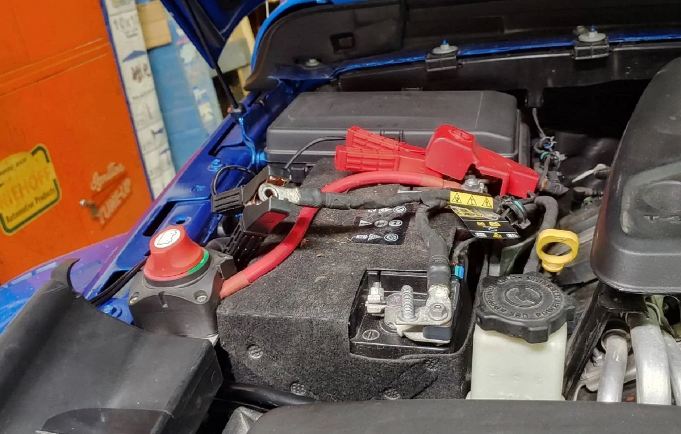

This pic shows charging only the aux battery, on a 2020.
For 2021, the cable with the larger end that has the stud is the aux battery ground.
In the case of the 2020, the top ground cable is the aux battery ground cable.
2021 and later the top ground cable is the chassis ground cable.
They hire an engineer to change how cables connect every couple of years.
I think he's the same guy that used to figure out where the hood release cable handle went on the next model year.
Anyway - picture below, charging the aux battery on a 2020.
Positive charger clamp on the positive cable clamp on the main battery, charger negative clamp on the aux battery cable end.
Jeep Gladiator Battery Charging 20220530_094946_HDR
Thanks for the picture. I have a 2020 and I removed the cable that has the negative clamp on in your picture. Is there an additional step I need to do?
