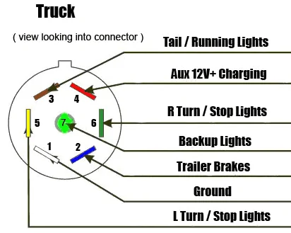

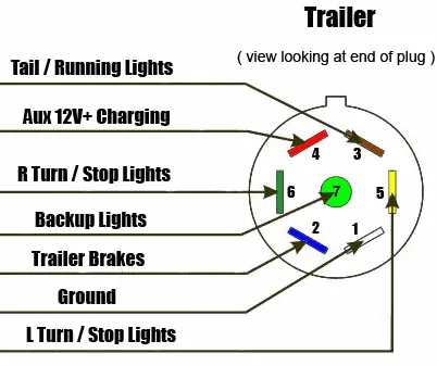

This is the female side Of the plug when opening spring loaded cover. Use 1 for ground and 4 for power.
<img src="https://www.jeepgladiatorforum.com/...trailer-plug-wiring-diagram-1-png-png.270580/" data-url="" class="bbImage" data-zoom-target="1" alt="7-way-rv-style-trailer-plug-wiring-diagram-1-png.png" style="" />
Yup - I posted the trailer side as that's what people need to coordinate with. I supposed technically someone could come up with a way to plug directly into those two without the trailer connector plug, but risky. Don't want to hit any of the other connections.

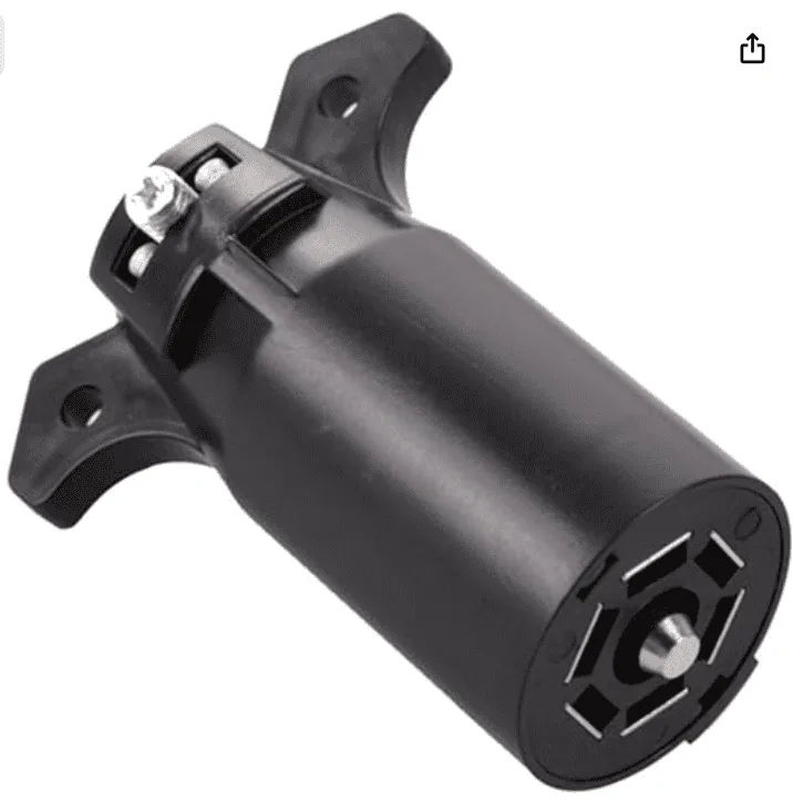

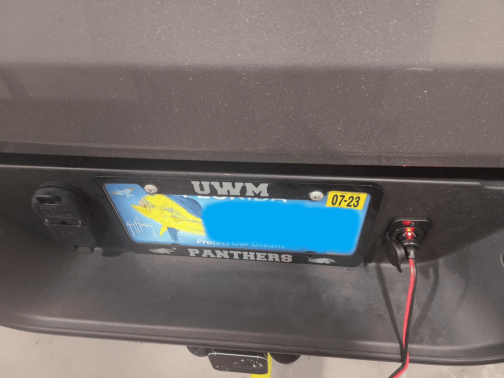

Or you can use these connectors and not wire up anything if you're going thru the trailer plug. This is my plan (should I eventually need to charge things up).

I got one of those as well figuring it could give me 12v power to things when camping.
And if used for a trickle charger - you could drive away and that 12v plug would slip right out of the trailer plug converter.
Yup, exactly.

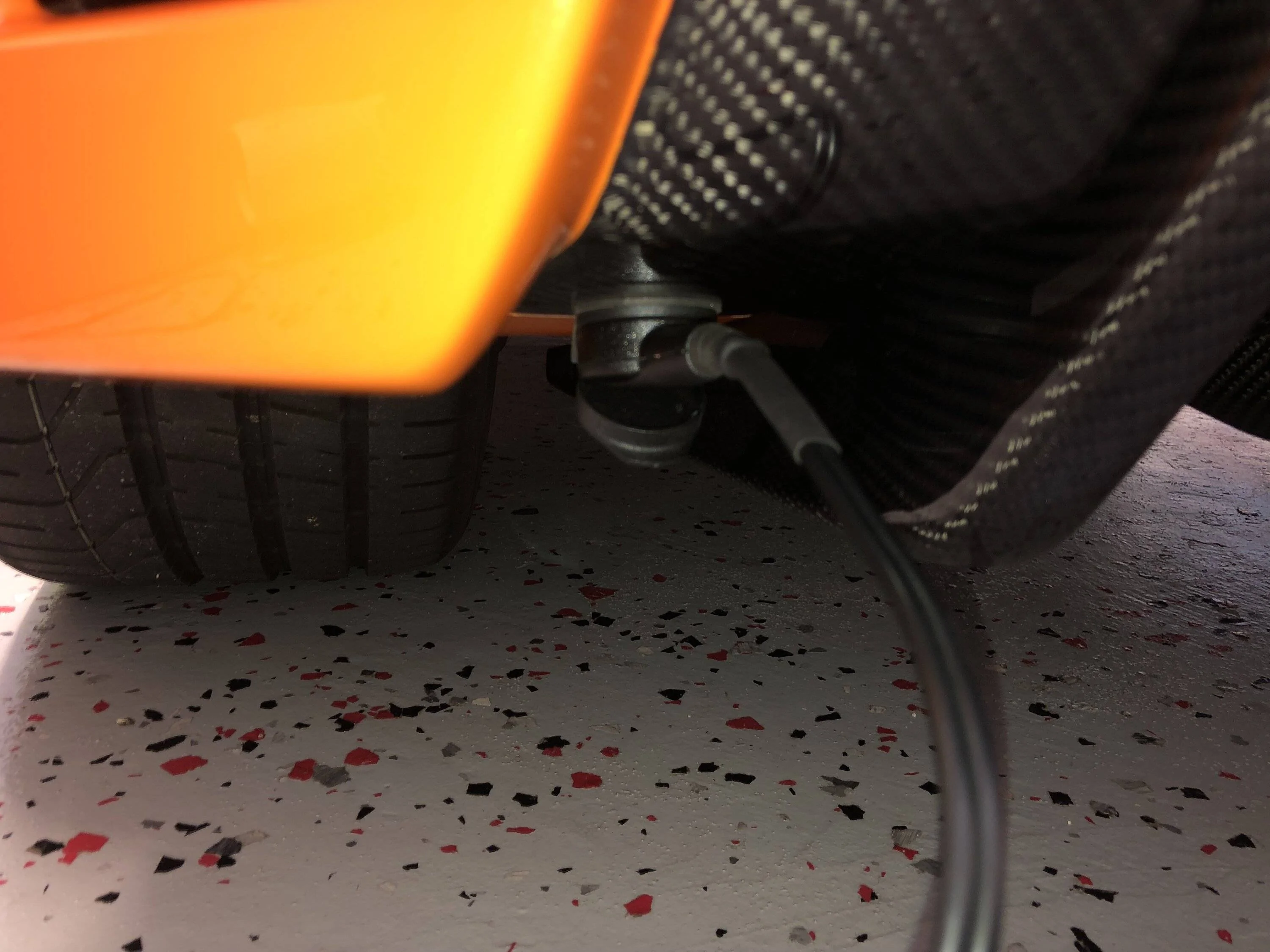

We have a 13 PIN socket / plug here in Germany (maybe also in Europe) and I bought a plug which I connected to the CTEC cable which usually would have been connected directly to the battery.
So, in principle I made my own connection to the CTEC.
I used Pin 9 for plus and 13 for earth which I have checked before if they are delivering 12V without ACC on.
So you first should measure the voltage at the trailer socket and then make a plug whith the appropriate cabeling.
But I assume the above written is quite confusing and not really understandable.
Anyhow, this is the hardware I used for my setup.

Luckily, here, it's simple. The pin-outs posted prior page are all one needs to know for these Gladiators (some other vehicles have round pin configurations wired differently).
For a Jeep - it's all the same - use 1 and 4 of that connector pictured on the prior page here and you'll be fine.

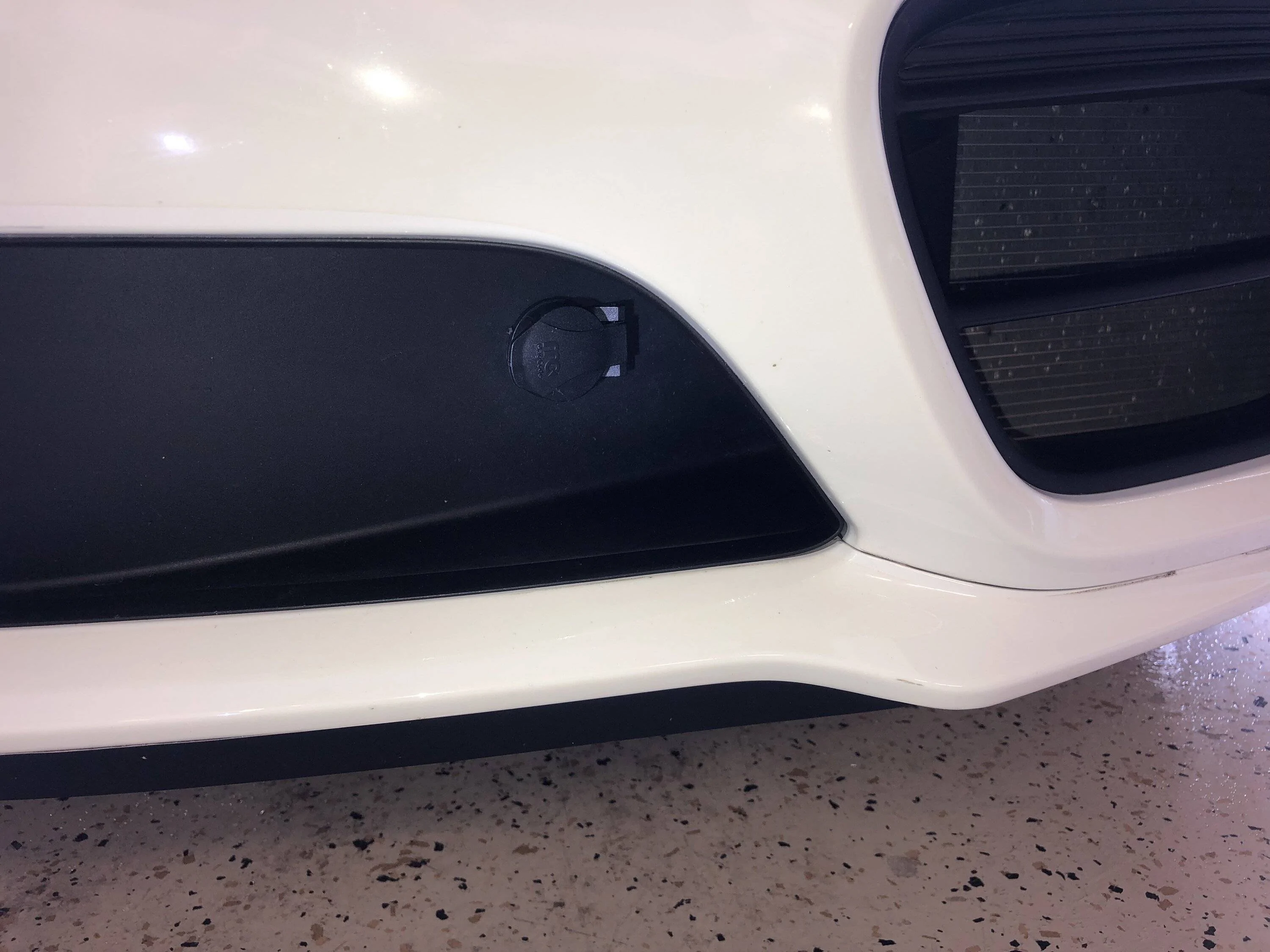

Maybe I am underthinking this but I bought the Naco 2 and hooked the wires to the battery. I used heavy duty velco to attached it to the top of the fuse box. Dropped the plug straight down and it hangs 1 inch below the front fender liner. Attached it to the fender liner with a zip tie stuck to the fender liner. I just reach into the front fender and plug it in. The ESS has worked perfectly other than the Tazer keeping it shut off. Total install was 5 minutes.
That definitely works it’s just that now it’s pretty much committed to that vehicle. I have lots of other toys that need charging thru the winter so I personally want to keep the charger ‘mobile”
