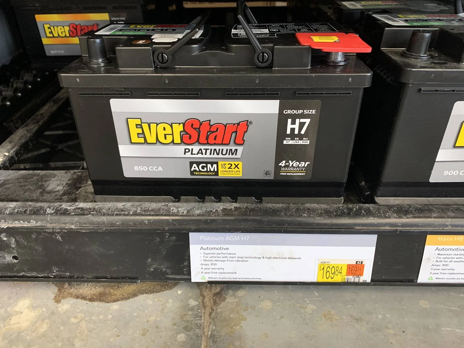

PS: I've never had a vehicle where I spent so much time looking at the voltmeter. I'm sorely tempted to just spend my own money to change the main battery, leave the aux battery disconnected, and just move on to a carefree life. I was in Walmart this AM and saw this battery: 850 cold cranking amps, 140 minutes reserve, 4 year warranty, $170. That is a good deal!

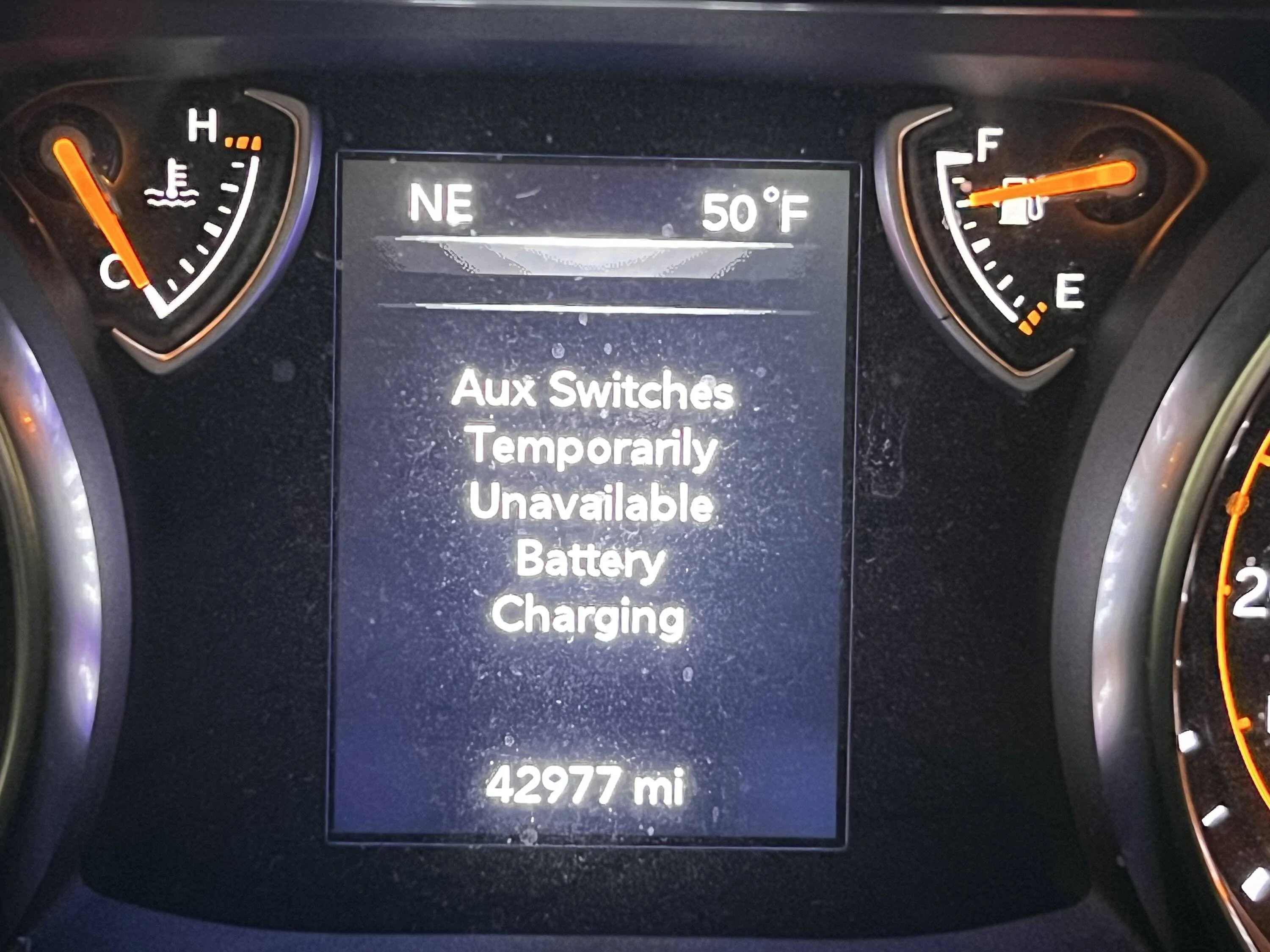

I’ve been getting the message ā€œAux Switches Temporarily Unavailable Battery Chargingā€ message for a few weeks. I bought an Aux battery yesterday and installed it, still getting the message. Had the main battery checked, showing 749 (out of 750) cold cranking amps. Is the main battery going bad but still tests as fine or is there something else in the system to check?
Battery testing seems to be a voodoo art. To do it right takes time and special equipment. I expect your battery is OK for most uses, but will not pass some test run by the Jeep systems.
Besides that, I haven't seen anyone qualify battery performance by measuring cold cranking amps. Who did the test and did you see their equipment?
I had to look up testing for CCA. Here is one article I found.
How To Test Cold Cranking Amps With A Multimeter - All About Cars News Gadgets (cars-care.net)

Did you charge the battery before installing it? The life expectancy of the AGM batteries used in the JT is about three years. I would also replace the Primary battery.
