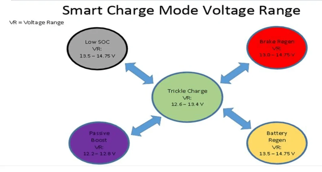

So I just picked up my Gladiator Mojave yesterday. I noticed today that mine would idle around 12.7v-12.9v and stay at 12.9v when I would accelerate. If I let off of the acceleration or applied the brake, the voltage would climb up to 14.0v-14.2v...unless I started to accelerate again or until the speedometer decreased to 15mph. As soon as it slowed to 15mph or I accelerated, the voltage would drop back down to 12.9v.
I took it back to the dealer today and we drove another Gladiator Mojave and this one stayed at 14.0v the entire time, from idle, through acceleration and deceleration back to idle... So I do not believe the issue with mine is normal cause I would expect this to happen on multiple vehicles, not just mine. Any other ideas? I have an appointment later this week so hopefully can figure it out.

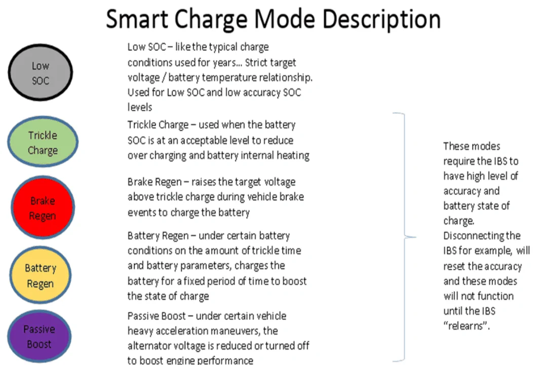

Check out multiple other threads on this. It will vary with the state of the batteries and many other factors. If the other Jeep had been sitting any length of time at all, it would indeed stay up around 14 or even more.
Yours is normal, indicating the system sees fully charged batteries.
No, they will all operate differently based on the history of the battery, current state of the battery and many other factors. There is a sensor that tracks every amp hour going out and every amp hour coming in and adjust according to need.
I would bet if you put a $20 volt meter on the battery terminals when the truck was off it would read about 12.7 or similar.

If you are still concerned (and if nothing else, so you can learn more about your Jeep!) you can periodically put a volt meter to the battery - and if it's ~12.6 or better ( ~ means 'about' or 'roughly') then it's keeping up. I mention 12.6 because if it sits a day or so, the drain from all of the systems that stay alive looking for an approaching key fob as well as other things will eventually pull the battery down a bit.
A fully charged AGM battery like these have are typically full at 12.7 - that can vary, 12.8 is a common number as well and some depends on the exact accuracy of the volt meter being used, rounding, the scale used and so on.
It sounds to me, at least based on the rough information to this point, that your Jeep is working as designed.
These are smart charging systems - charging rate is based on battery temperature (and a high air temperature, like if it's over 90 outside) will see the charging rate cut while colder temperatures - say in the lower 40s, 30s and below (F) you may see higher voltages while running because it takes more pressure (voltage is pressure) to charge a cold battery than one that is sitting at 70 degrees (F).

Was trying To figure out how the system operates (and verify that it’s normal)…since I’m not used to a vehicle with IBS, etc. Just wanted to make sure there wasn’t an issue since all of the vehicles I’ve driven always have been charging at 13.8v. But the question has been answered so I’m no longer concerned. Thanks!
40,465
53,916
Holy cow, another fellow who pays attention to detail and is observent - even to the point of correctly putting down a number that other systems charge at.
Over the years, depending on the year of the vehicle (battery technology changed) you will find numbers from 13.8 to about 14.2 - GM even changed their voltage regulators a time or two as batteries changed but it's always been around that number.
