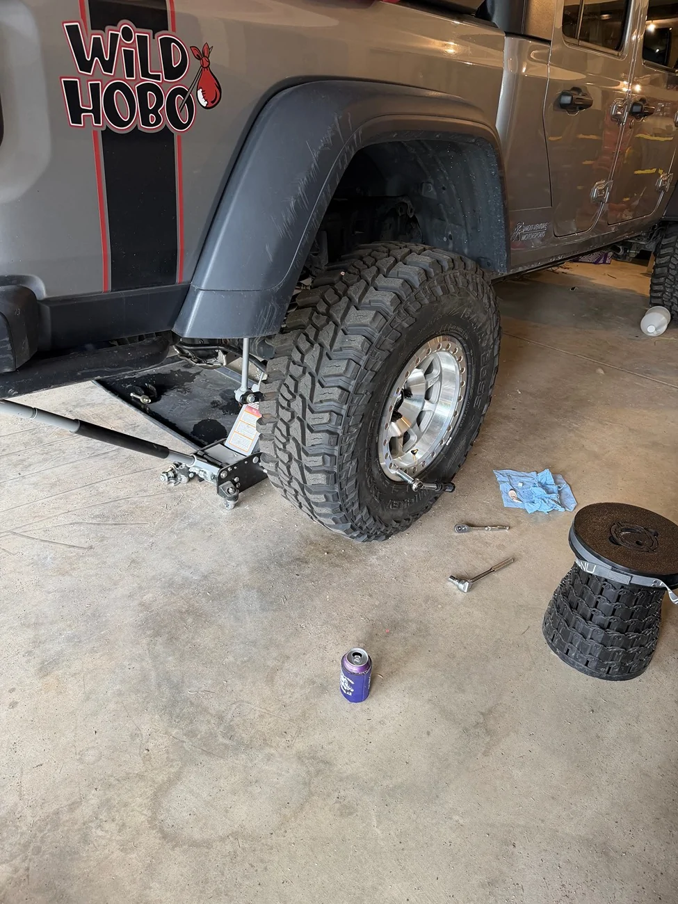

When you do go to check the bolts please make sure to air down the tire first. It's unlikely but I saw a guy get both his leg bones open fractured by a ring he over tightened that was full pressure. Caused a chain reaction of bolts shearing and the ring caused some serious damage.
After doing the 5th one today to finally have a spare again, I went back to wheel number one that didn’t have antiseize. Per advice, I lifted the axle so no pressure was on the tire, and lowered the pressure to like 2psi. I removed one bolt at a time, added antiseize, and torqued to 20.8 ft pounds. I did do a circle, but wasn’t worried as I only removed one at a time. After all 24 were back in, I checked every one twice around. All clicked without moving. Aired it back up and set it down.
So regarding my thanks for the advice part, around half of them seeped the tiniest bit of air when loosening. Like the tiniest baby rabbit fart. I was pretty happy there was only 2psi in the tire.
This thread has been super helpful. Tons of information I didn’t have, and important safety stuff was lots of that.
