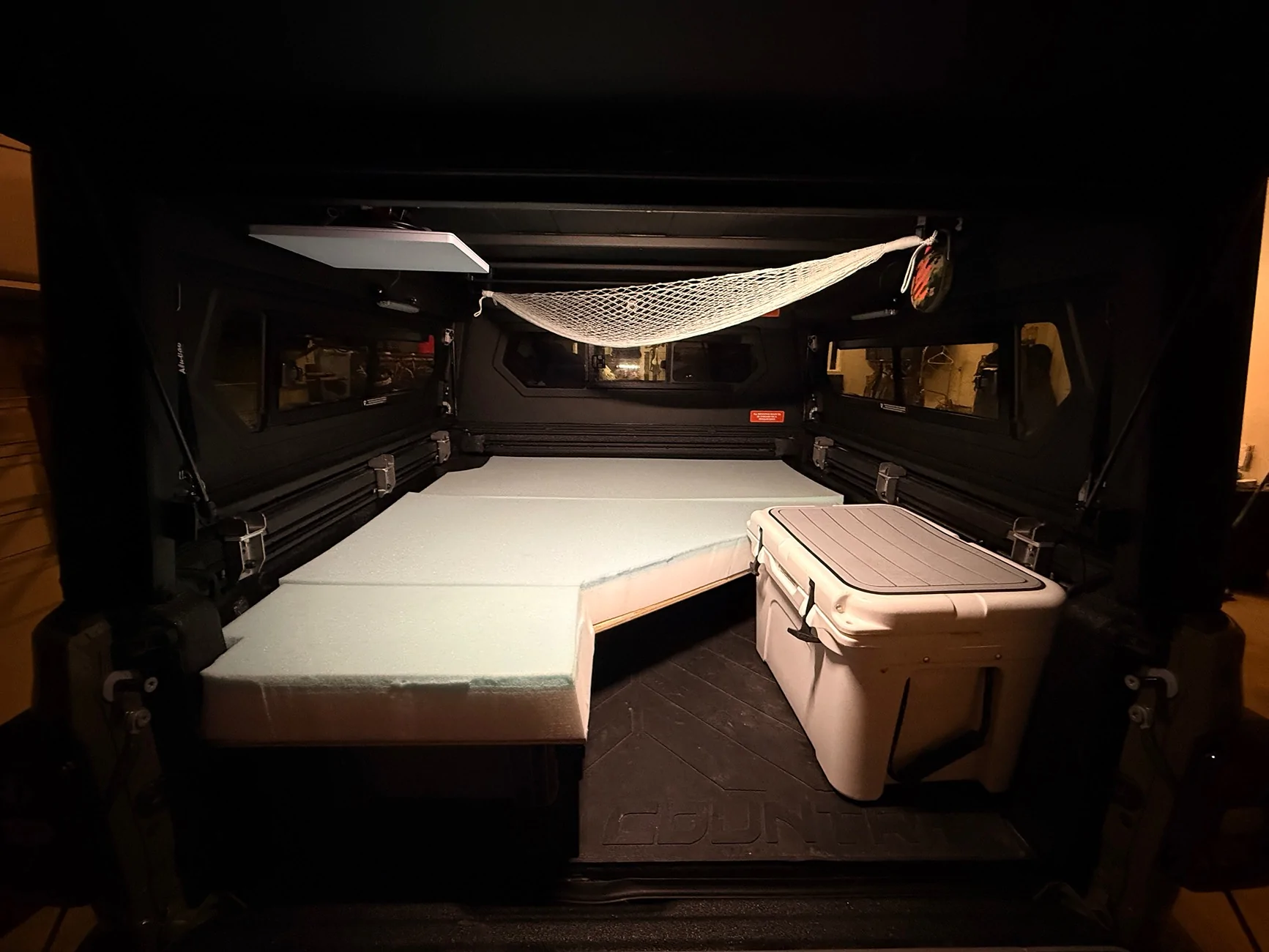

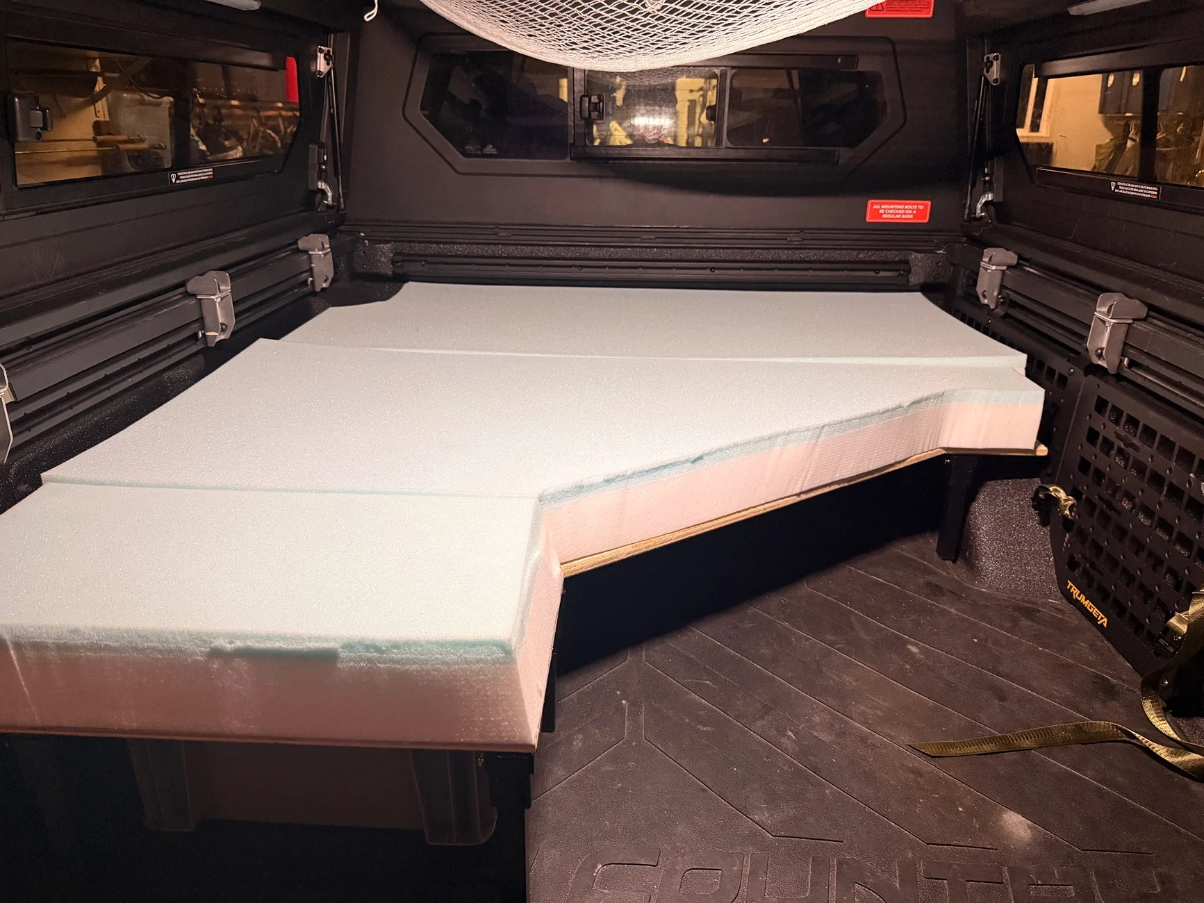

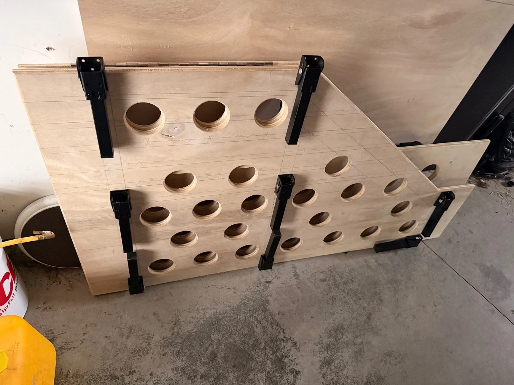

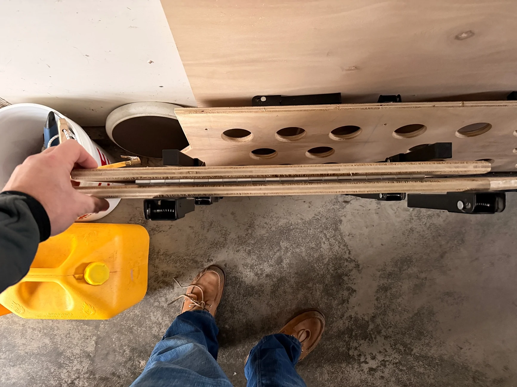

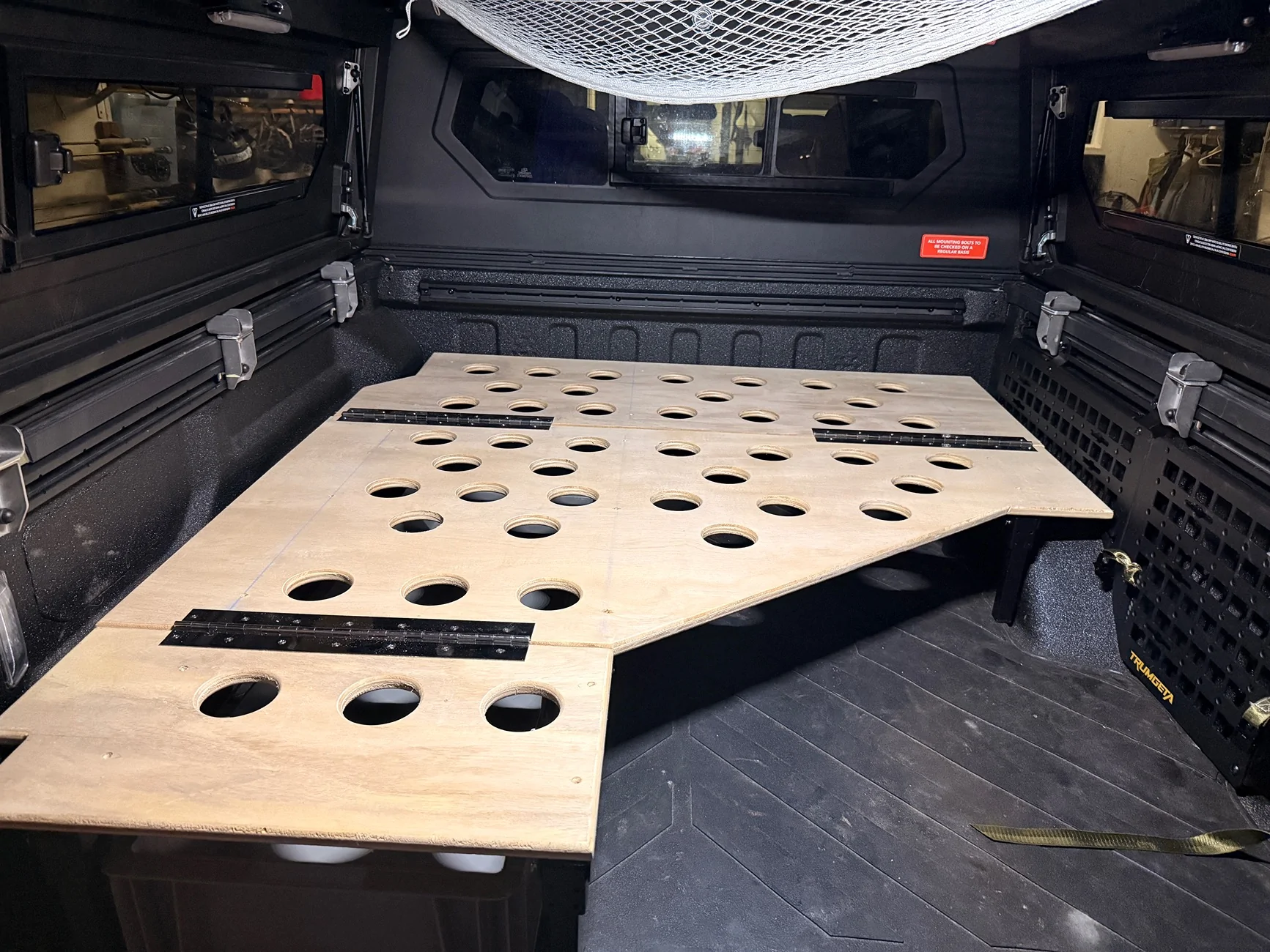

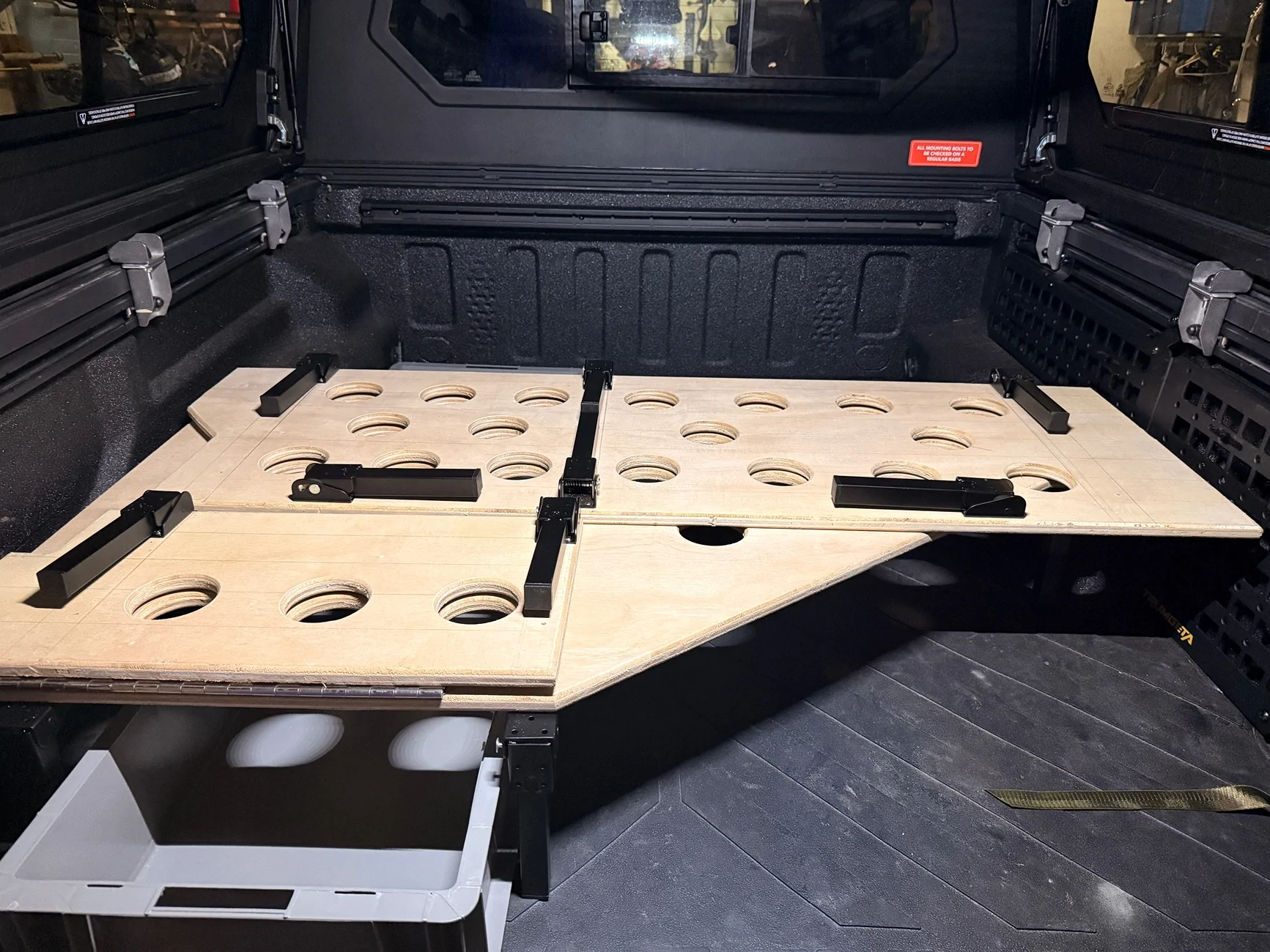

Not sure if anyone is still interested in this but I ended up building this platform after a lot of R&D. I’m now on my second iteration which shed 15 lbs.
sleeping diagonal at 5’11.5” I can fully extend. I’m a side sleeper so in the end I don’t need all that room. Supplies would be:
  • 1 sheet of birch 3/4 ply
    • Have Home Depot rip it to 54.5”. Then tell them you want a piece 30”x54.5”. You’ll cut the rest at home but take all pieces with you.
  • 4 packs of 8” folding legs (4 per pack)
  • 1/2” number 8 screws
You’ll want a table saw, hole saw, router and jig saw, drill, and an electric turkey knife (you’ll see!)
The most forward piece will need to be trimmed for the gas tank cut out but you’ll use the 18”x54.5” scrap. The gas cap cut is the only one you need to make on this piece.
the middle piece is the 30”x 54.5” piece that HD cut for you. You’ll want to figure out what works best for you, mine works well for having a power bank and propane tank attached to my molle panel with room for me to sit hunched over and put my shoes on. I threw a 32 Yeti in for the pictures as it may be more meaningful to most of you.
attach these two with the piano hinges and then you cut the last piece to size. It shouldn’t be more than 12” and likely is a smigde less. If you’ve been doing the math then you’ll note everything folds on top of itself flat making this easy to store.
I spaced my support legs to sit in the recessed grooves of the bed so I can slide a 15x48x7.5 storage bin beneath it.
Buy a 4” foam mattress that folds from amazon. I found mine for $60. Take it out of the case, lay it flat on the garage floor with the soft foam down, put the platform faced down on top of it and use an electric turkey knife (told you it would come up) to trim the foam to size. Get a stretchy full size sheet from Amazon ($15) and “Retriever_Rob’s” your uncle!
I just camped out while steelhead fishing for 3 days and it was perfect! This took me a few months to get right and a few iterations, but it really is incredible and packs up to 5”x30”x54.5”. Just lean it against the garage wall until you need to roll!

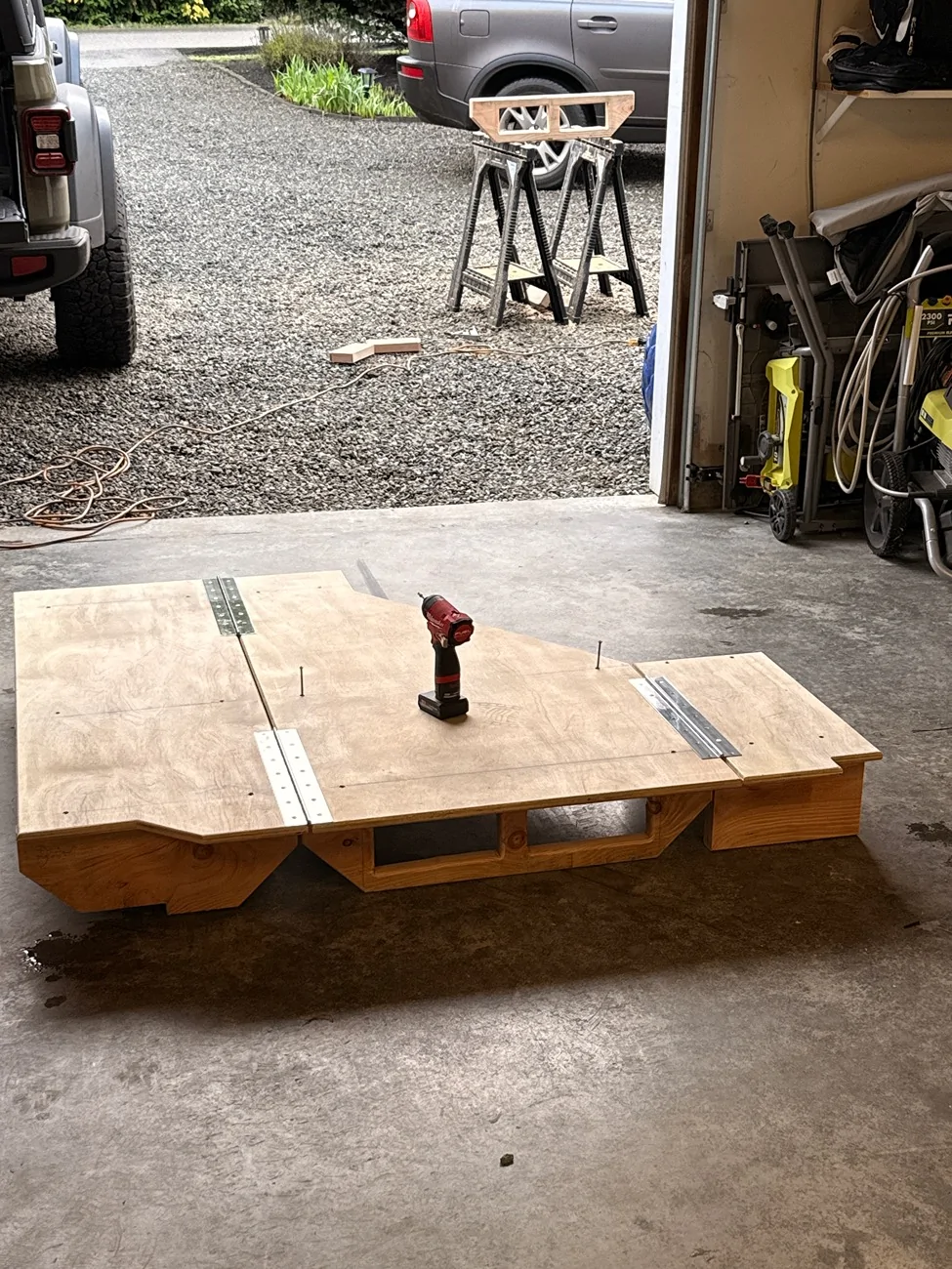

I also included a picture of V1 in case you want to go all wood. It’s a lot heavier and a pain to get in and out but it’s cheaper. Just buy a 2x8x16 and cut legs to fit.
