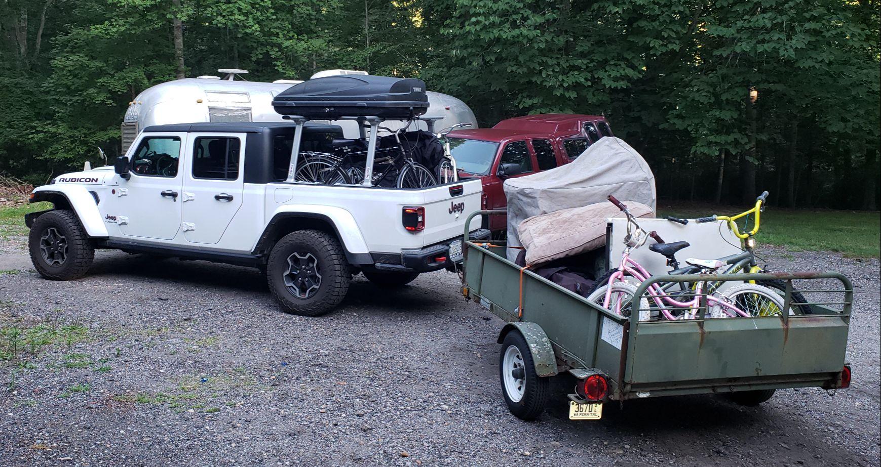

Wanted more cargo space to haul snowboards and gear on trips to CO. Couldn't find many photos of Gladiators with longer roof top cargo boxes on low crossbars.
Went with the Truck Covers USA bed cover with Yakima HD tracks. Still have good access to the bed even with the cargo box and bars. I have been very happy with the bed cover.
The cargo box sticks out past the tailgate, but no more than a tow hitch would. I had the box shifted to the driver side for easy access from the ground. Aesthetically... it is a bit odd, but functionally it works great.
Dropping photos here for those looking to put a Yakima or Thule cargo box on their 5ft beds. I had to search Tacoma, Ford, and Chevy forums to find examples of cargo box overhang with shorter beds.
Cargo Box: Yakima SkyBox NX LG - 16 Cubic ft - Dimensions: L 75.5 in x W 35 in x H 16 in
(I borrowed a friends towers and round bars for this initial trip in Feb, but have since bought Yakima Skyline towers and HD Bars.)
Jeep Gladiator Bed cover with rack 20250224_120854
Jeep Gladiator Bed cover with rack 20250228_175452
Jeep Gladiator Bed cover with rack 20250215_130002
