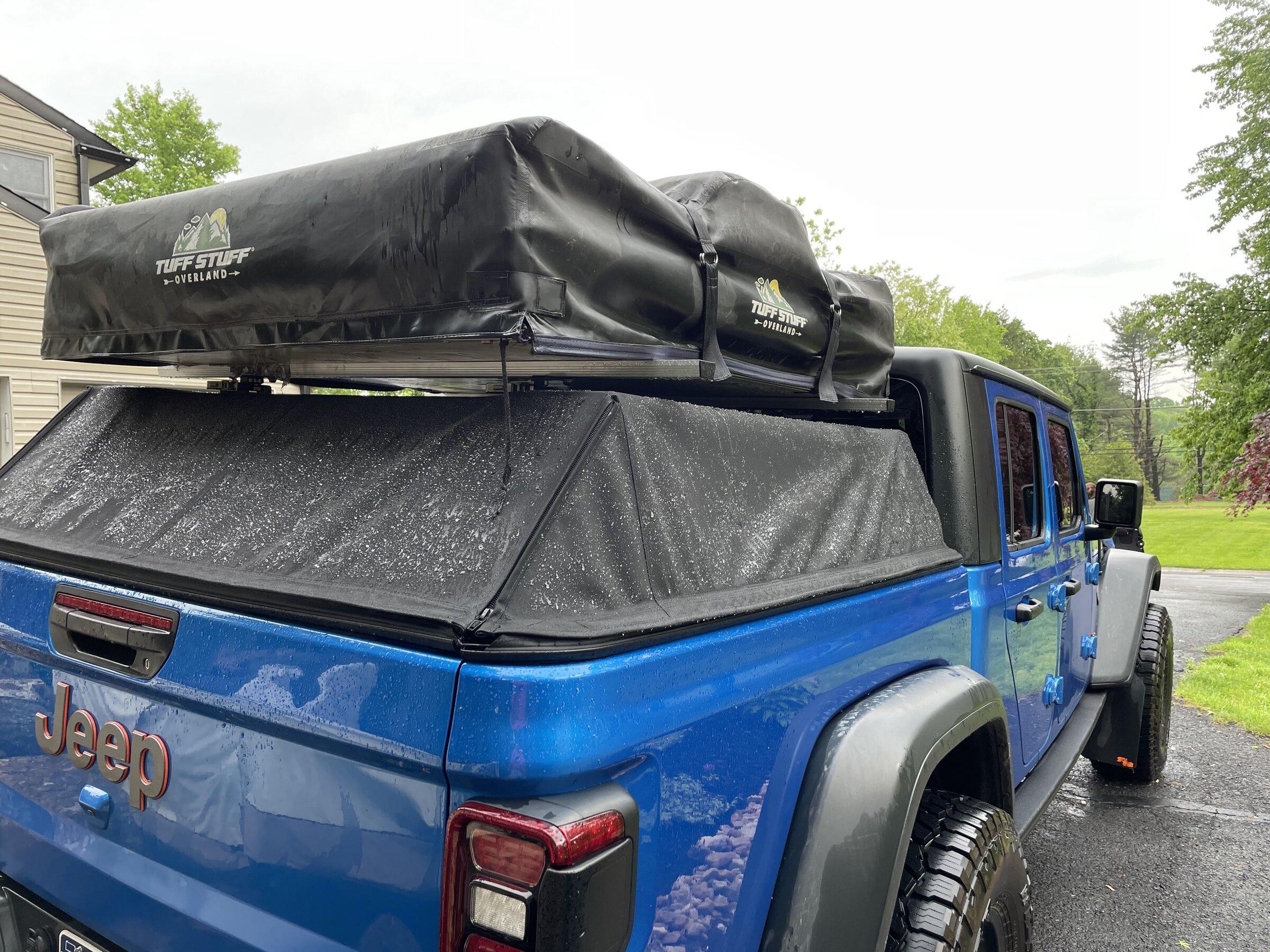

I currently have the JCR half rack and I used to have the Access Literider tonneau cover.
Cover was pain to roll back with the half rack and I lost a ton of space between the cover and the rack so I went a different route.
I found a local manufacturer of awnings and covers for boats to build me a soft top that would go over the rack.
Now I can add a fridge slide and not have to struggle-F and drag a dual zone fridge back and forth on a rhino-lined bed.

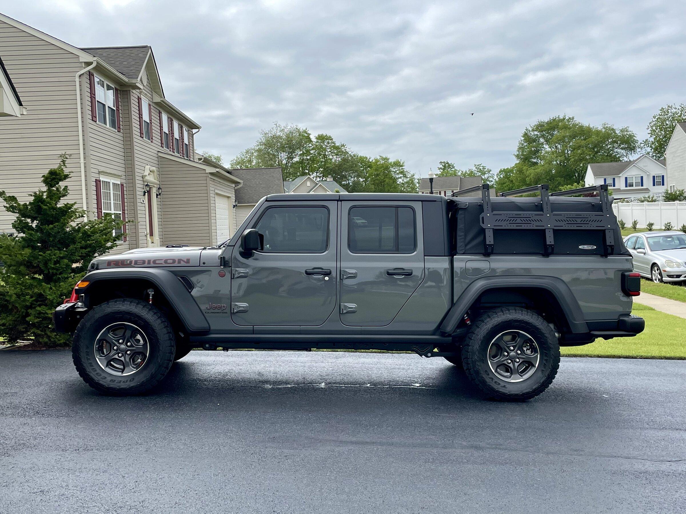

Thanks to @MynticeLX
Based on his post many months ago, I went ahead with a similar setup.
I removed my Mopar tri-fold hard cover, and then installed the Truxedo Elevate TS rail system and the Literider tonneau bed cover.
Huge backups for Yakima products due to the pandemic, I had ordered back in May and only now did my Overhaul HD system get delivered to me, I'm still waiting on the sidebars and some other mounting accessories.
I went with the Yakima Overhaul system to have height adjustment, also went with the 60" HD bars.
Just installed it this morning.
Jeep Gladiator Bed cover with rack 45419C9C-16B0-4900-A4CB-F2558E0D3939
So this is close to what I am looking for (I'm only on page 16 of 21 in this thread at the moment :whew:.) I have the Mopar soft trifold tonneau, with the bed rail system. It appears as though that might work based on this image. Thoughts?

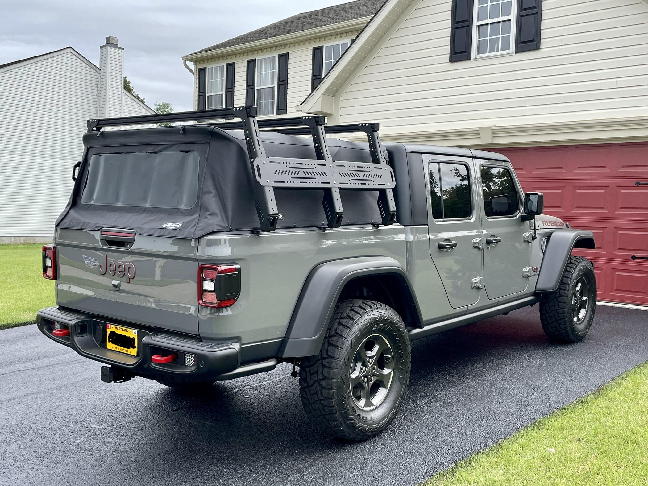

Finally got my Rhino Rack Pioneer Platform (42113B) installed on Samson. Was able to attach the rack to the Backflip Revolver X4S tonneau using the Front Runner Top Mount TALL Legs (LASS033) by using some uni-strut nuts and 3/8” bolts and washers. Had to slightly oversized the through holes in the legs to accept the 3/8” bolts.
Rhino Rack had the side rails on clearance so I added those as well. Thanks to those that shared part numbers!

No interference when you roll up the BAK Revolver X4S tonneau all the way to the back window, latched?
Thanks!
The cover rubs a bit on the back legs but makes it through. So much so, that I don’t need to latch it anymore.
