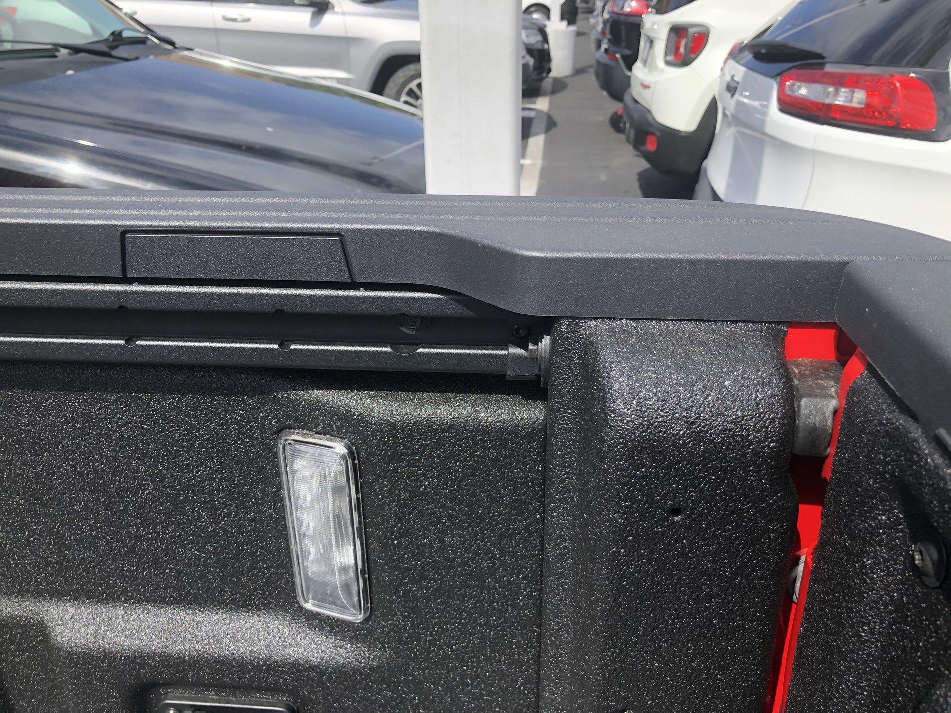

So I finally got to drive a Gladiator today and got to look at the bed and try and answer this nagging question.
In regards to the back rack, the aft most position on the trail rail is 4’6” from the inside edge of the front of the bed. The last 6” is used by the framing for the tailgate, etc. So in theory, with the Mopar cross bars (if/when they are available), would limit to <9’ kayak.
The other interesting thing is with the trail rail installed, Yakima style racks can’t mount to the bed since they clamp around the bed frame (unless the trail rails are removed).
2016+ Tacoma mounts can be made to work, both yakima and thule (shown), but need slight modification.

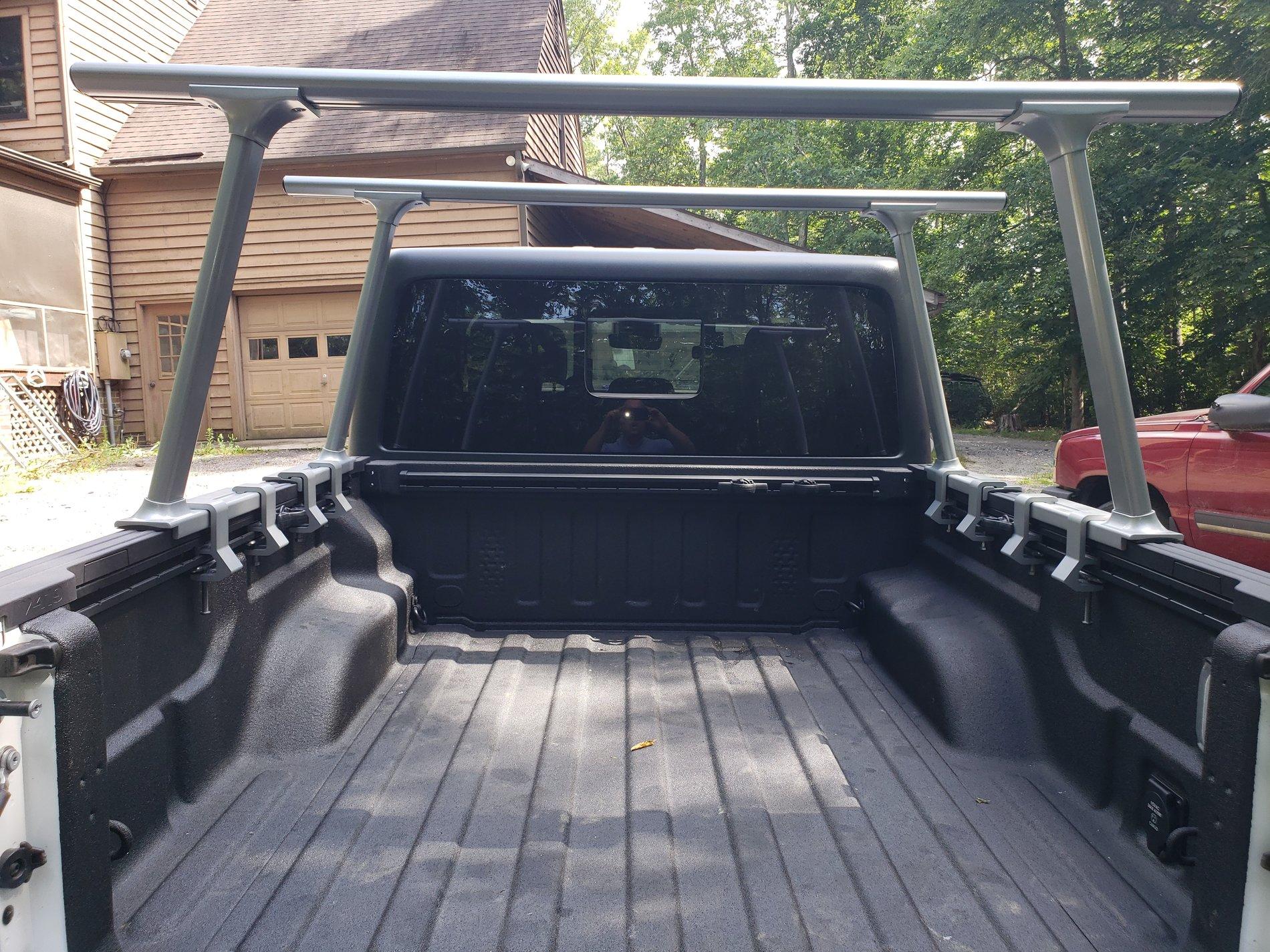

You don't, both Yakima and Thule make lower or adjustable racks, I was just pointing out that for mounting you can adapt the 2016+ tacoma kit from either manufacturer (they're different but both have been shown to work on here). I wanted above cab so I could fill the bed with stuff underneath the rack and also carry stuff that could extend over the cab. The xsporter pro from thule can be lowered - the amount of adjustability isn't huge due to the wheel well placement on the gladiator limiting how much the front can adjust, but you if you know how high you want it you can cut the front telescoping legs to hit that minimum height and still be able to raise it 6" or so from that. In actuality you could make it so it was only a few inches above the bed. It has a 450lb capacity, which is a lot higher than the mopar rails I'm sure. The non-adjustable rack I have has a an 800lb limit, and the 'pro' version has a 1000lb limit. So one of the other benefits of these rack is that they have a MUCH higher weight limit than either the roof rack or bed rails do.
Here's the Yakima setup another forum member put together, using their tacoma mounting kit. Probably what you're looking for as it's only about half height to the cab.

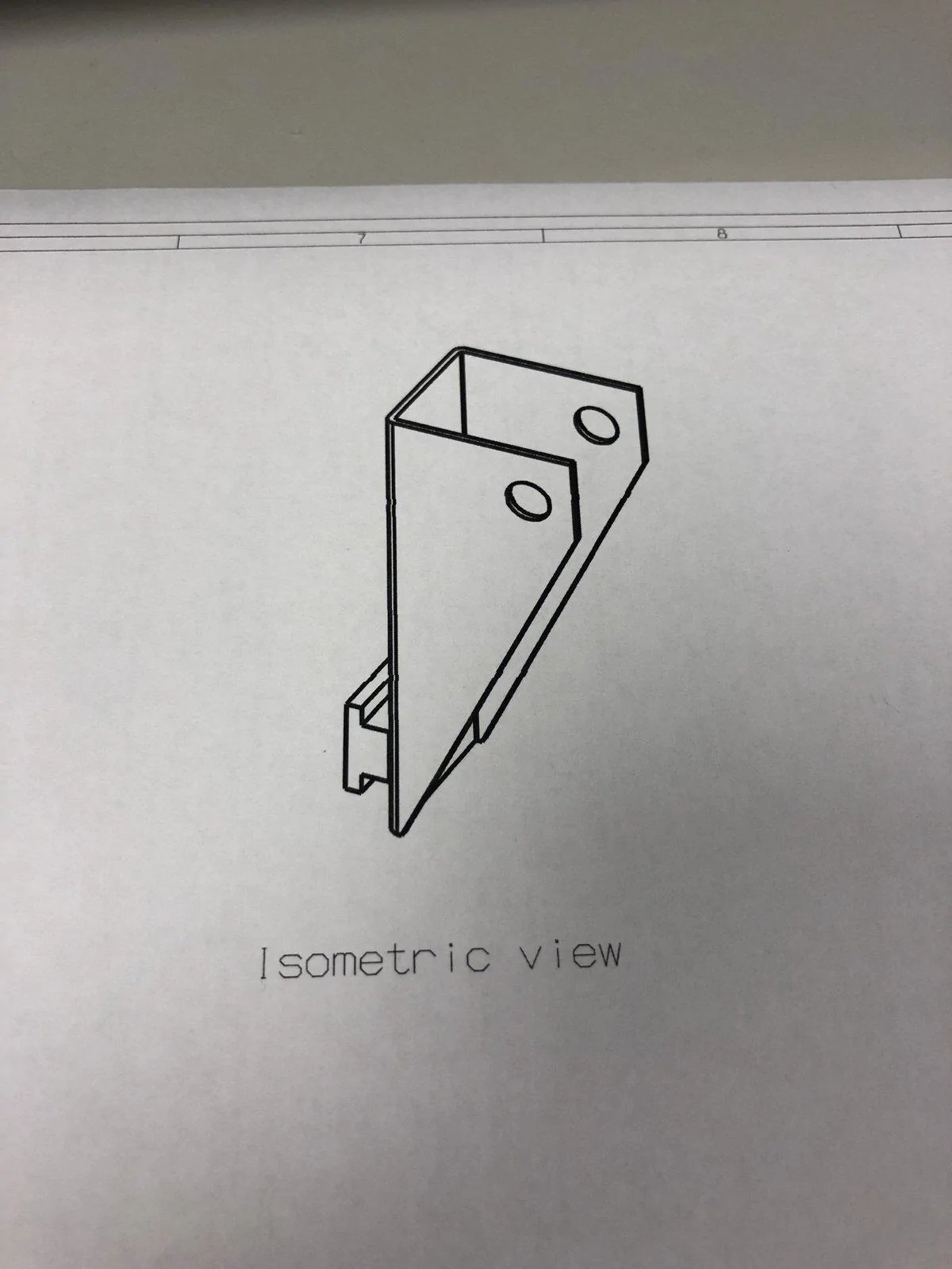

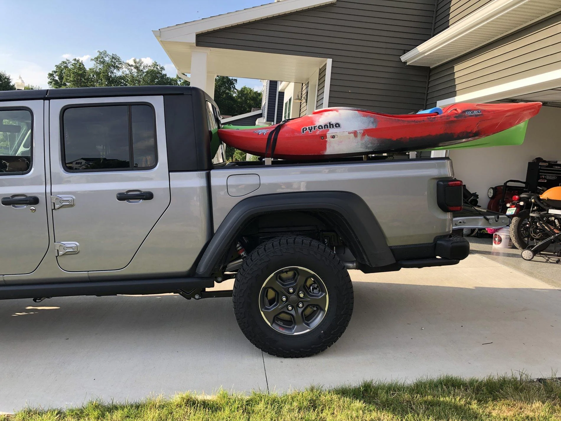

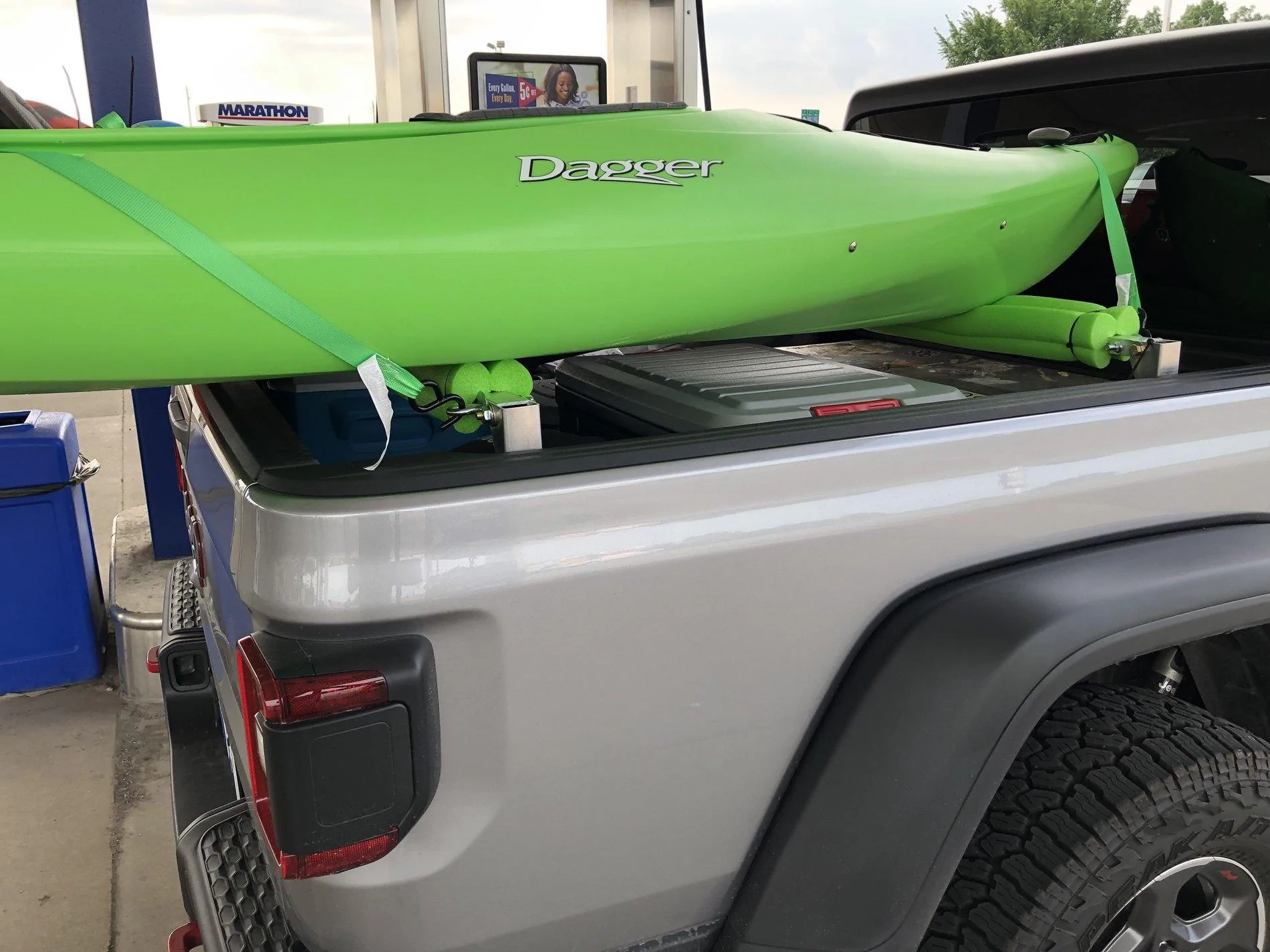

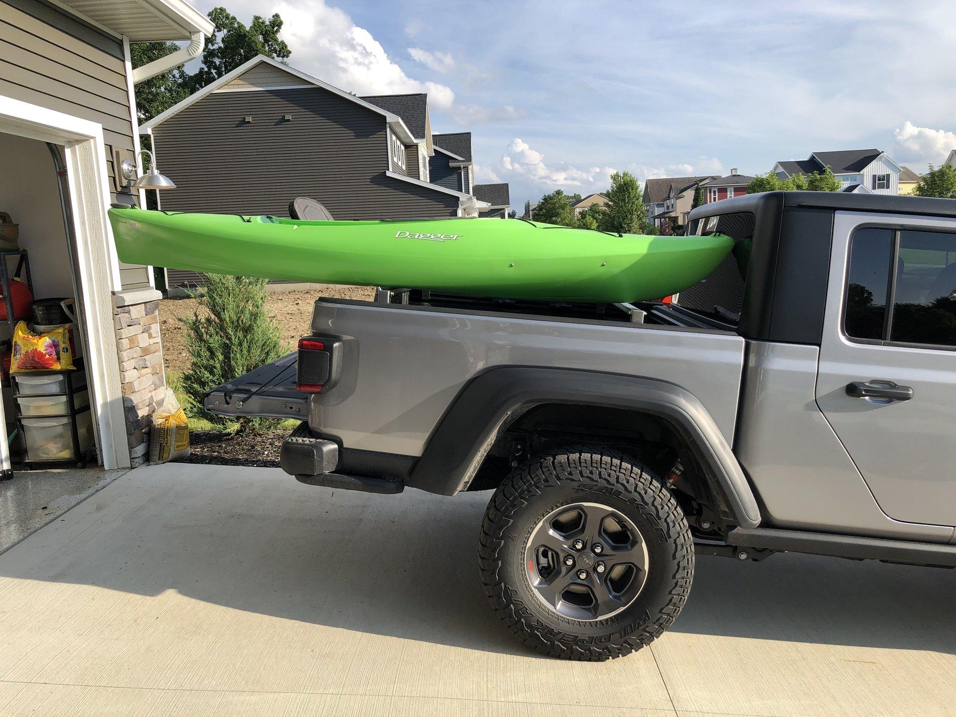

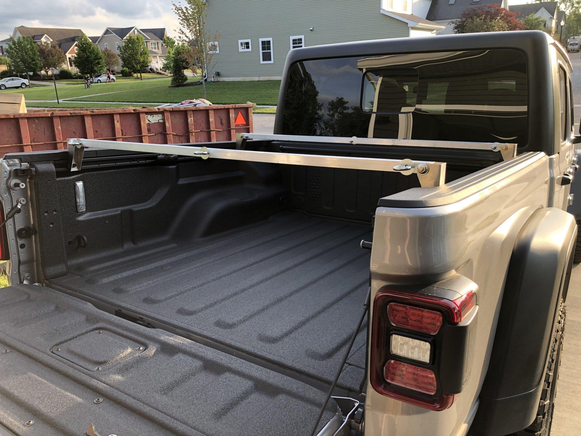

Sorry guys. Forgot about this thread. I Ended up making my own kayak rack for my truck. It’s all aluminum and I made inserts so it mounts to the bed rail system. It’s high enough to fit action packers underneath. For size the red kayak is 8ft. And the green is 9ft. The last picture is the bracket that I made to make it work. If you guys want more info let me know. I’ll take some more pics and share more details.

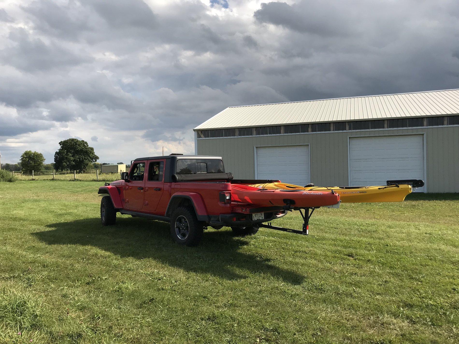

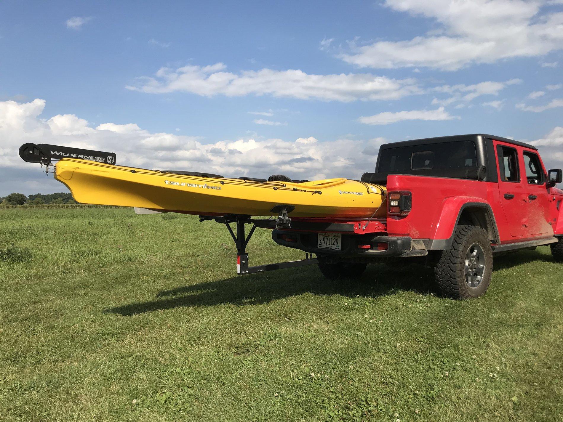

My solution until more aftermarket stuff comes online. I don't want to commit to first gen things so I went this way utilizing what I had and and some things that have other uses down the line. I used some Thule parts from the rack I used on my 2016 JKU and a receiver rack for hauling long stuff like boards and such

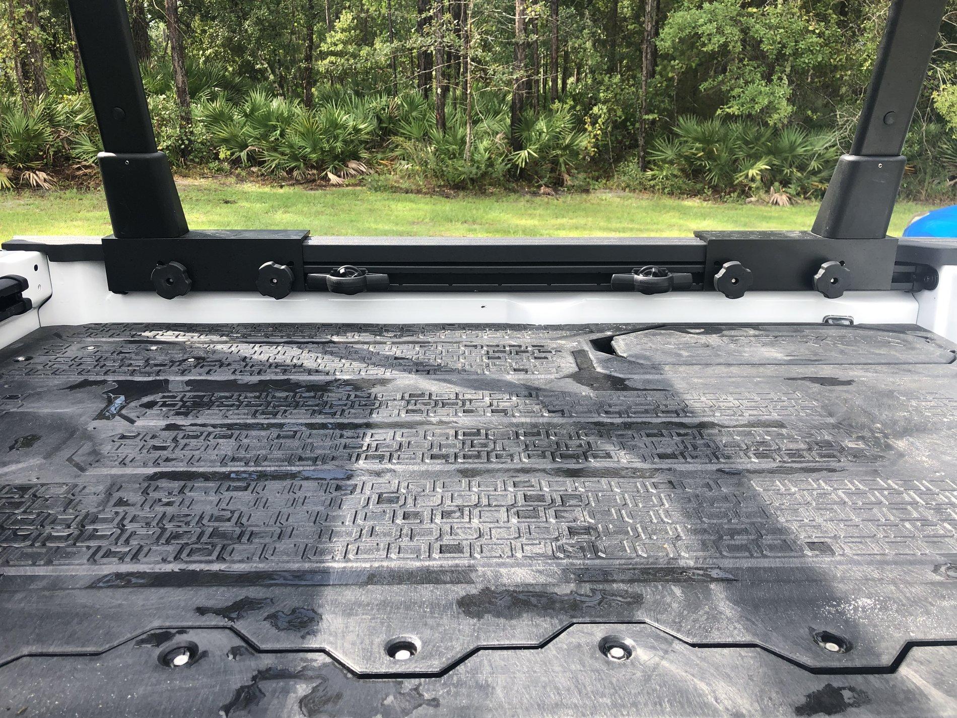

I just put the J mounts up to haul the kayak and it works great! This is the ROLA rack for the tacoma frontier. Had no issues and made no modifications to mount it to the Gladiator.

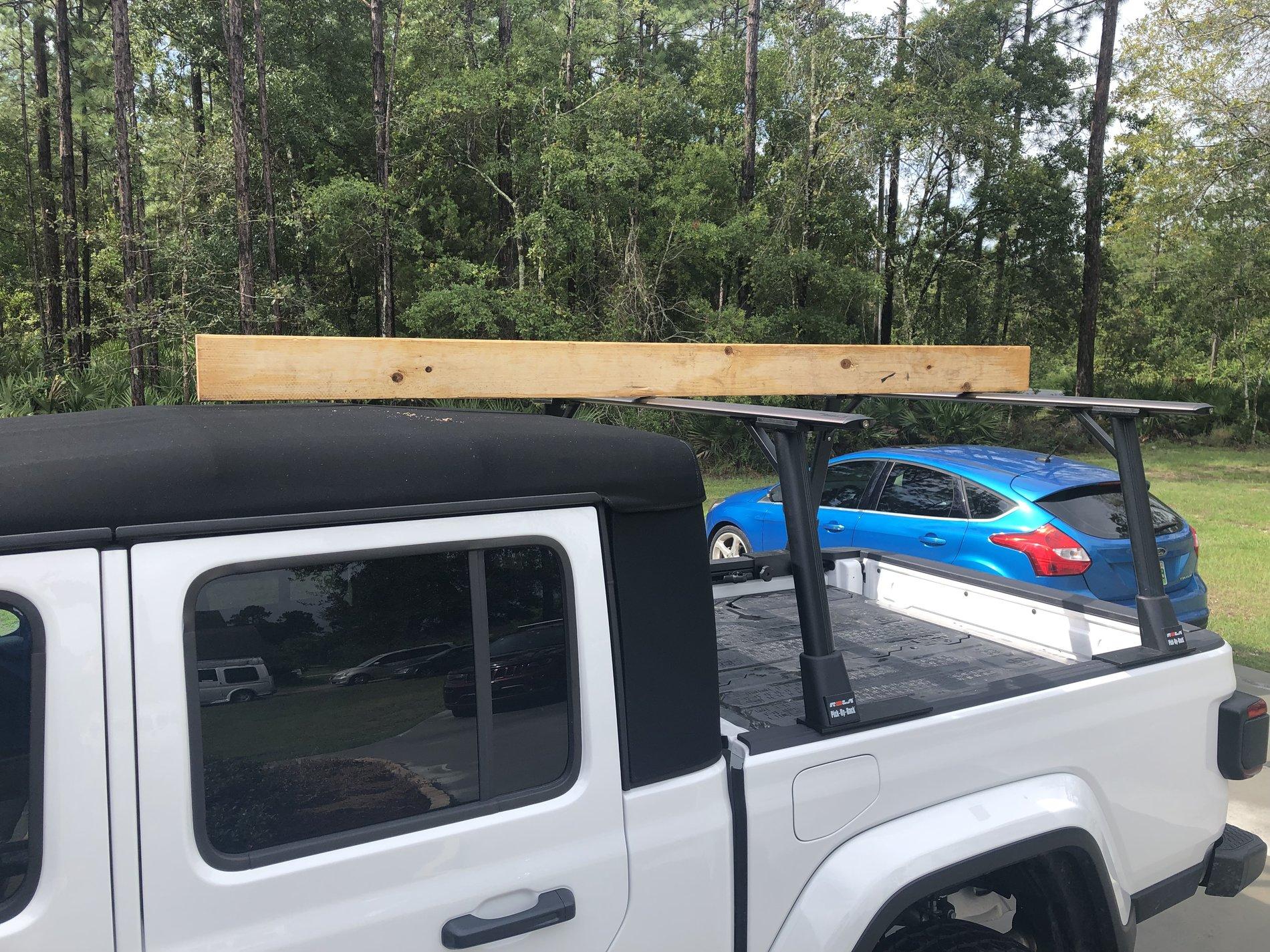

Works great for the kayak using the add on J hook kayak racks I bought from amazon.

Did you make those?
