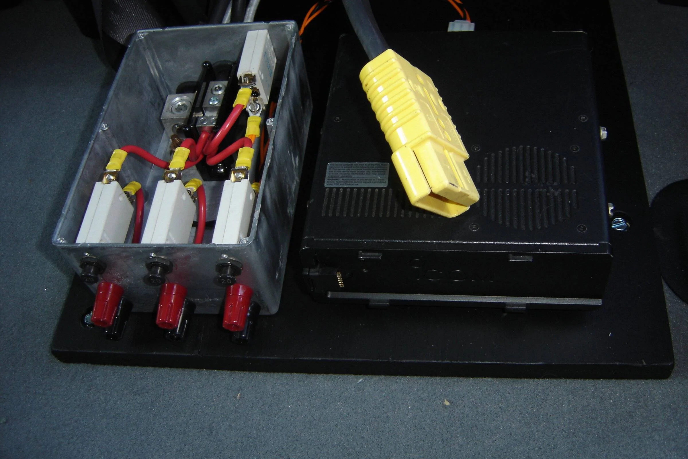

I use Aircraft circuit breakers a lot and you can mount several in a box like this. If you make an oopsie you don’t have to search for a fuse, just push the reset button.
Jeep Gladiator Best Fuse Boxes for Electrical Mods 1696807413790
