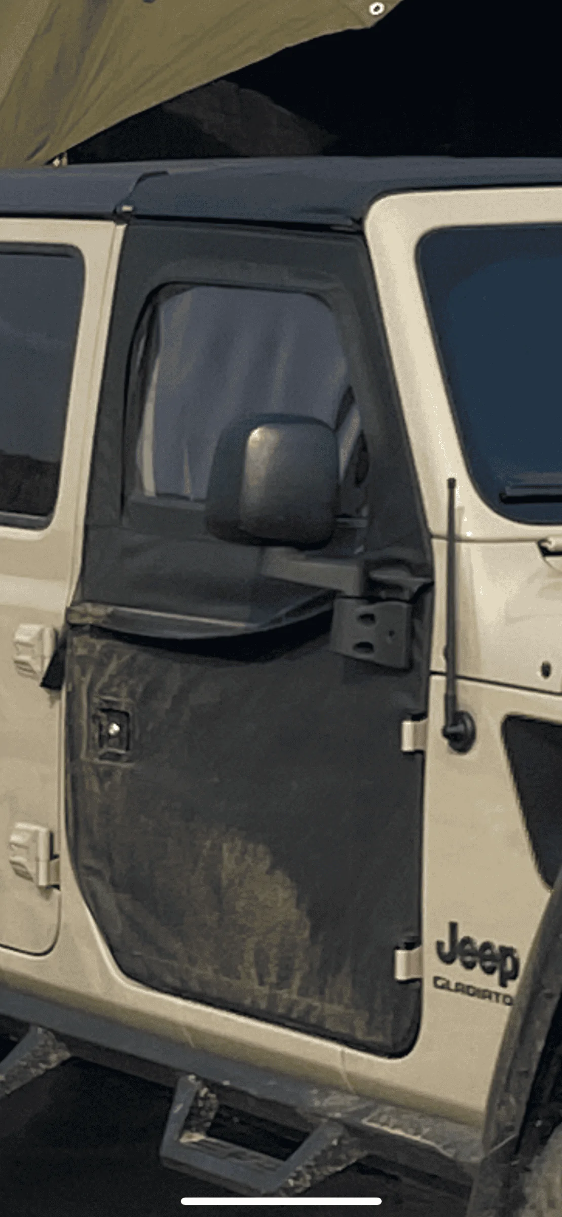

I have them and I was frustrated with this part also. It does work but as you can see it bunches up at that spot. Bestop never responded to me when I complained. Makes no sense why their own mirrors wouldn’t fit properly. The doors work pretty well for what they are and overall it’s nice to have the convenience of them. I also run the CMM mirrors and store them under my seats for when I want to go doorless completely.

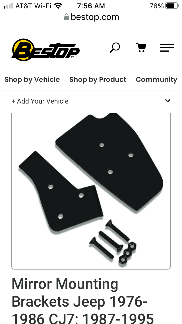

When I line up these brackets as instructed the top hole of the bracket catches the bottom hole of the plate and the other two screws clear the plate. End result is the mirror is in the same spot but about an inch lower (not sure if this was meant this way as the instructions don’t mention). Trying to figure this out before I punch a hole through the fabric. What’s interesting is there is another member on here who has the same set up but didn’t use the brackets. His mirrors lines up just fine without interfering with the Velcro. My guess is the wrong interior plates were welded on or the holes were drilled in the wrong spot.
