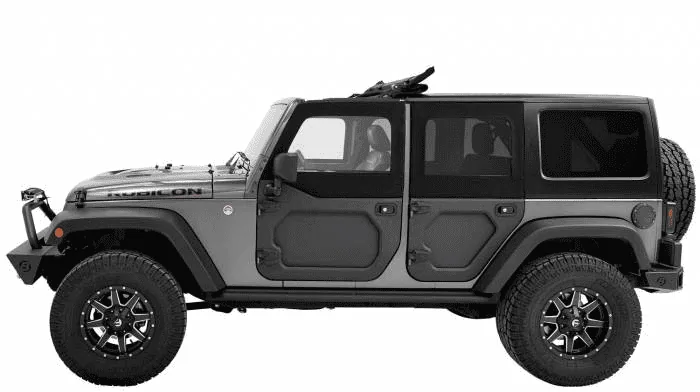

This is @Bestop replacement for the core doors. So you buy the HighRock Doors with the Enclosure Panels plus the Upper Fabric half doors. In total for the just the Front setup with twill uppers your looking at $1,515 for the whole Front Door Setup. That's double the price for the soft Doors. The question is, do these uppers flap or not?
