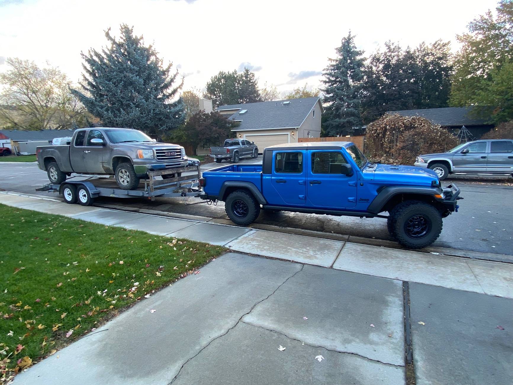

No, I put 12 ply’s on for a few reasons…I air down a lot, when I’m running 10-12psi in the sand the side wall stiffness keeps them stood up, the same in the rocks. When I first got the JT a sand adventure on the soft (side walls) stockies resulted in rolling both front tires off the rims, that same trail I’ve been on 10 times since then with zero issues with the 12 ply’s. I tow a 19’ jet boat (a lot, I’m retired) and they Really help stabilize the soft ass coils in the back. Only had them at full 80 psi once (see pic), this was my sons emergency tow out in the middle of No where during an elk hunt this year. Hope this helps.
