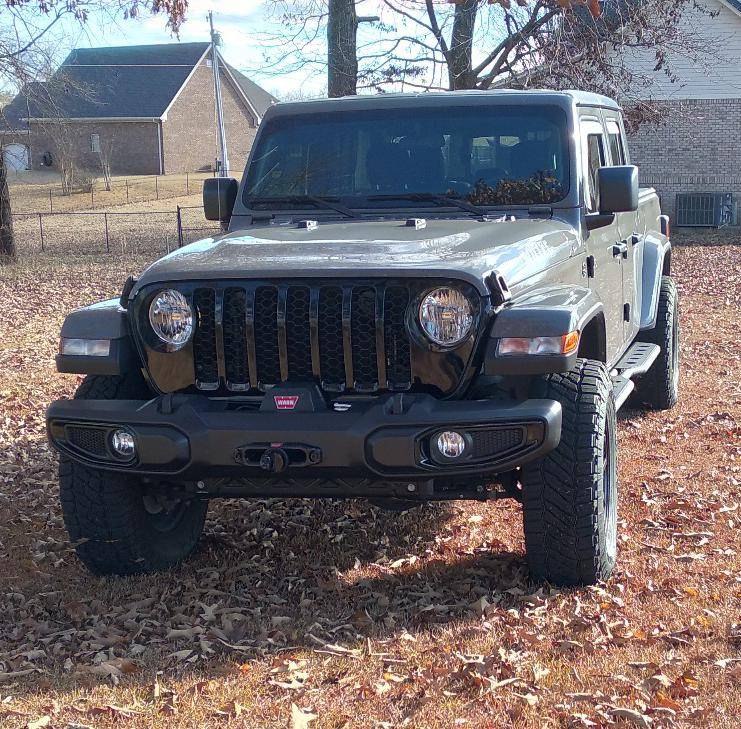

You can. I'm running 285/75r17's. I did use the TeraFlex 1.5 levelling kit for the front to lose the rake and added 1.75 wheel spacers (for a little more "poke".)

Yes. I'm not as avid of an offroader as I was when I was younger, but I have flexed it and have no rubbing with my current setup.
