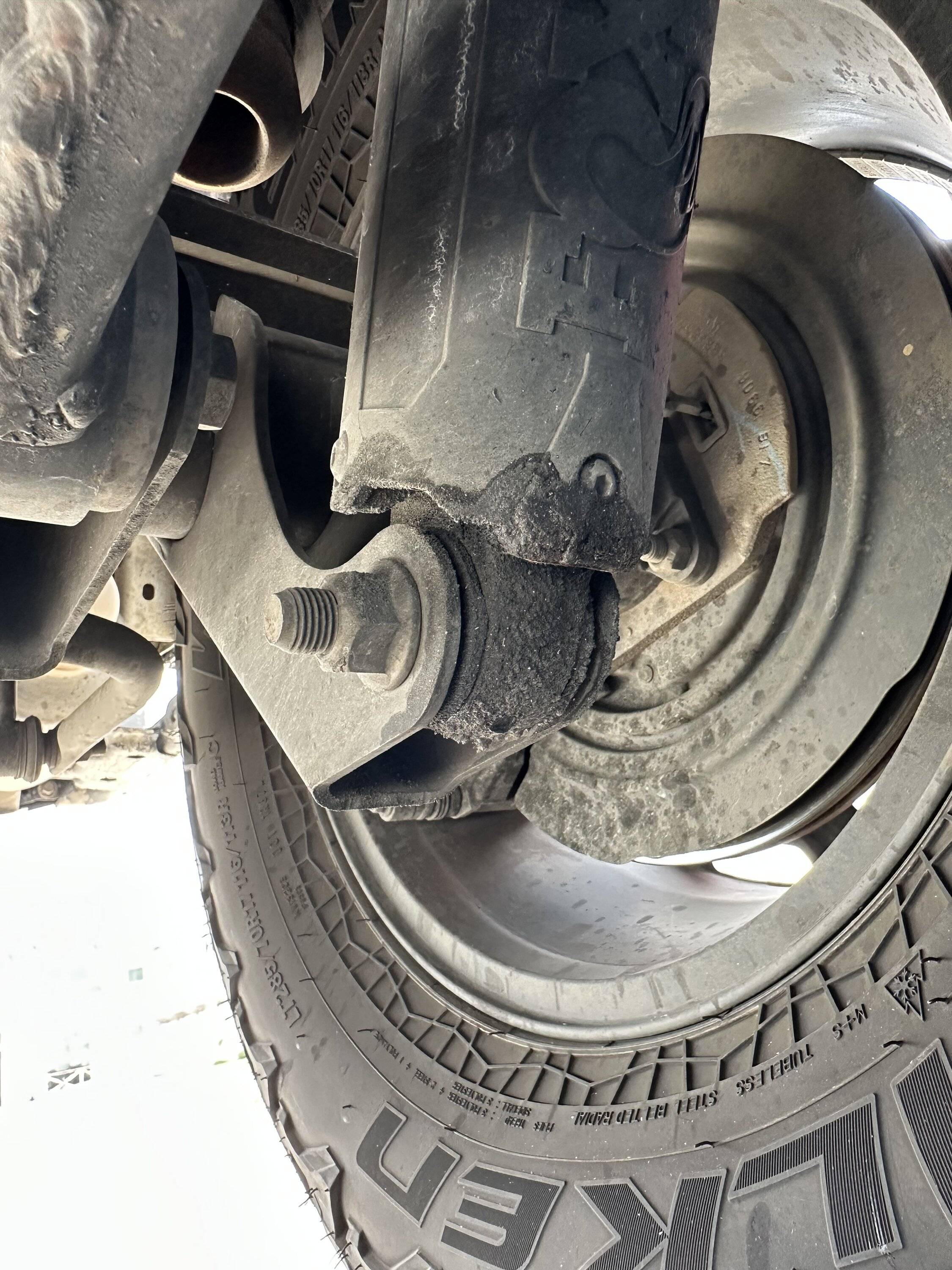

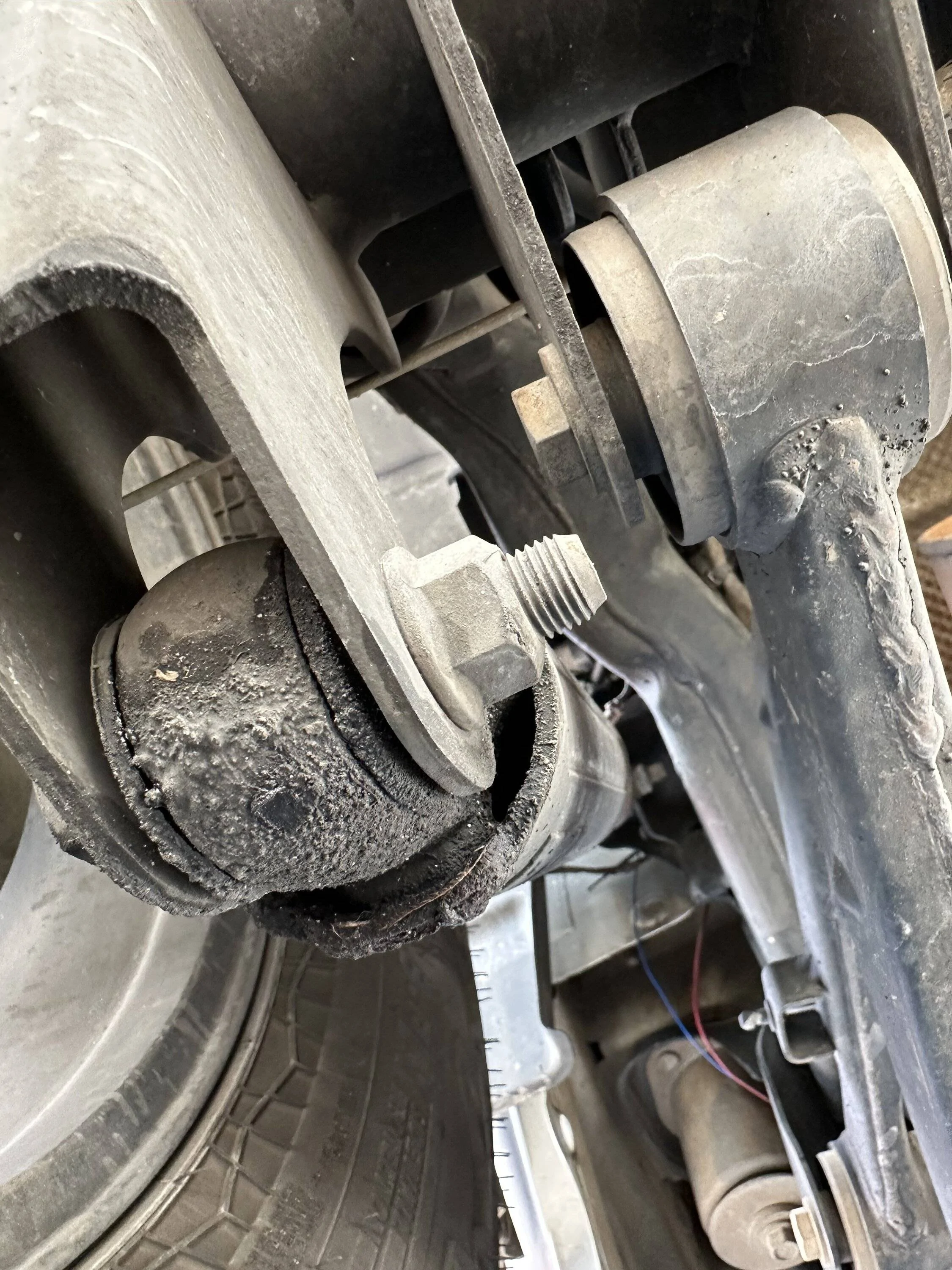

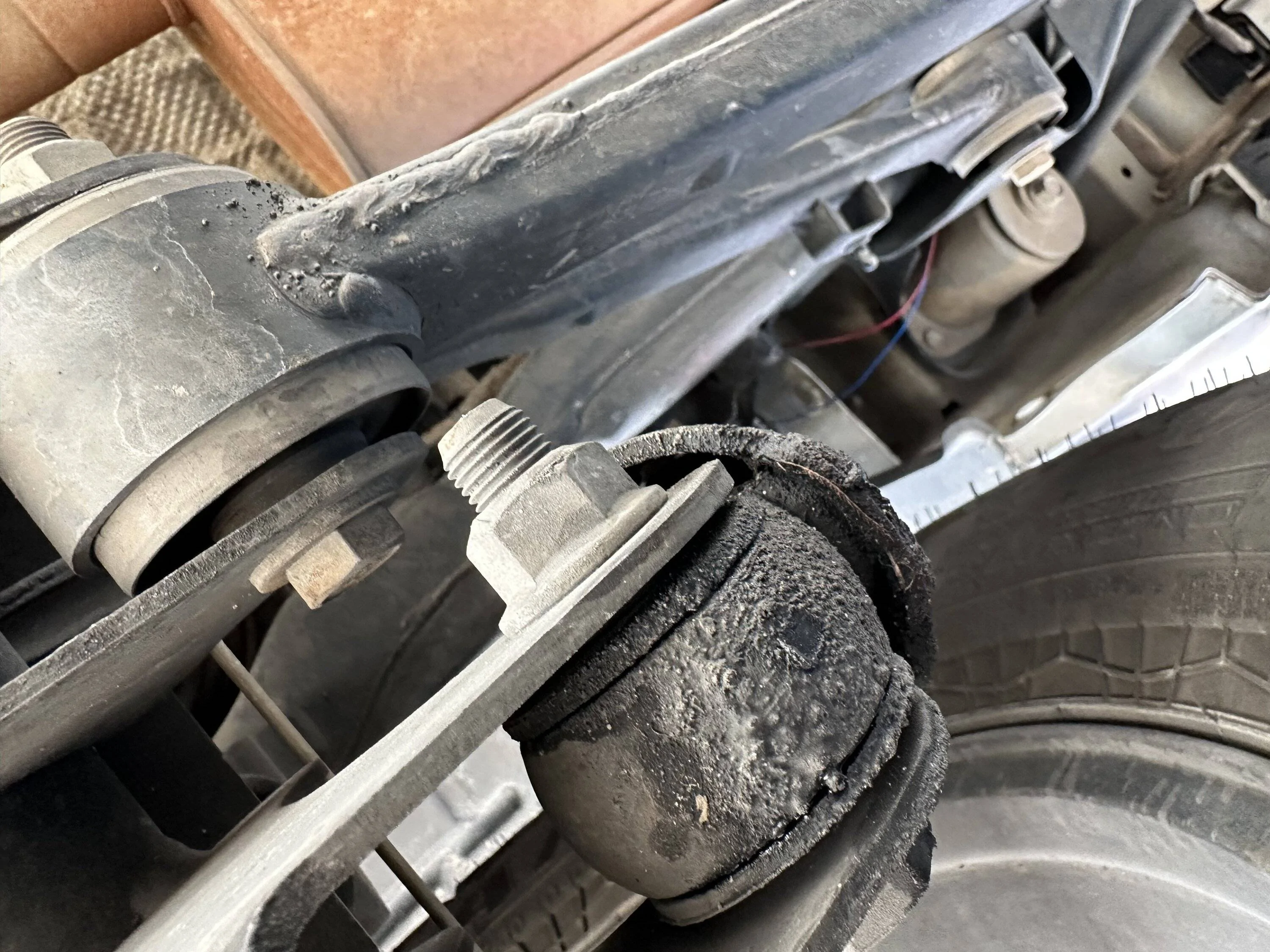

I was under my truck doing some work and I noticed a lot of gunk on the bottom of my rear drivers side shock. It’s not on the other side. I also have noticed the rear hasn’t felt normal, more clunking and bounce. Is this blown? I like the ride height (stock) but if I need to replace I’d like something less squishy than the rubicon suspension. 77k miles.

The seals are blown, those are junk now.
The OE Fox shocks are junk from the factory, Jeep fired Fox and went to Bilstein. I'm amazed those lasted 77k, mine failed at 30k and some have reported failures as early as 12k miles.

I'd say the seal is gone.
Afterthought; with 77K+ miles, you're due for new shocks anyway.
11,357
30,310
The seal is blown. Replace them with Bilstein 5100. Or I have a full set of take offs with about 20,000 on them. You can have them. just have to pay for shipping.

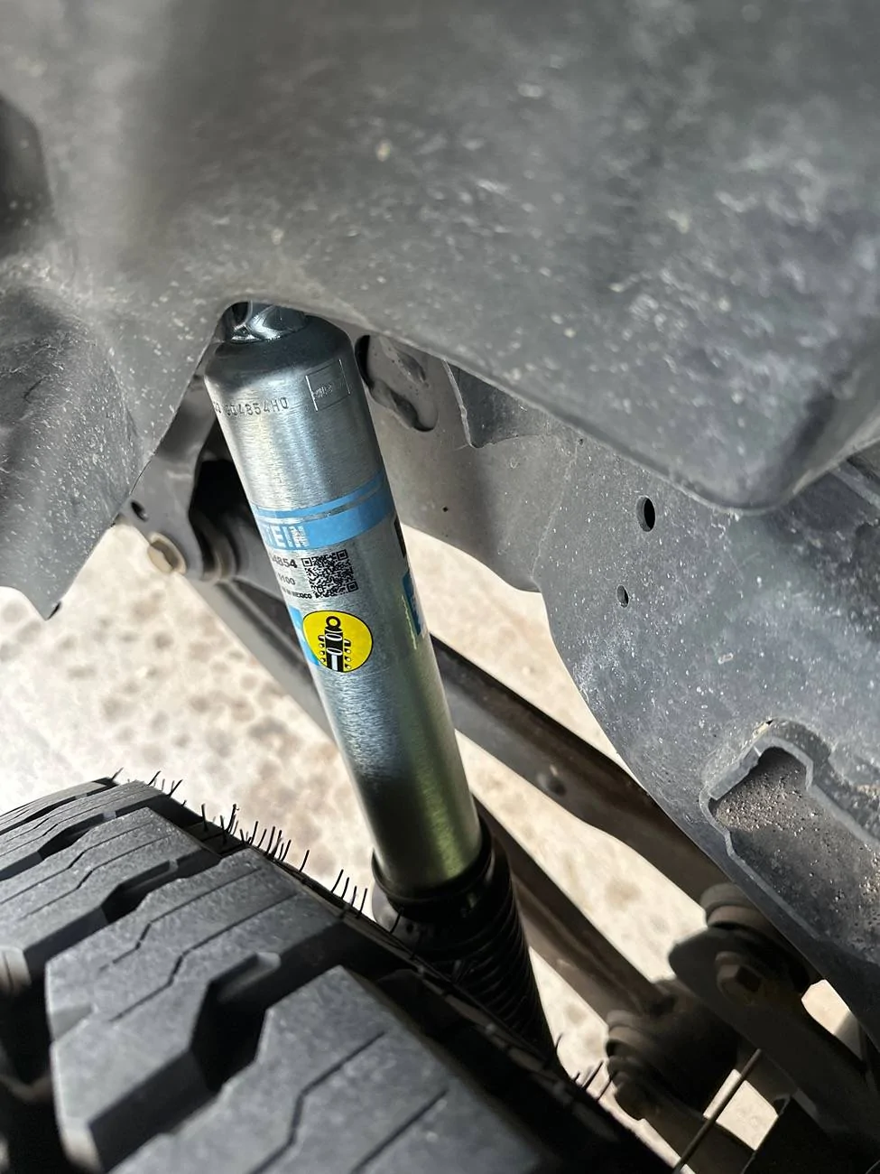

okay, rear Bilstein 5100's on order. everyone is out of the fronts, but the back is what is currently broke. thanks for the recommendations. also snagged the steering damper as well
