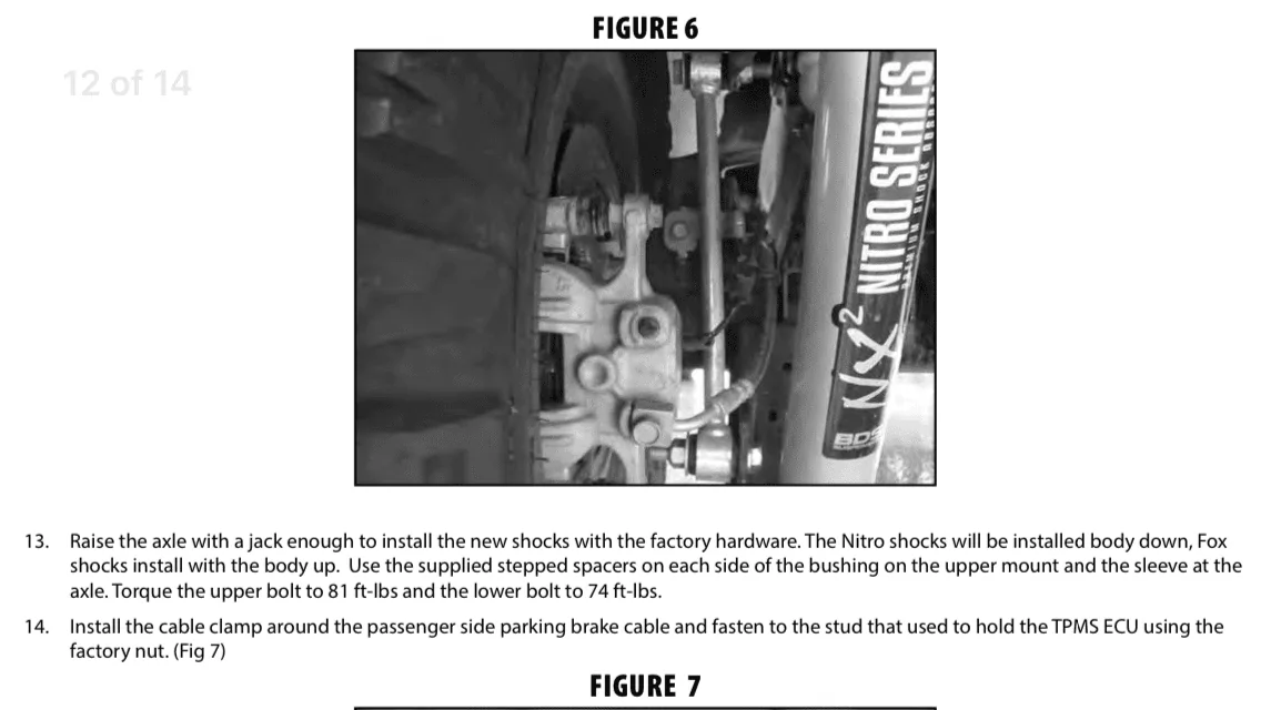

Put on a BDS 2” suspension leveling kit. Does it matter what orientation the rear shock body is mounted? Nothing notated on the instructions

If you’re using their “Nitro” shocks, it’s most likely body down. Here is what their JL instructions say about that.
