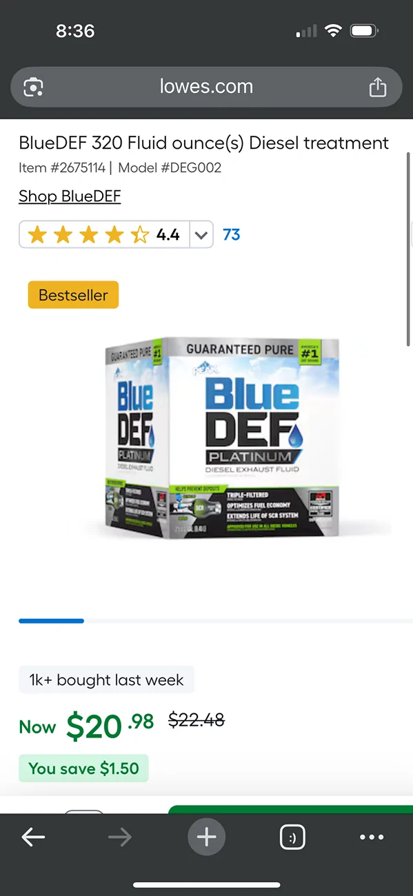

So what’s up with this Blue DEF “Platinum” and why would I wanna pay more for it?
Jeep Gladiator Blue DEF mfg date / exp date? Help IMG_6725
