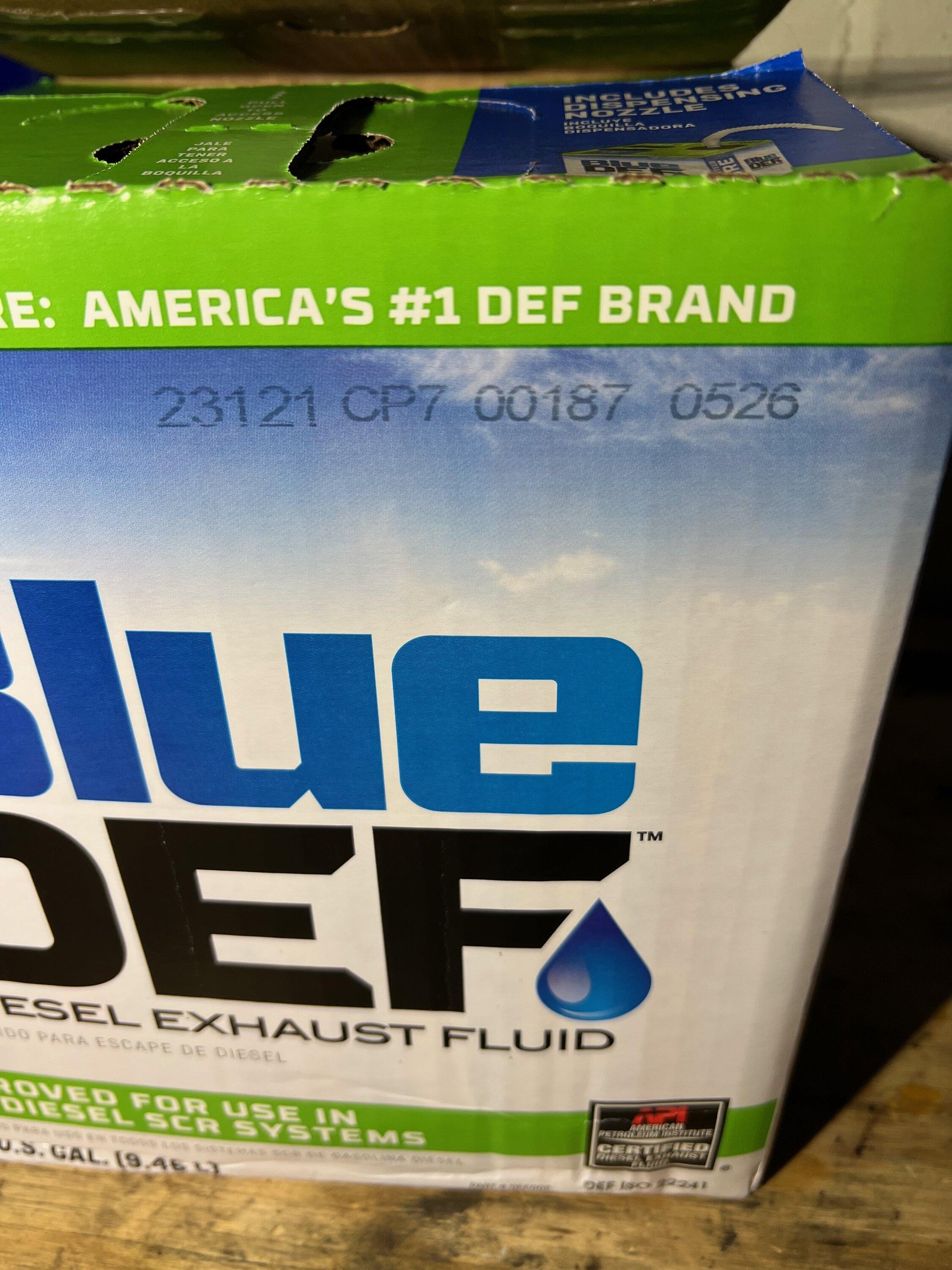

My local Costco had AdBlue DEF on sale for the first time in a while so I picked up a box. However, it seems to have a new type of date code I haven't seen elsewhere. All the other guides to interpreting codes I've seen have a different code format... seems that they may have switched this year. Any ideas?

Some products use “year + 1” as the year designator, then either “day number” or “days remaining” as the day designator.
If that is the case here, date of manufacture is May 1, 2022 or September 1, 2022.
CP7 is the plant code.

The 0526 at the end appears to be the use by date. What else is really needed?
DEF being good for over 3 years would be news to me... everything I've read says within 1 year, or 2 under "ideal conditions." I'd be surprised if it was good longer, at least on the box.
Higher the storage temp. The less lifespan in it.

Is this really an issue? I hadn't checked dates on any of the def I've bought lately.
From what I understand, old DEF can cause all kinds of issues with your emissions system as the urea degrades over time (especially with heat).
