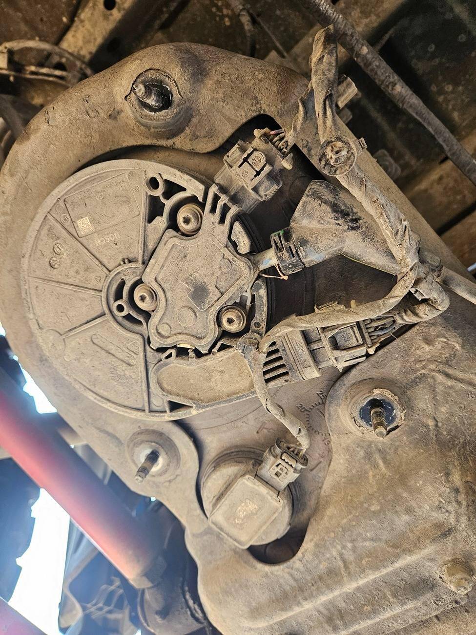

I had a P206D CEL pop up. At the same time, my DEF level went from 1/2 to reading full. This happened after running through some deep water. When U got home. I removed the skid plate under the DEF tank. There is 3 plugs there. I removed each plug a put dielectrical grease in each plug. Thinking that water had gotten into one of the plugs to cause the gauge to read full.
Your other CEL could be from the wiring harness rubbing on the exhaust bracket up by the turbo. It was a common problem with some early Eco's.

I had this and other related DEF codes on my 2022 EcoDiesel. I checked all wiring and found no issues. The ultimate fix was dropping the DEF tank and cleaning it out along with the sensor and sending unit.
Poor quality DEF had crystallized in the tank.
