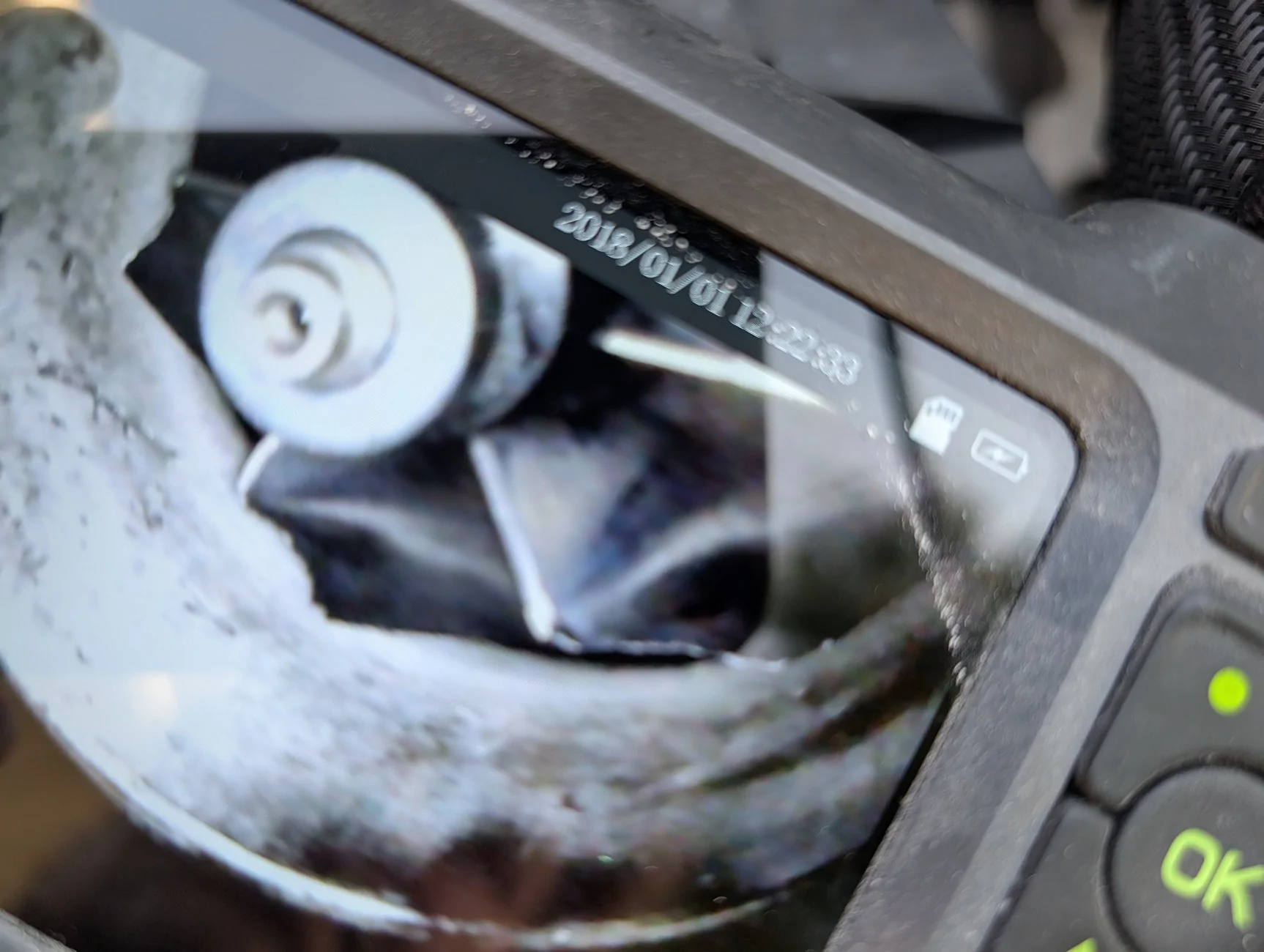

My turbo finally failed catastrophically. I could never get a dealer to dig in and diagnose the issue prior to the failure. I took the Jeep to a new dealer and they are replacing under warranty, I should have the Gladiator back in a week. They are also replacing the engine under warranty due to low compression which was tested from symptoms of coolant loss and erratic overheating.
I'll report on my findings after breaking in the new engine.
Prior to my failure, I noticed a significant increase in P00AF code occurrence.
Photos of the failed turbo below from my borescope. I know the photos suck.

Did you experience loss of power, fuel economy or sluggish engine leading up to the failure? How many cylinders had low compression? What year and how many miles on your vehicle.
Thanks for the feedback and pictures. I saw a post yesterday on the JL Wrangler forum and saw another 2023 Ecodiesel that had the POOAF issue and replaced turbo.

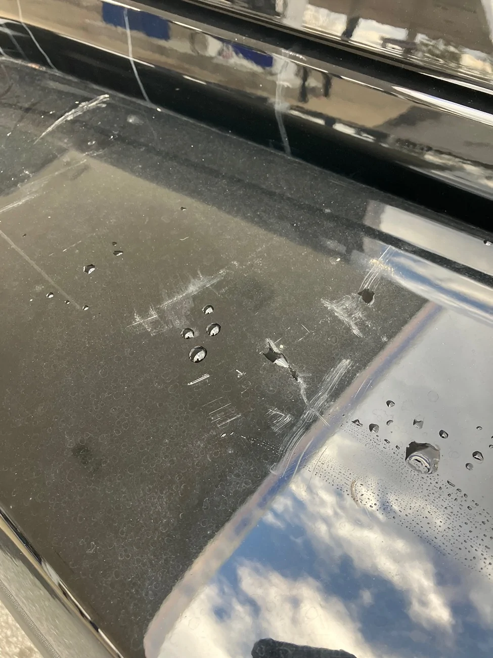

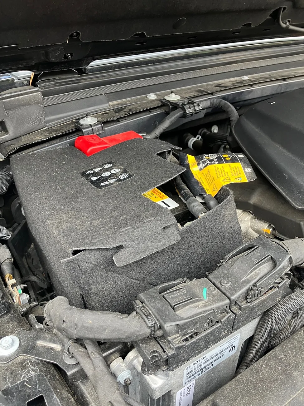

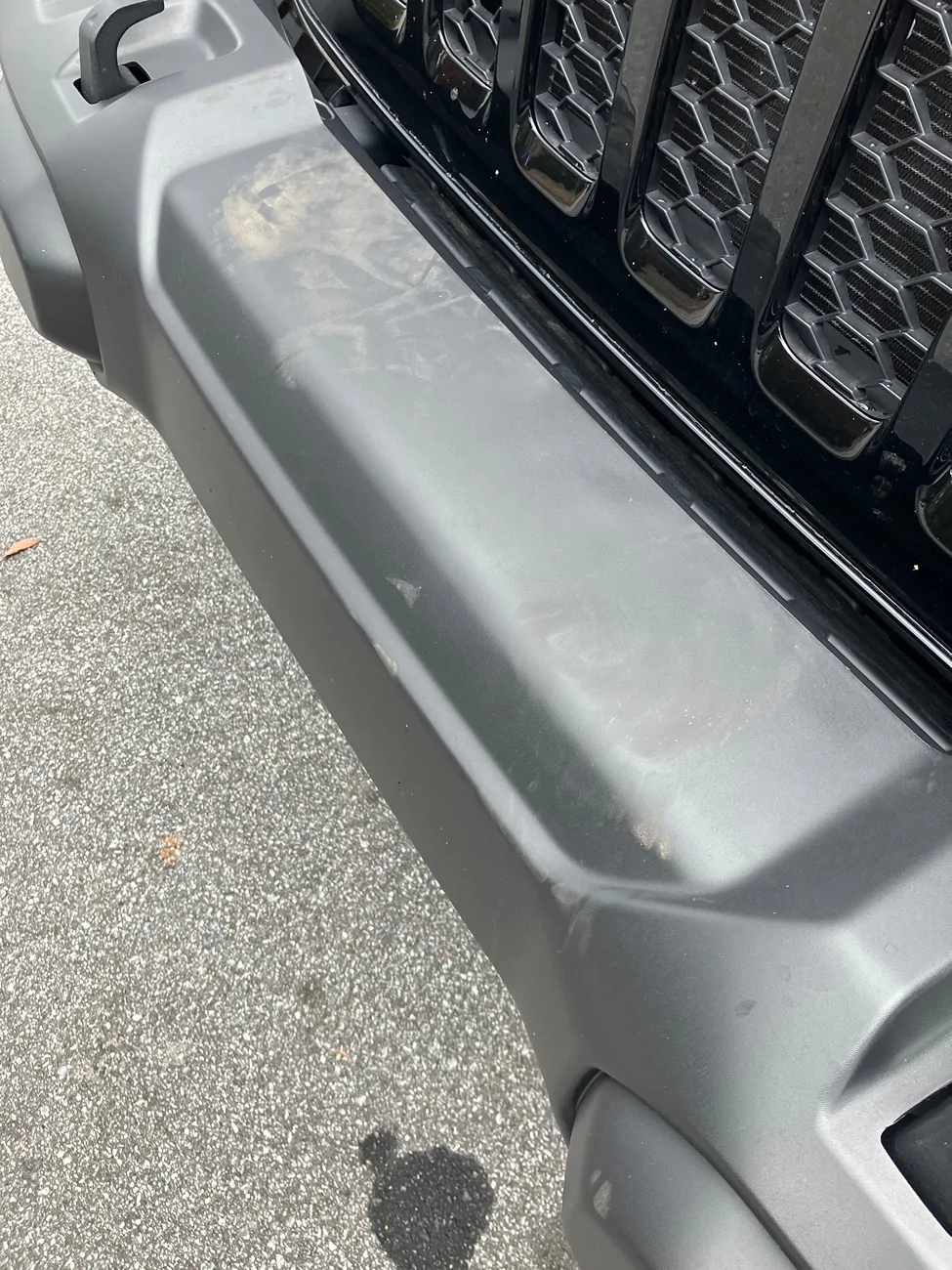

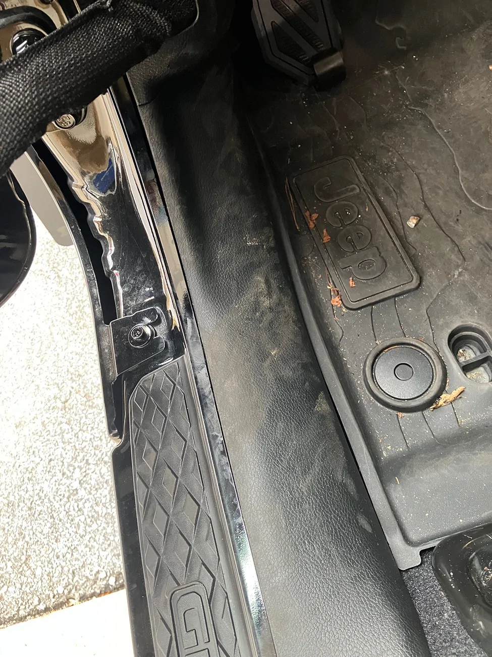

Things continue to trend in the wrong direction. Picked up the Gladiator today and the dealer did not perform any of the steps in the post by DC3 above. In addition the truck looked like it had gone through the gauntlet. The tech evidently used the front bumper as his work platform and not only is it embedded in shop floor grease and grime, but there are actually waves in the bumper from bearing the techs weight. To add insult to injury he used the right fender as a shelf. I can only speculate he used it to hold his tools and parts he removed. The scratches go to the white primer. When he unhooked the battery the felt casing was undone and he forgot to put it back together. Lastly, it looks like a herd of wildebeest got in and out of the driver door. If that wasn’t enough, they did enough test driving to leave me with 10 miles of range. I’m not upset about the whole thing, I’m just real disappointed with the dealer. Not a world ending event but it sure is frustrating. By the way, I got worse fuel mileage on my downhill trip home than my two year average. The cracked pipe they replaced sure helped.
That's a shame, I am sorry you had the shitty experience. On an average basis the Jeep dealers are among the worst I have experienced of any automotive brand. From capability to care to how they treat things/people, they are bottom of the barrel in my humble opinion.
Hopefully you can get some resolve for the damage they did and towards your turbo repair. At least the cracked pipe repair made a difference.
