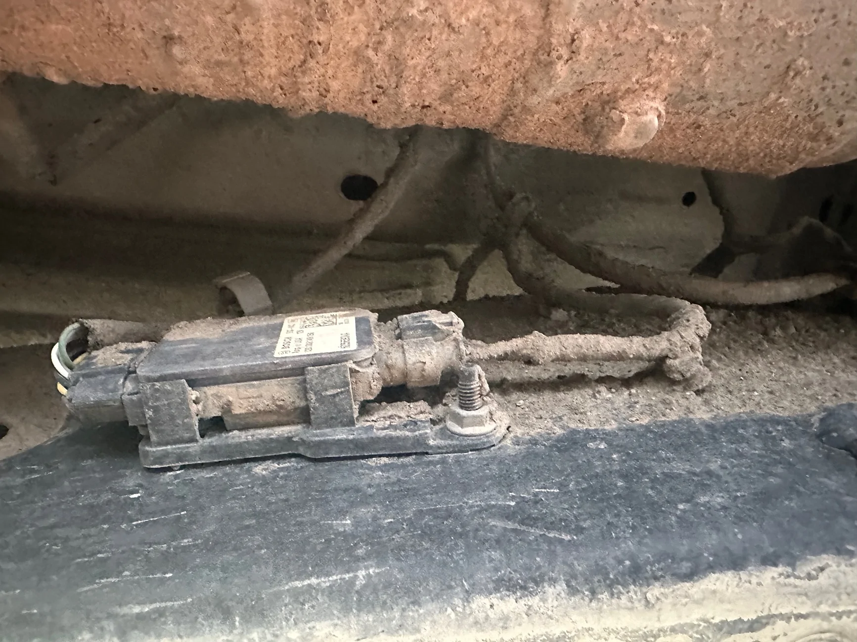

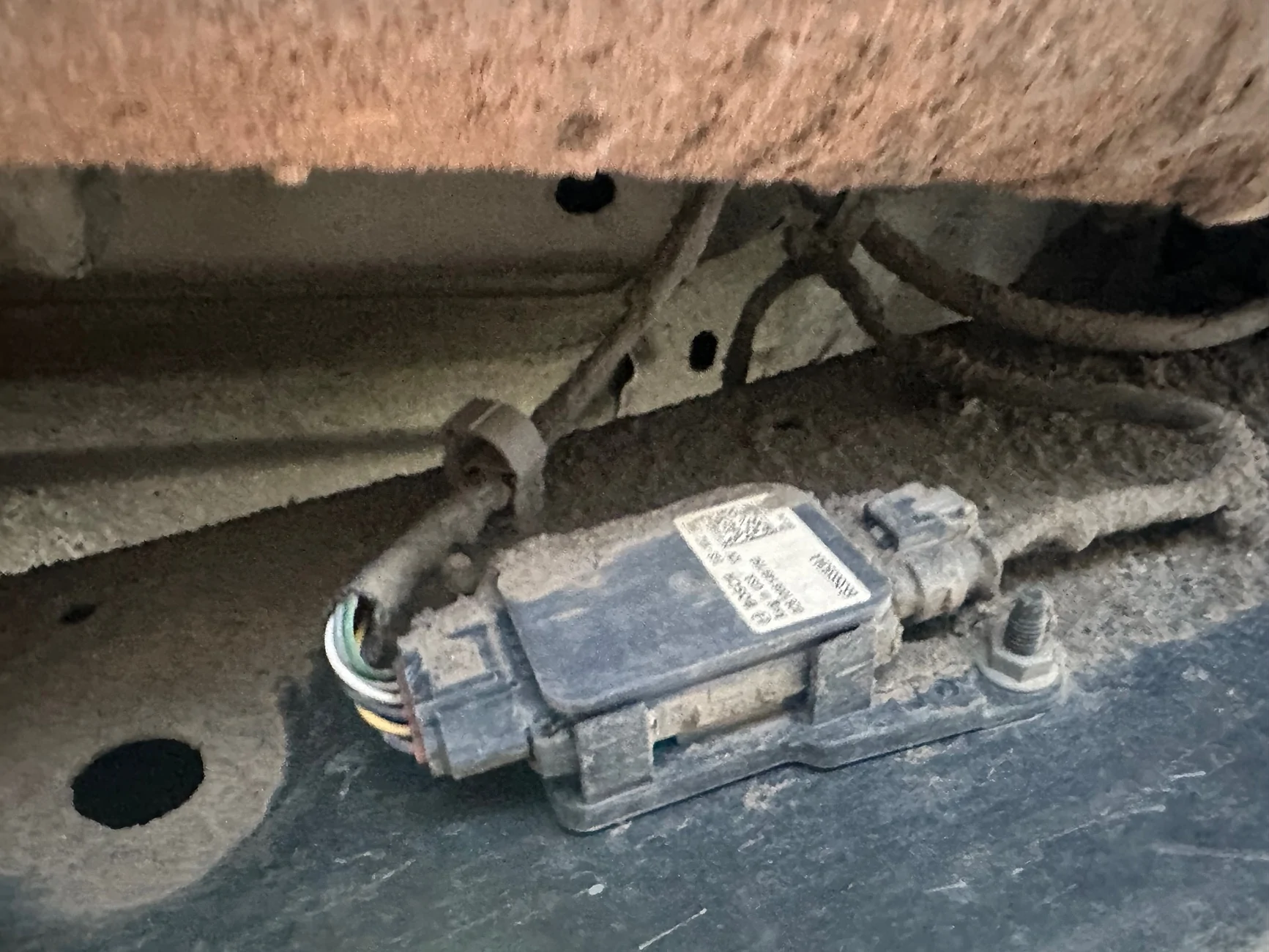

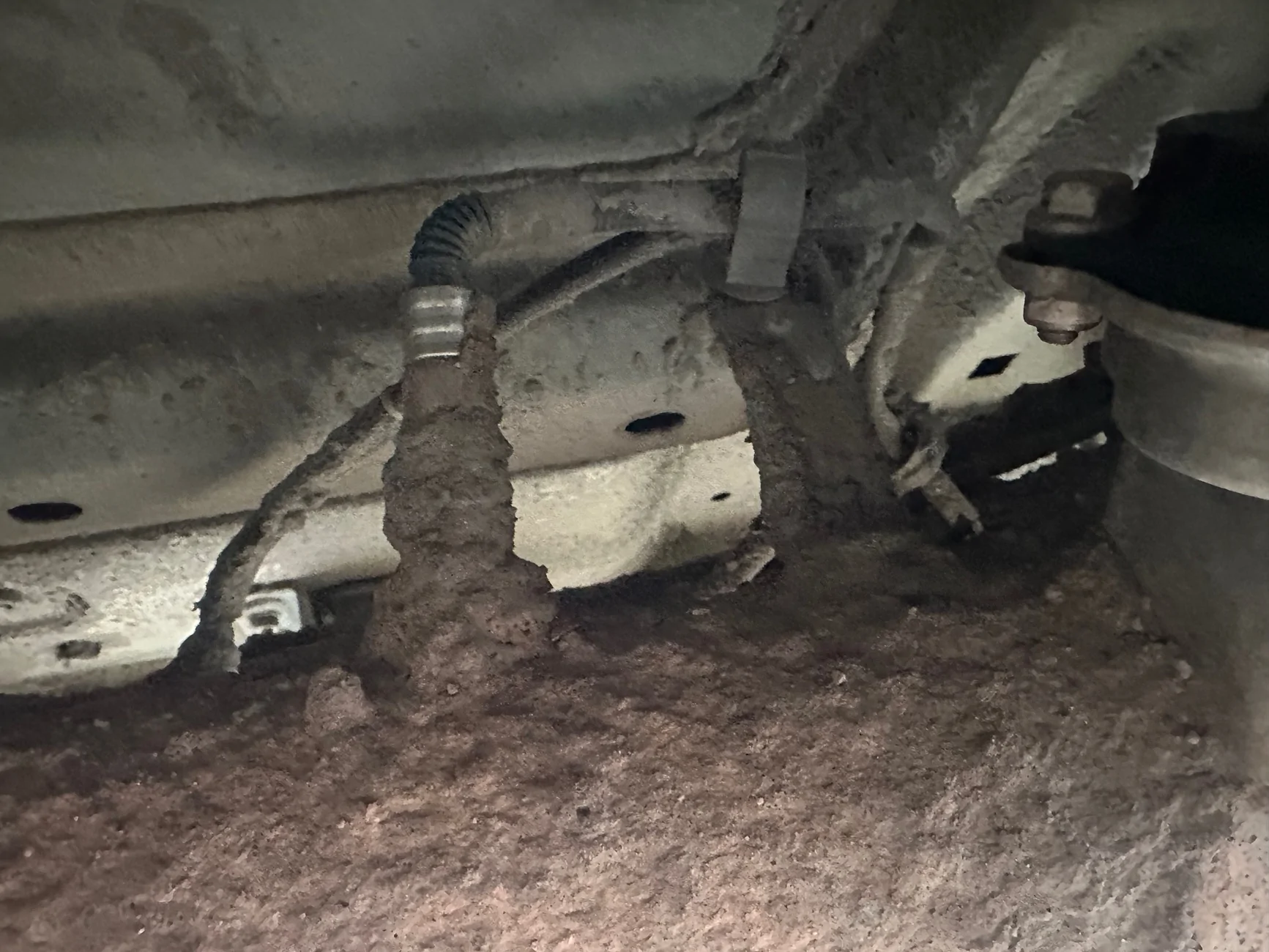

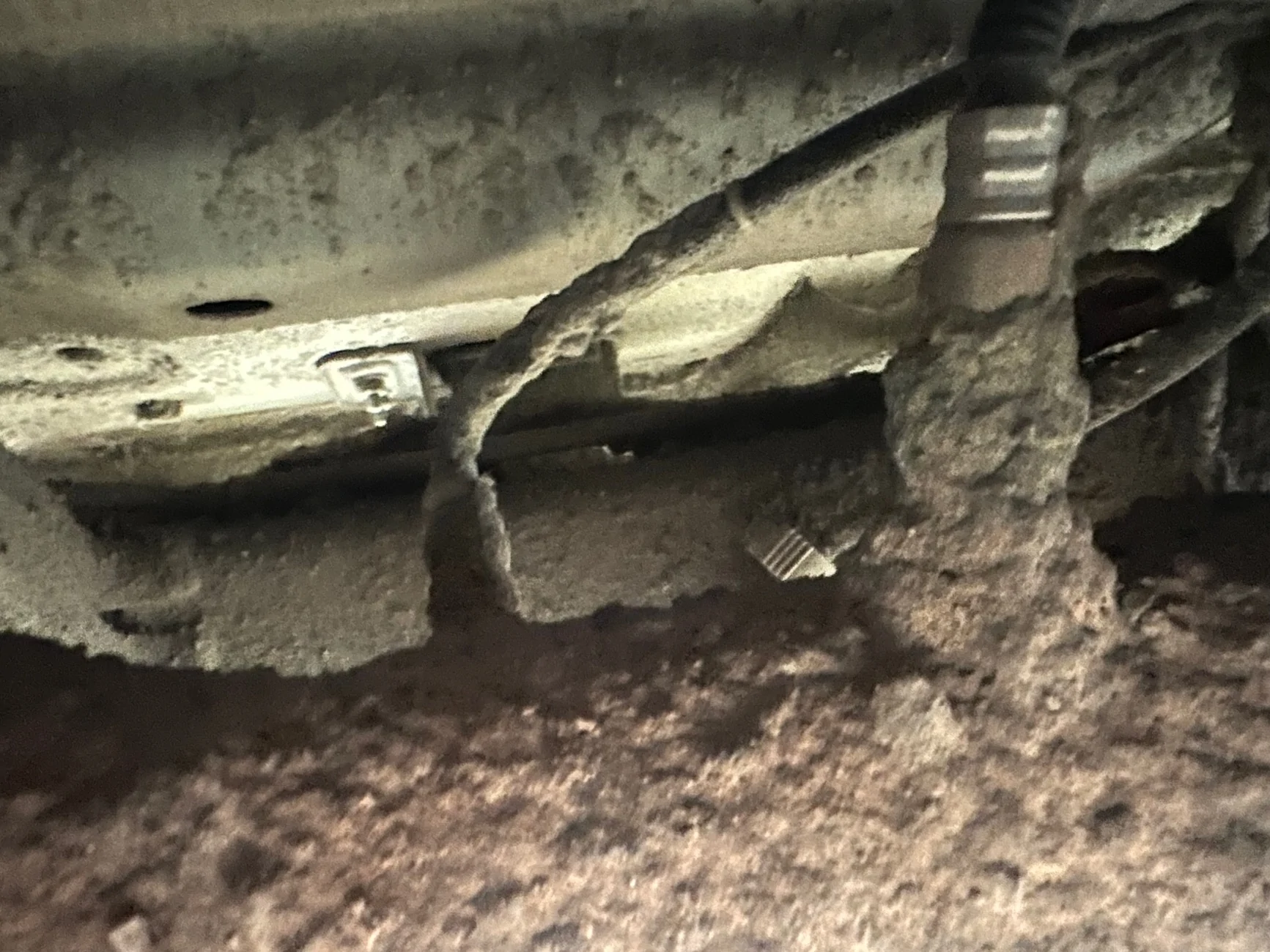

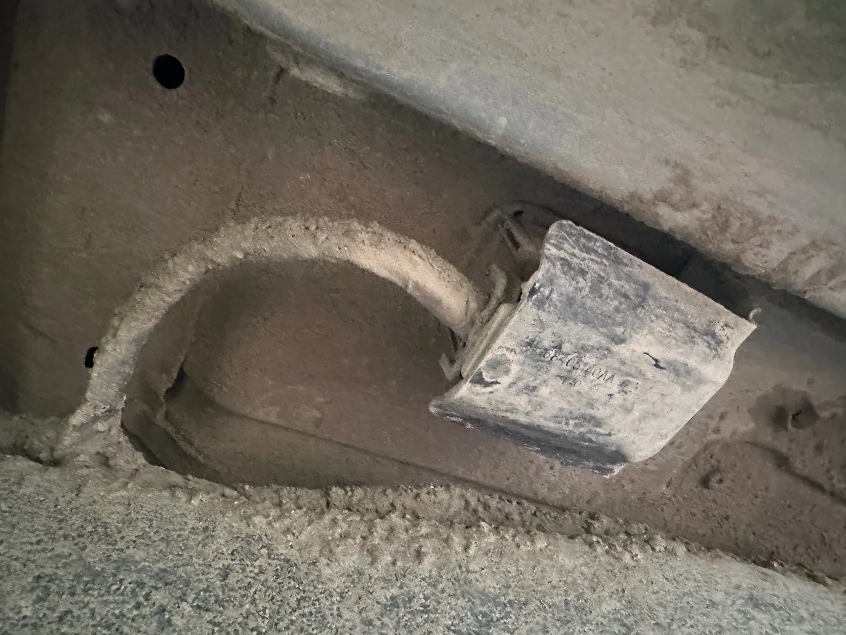

Look at the wiring harness above the DPF and see if it laying on the EGR tube first.
I have run mine at GCVWR on 3.73's A LOT in the mountains and never had the issue you describe, so I doubt 4.56's are going to do much of anything.
I don’t see anything laying on it. Sorry for the bad pics and still have mud from the Dempster sitting on it.
Look farther upstream......like under and forward of the passengers feet. I have also seen harnesses pulled tight up against the heat shielding along the frame/body.
