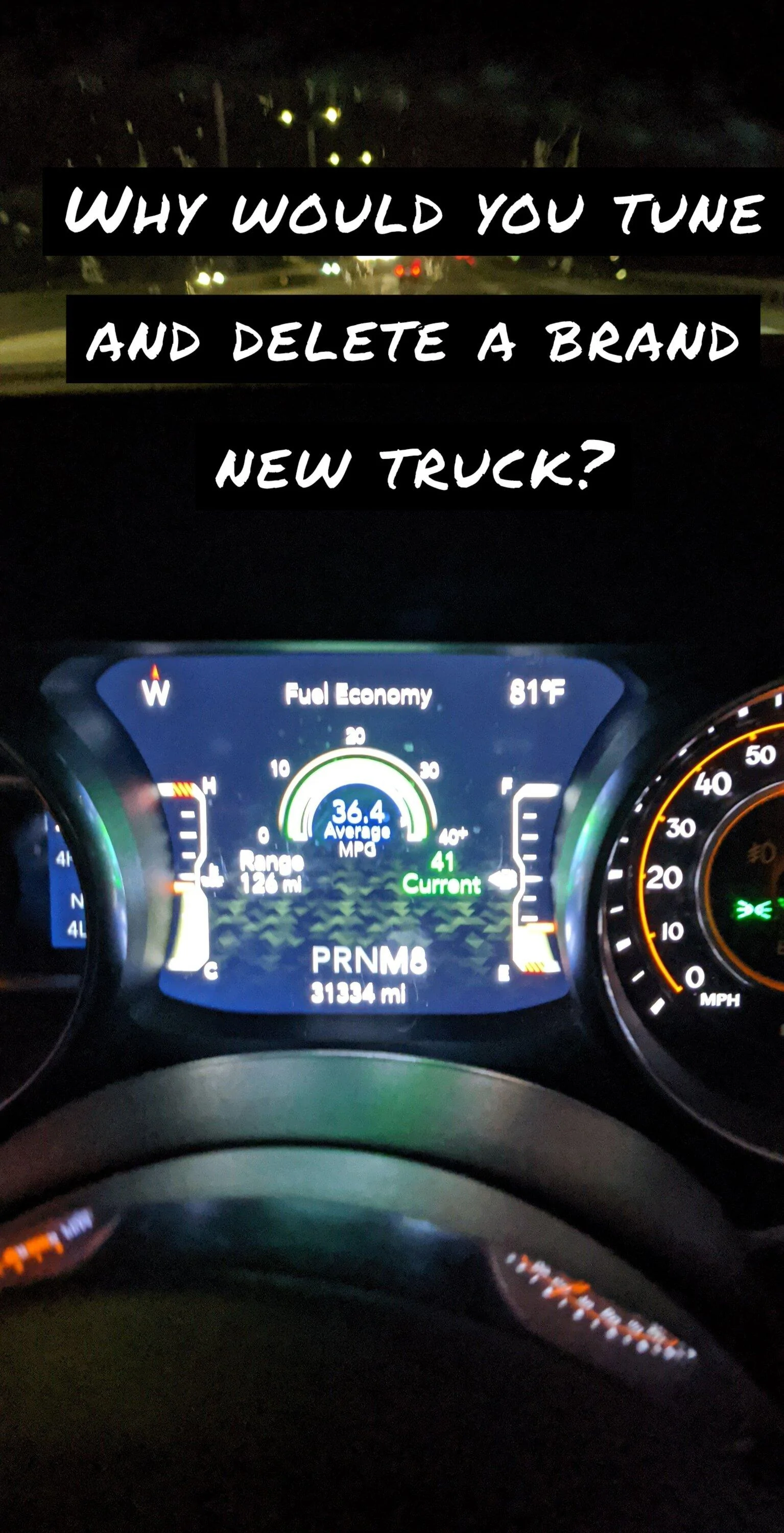

You're gonna have to post some evidence or your claim is (edit) completely ludicrous. (edit)
A 703 mile range on your dash may suffice. And even then, real world hand-calculated numbers never match.
Edit: if you drove 703 miles in a constant downhill at 45-55mph, with a 10+ mph tailwind, you may get your 37 mpg.
BUT, that in no way means: "My truck gets 37 MPG!"
Best i can do you is a snap i could find, been since May since i traveled cross country. Sorry technically ended at 36.4mpg even numbers are just easier. Snap was about Oak Brook area.
Jeep Gladiator Turbo lag? Snapchat-2109530599
And true to the hand calc but the lie-o-meter has been close enough so far. I bothered on my trip to Phoenix but it was always within a mile to the gallon. On my non-highway commute I'm getting around 29-30; i can get a photo of my trip meter later.
