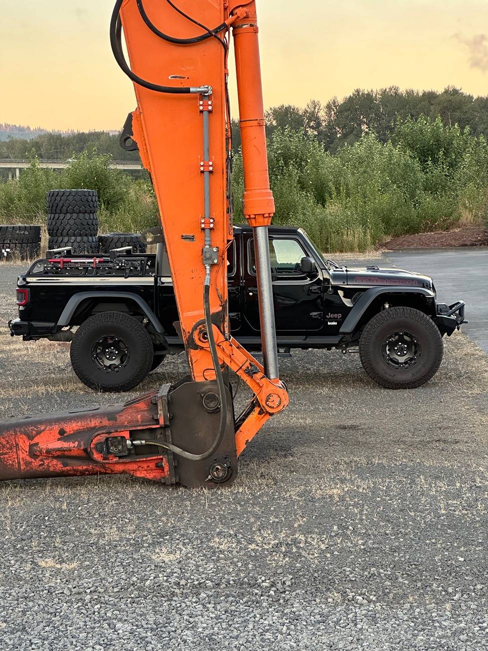

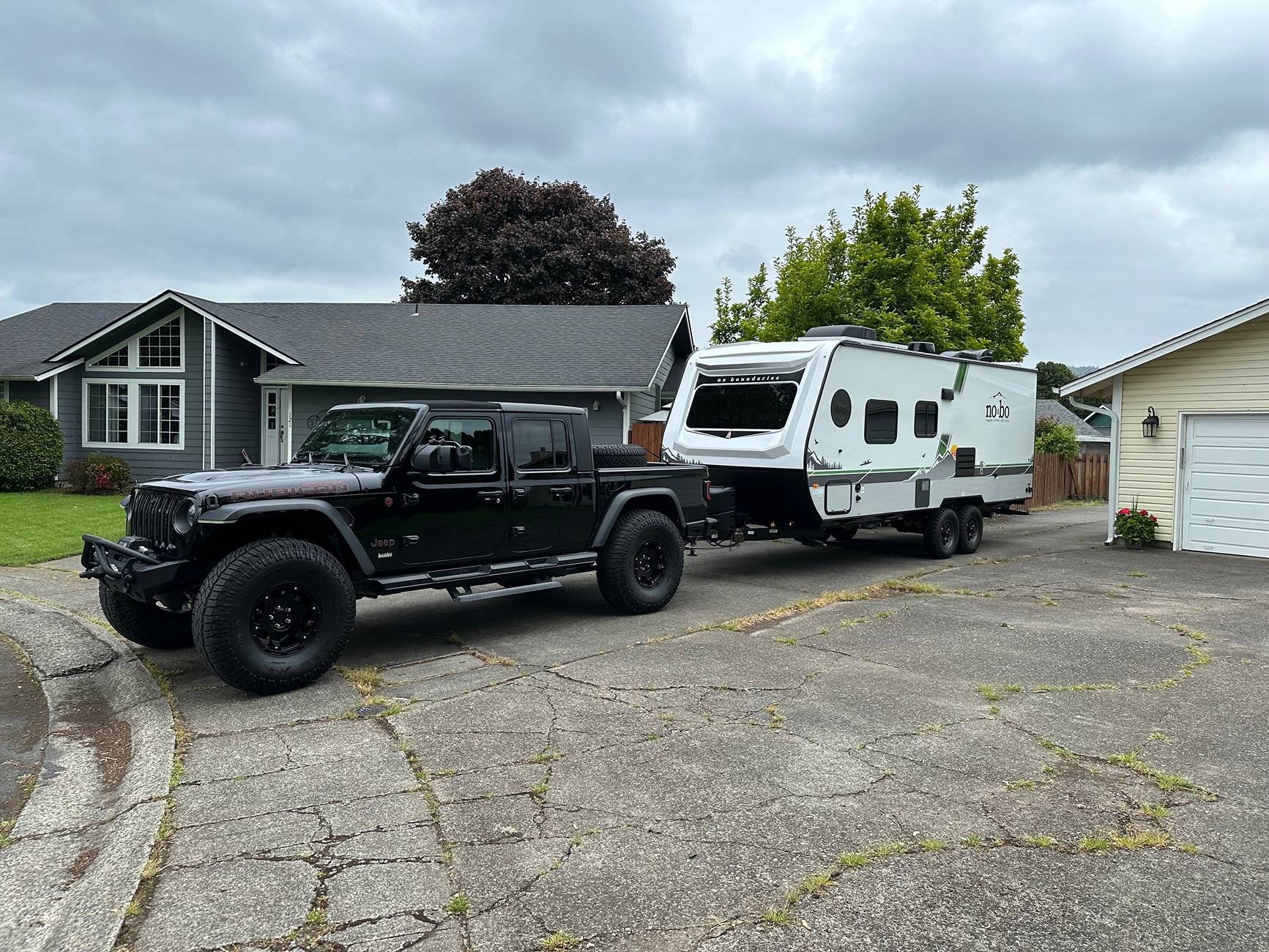

I have Mopar 2” springs,tow 6000 with mine on 40s and it does great. The “turbo lag” is really turbo lag at all, it’s throttle response tuning. The Banks Pedal Monster gets rid of all of delay and more. I traded my 3.6 JTR on 37s for the JTRD and while I loved the torque once moving, the throttle lag was horrible. I ordered the Banks Pedal Monster and Derringer, when they arrived I initially only had time to install the Pedal Monster and ran it that way for a week, the difference was night and day. The Derringer helps and is noticeable but the Pedal Monster is a game changer.
