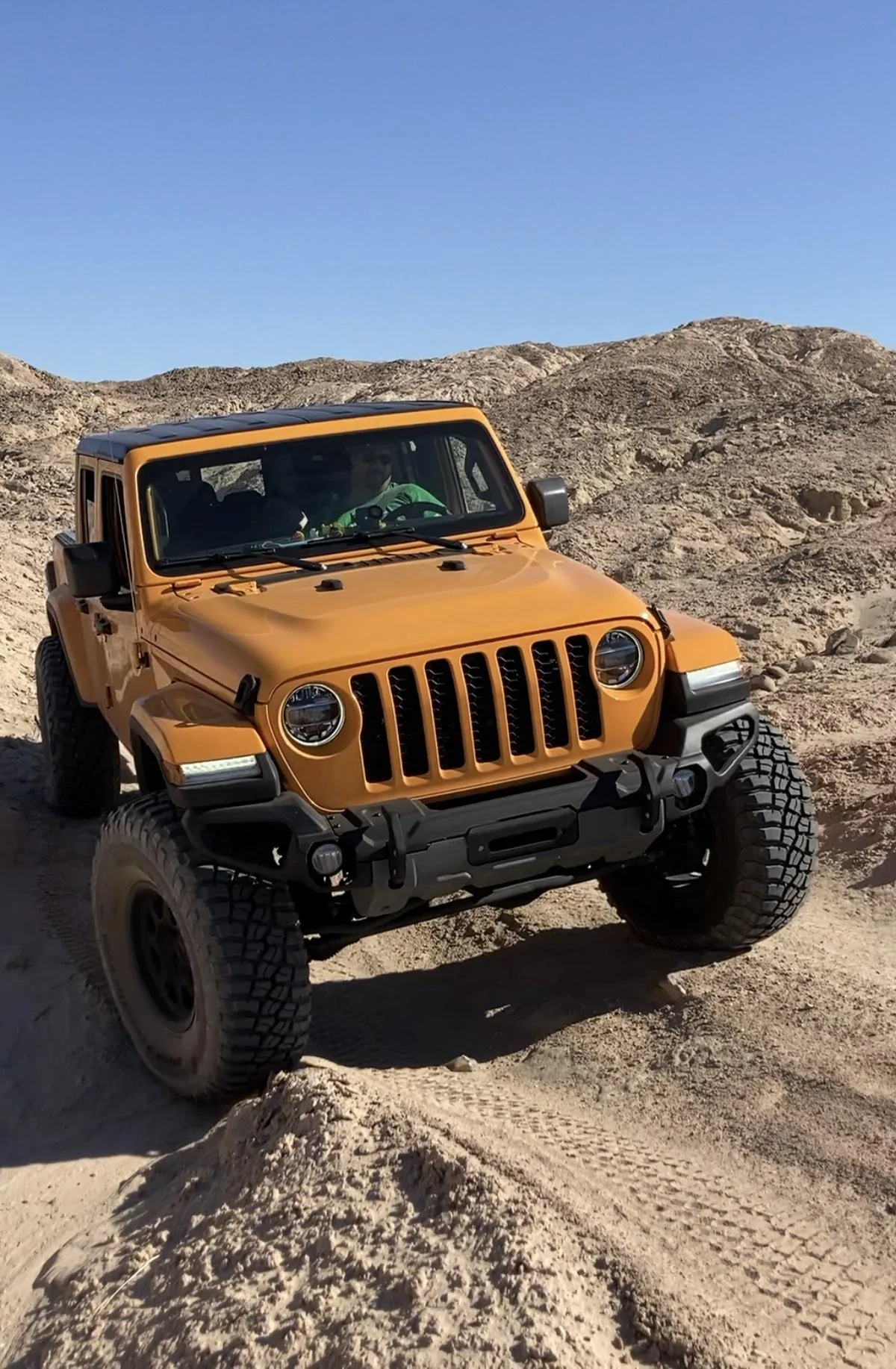

I was think about going with the ARB Deluxe Classic.
Jeep Gladiator Can the Bumper and Winch Cause Overheating? 3.0L EcoDiesel 1644011195717

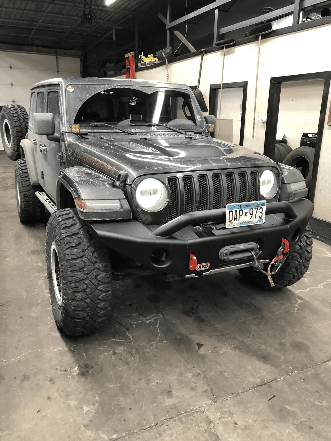

Or the ARB Bondi Deluxe.
Jeep Gladiator Can the Bumper and Winch Cause Overheating? 3.0L EcoDiesel 1644011302559

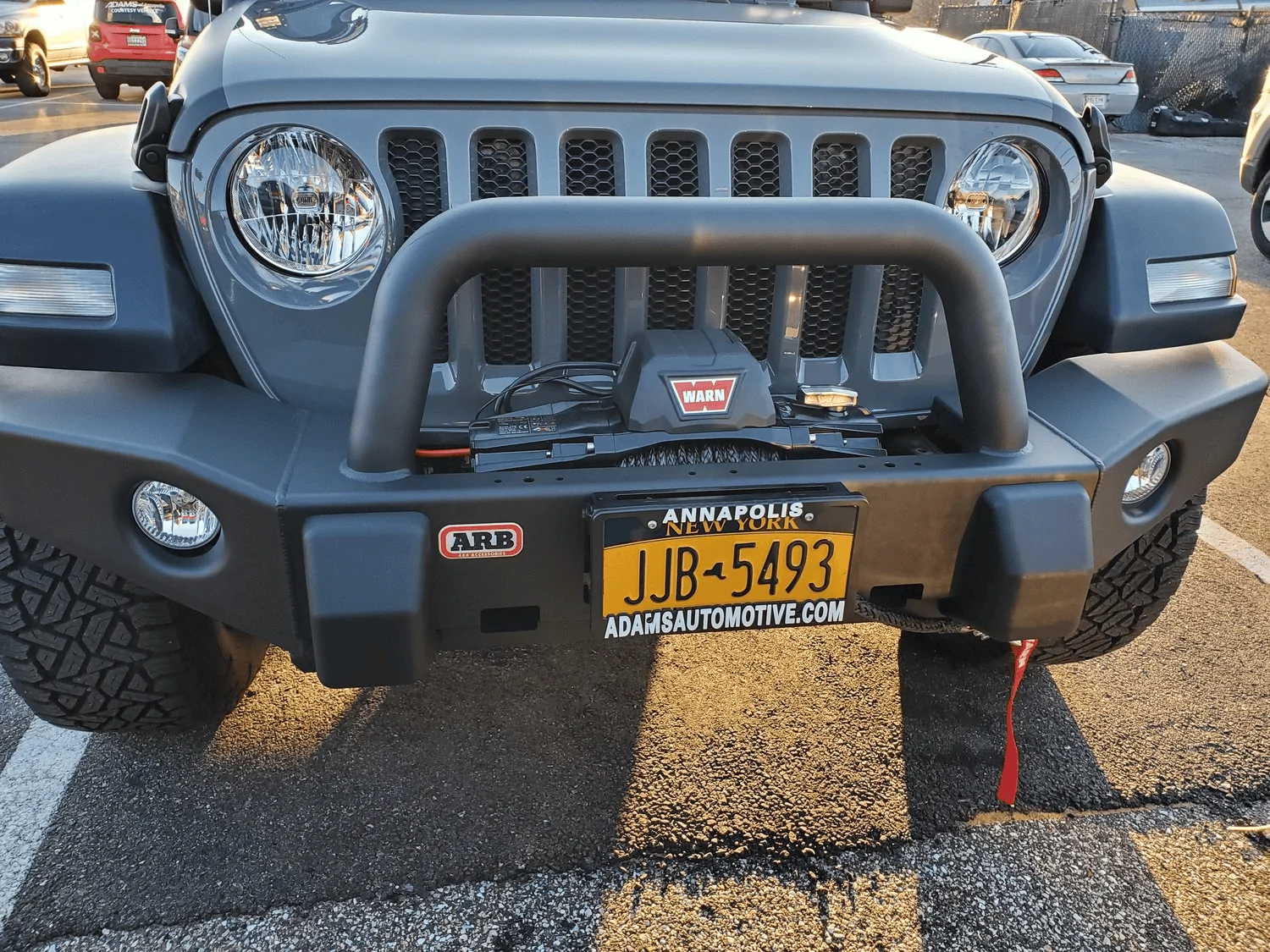

AEV has surely built hundreds of diesels by now. Have you called them?
I don’t experience any of the heat complaints that exist on here and I’m in Arizona a lot.
Jeep Gladiator Can the Bumper and Winch Cause Overheating? 3.0L EcoDiesel 3AA8A750-D32F-491D-A92A-561111804CA1

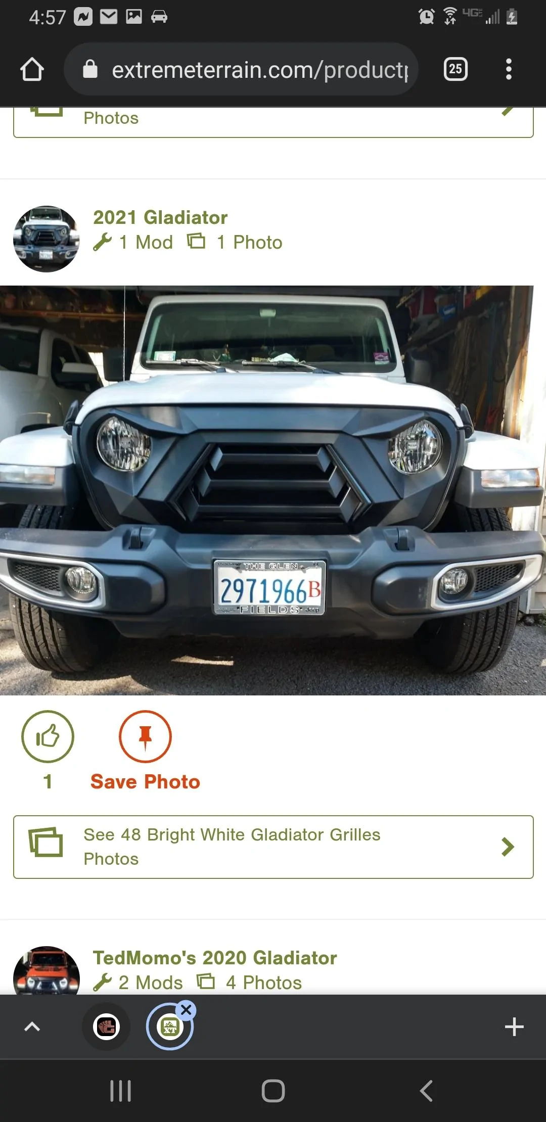

I have a 2021 diesel gladiator and want to change the grill and some say for 2020 and 2021 but I found on a site said wouldn't fit the diesel one. Is there a difference between gas and diesel grille. I found on a site that has diesel ones and there open more ill try and post pic this one says for diesel and its got wide slots do you think it will get enough air
Jeep Gladiator Can the Bumper and Winch Cause Overheating? 3.0L EcoDiesel Screenshot_20220323-165725_Chrom
I am not sure if there is a difference or not. I know there is a difference between JT grill and the JL grill...

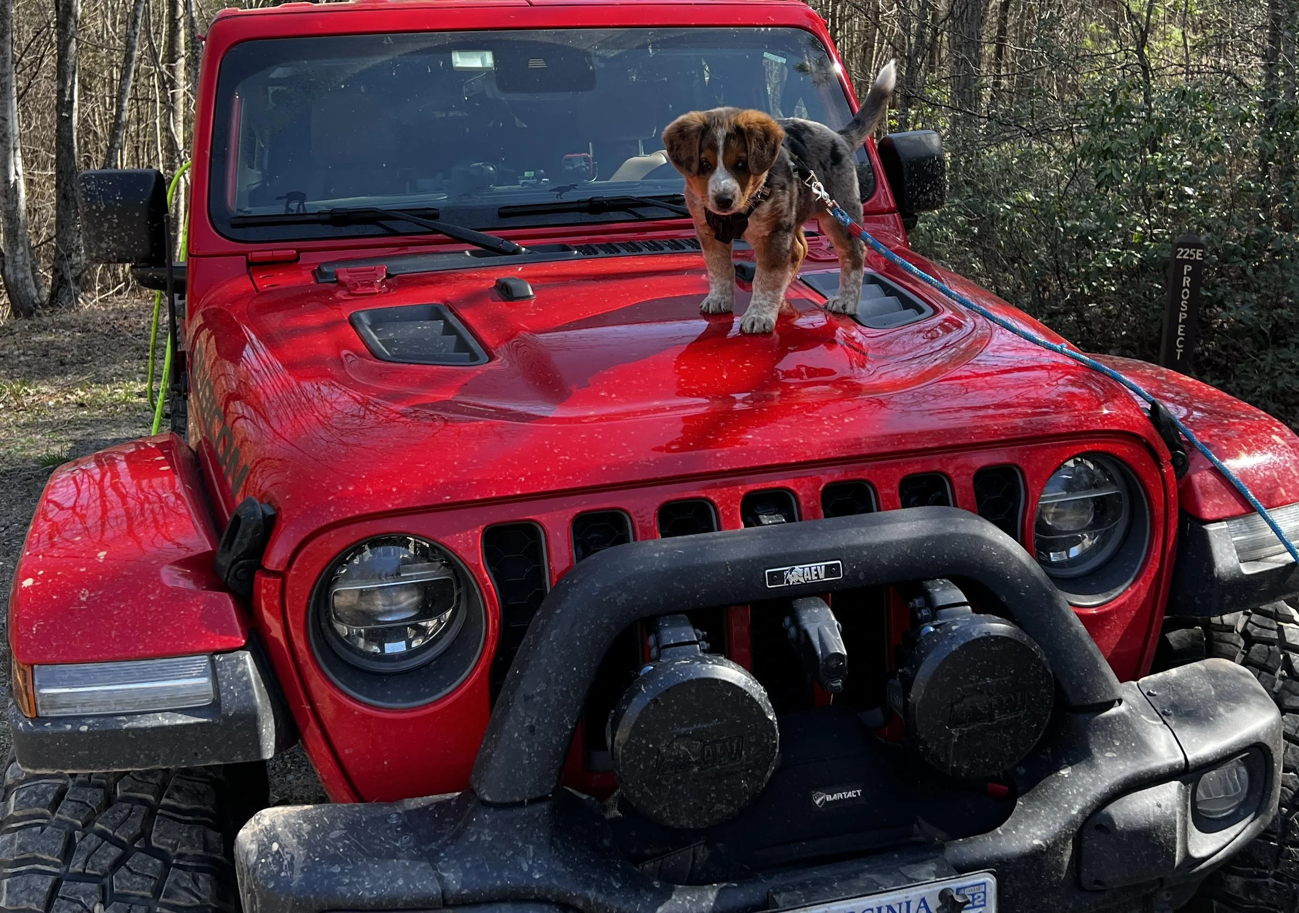

I have this bumper, winch, lights combo on my diesel. (The cattle dog really blocks the airflow. Thankfully, he fell off once I hit the interstate)
Jeep Gladiator Can the Bumper and Winch Cause Overheating? 3.0L EcoDiesel 231F9586-7D73-48A5-892B-D89BFF9EFFD8
I’ve noticed no change in temps. The stock suspension sags if a gnat farts on the hood.
I think it's largely location dependent because I see much higher temps here in AZ than I did in VA with the heat and actual mountains.

I definitely saw a difference towing after installing my ARB bumper and lights. With the diesel de-rating issues I'm not sure that's something I'd play with. There's too many good stubby bumpers out there with hidden winches for way less money.
