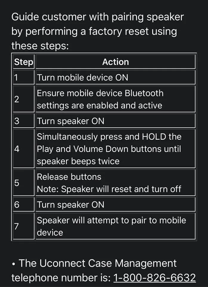

Is the speaker supposed to transmit the audio from the uconnect system in the truck? I can't figure out how to pair it with the vehicle as an auxiliary speaker. The whole reason I bought it was because I thought I could uselay the satellite radio from the truck at my campsite 20' away.
If it's only intended to pair to my phone it's kind of a bust. I've got a much cheaper Bluetooth speaker that. I don't have any cell signal when I'm off the grid so satellite radio is my favorite way to listen to music.
I feel exactly the same way: pairing to a phone is a bust.

Mine pairs with no issues, but seems like very 3rd/4th time, I need to reset it.

Mine pairs with the phone every time. I have paired it to a Fire stick too, worked. I think if you turn the power on by holding the power button solid for a few seconds it will almost always power on.

No issues pairing with my iPhones either. Works great.

Yup, worked for me too - and I even had it paired previously to the same phone. Thank you for posting this!

Could pair speaker with my phone no problem, but not my laptop as it didn't see the speaker (strange). Did the reset and laptop paired.
Thanks for the fix!

I've never had an issue pairing until my wife upgraded to a Pixel 7. The phone will not discover the speaker. We have reset both and no change. As the phone will pair with Uconnect I'm not sure if the problem is the phone or the speaker.
