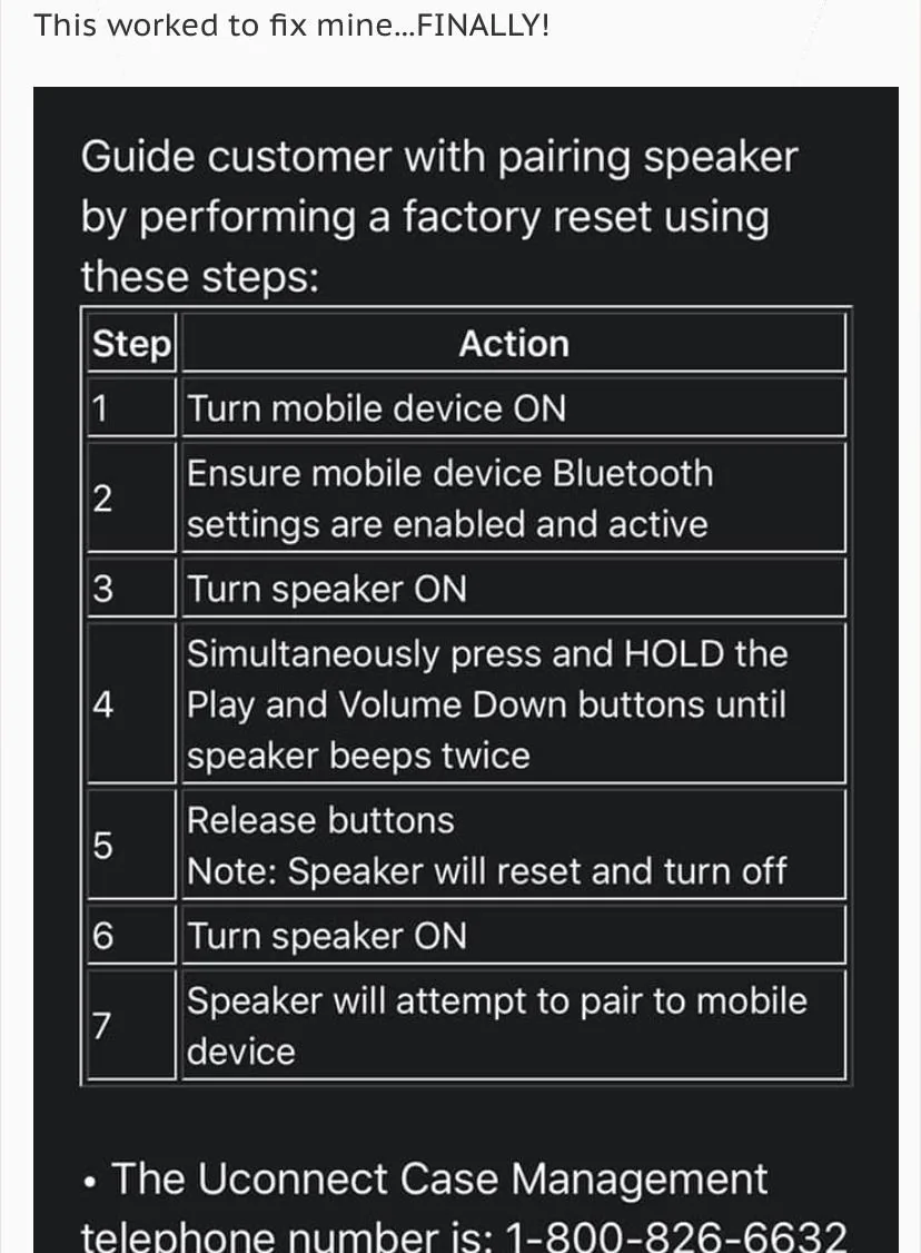

Once you get it working you might need to do this. These speakers can only sync to one phone then you have to do a hard reset to sync another one. Happened to me when I got a new phone and tried to hook it up. Best of luck
Jeep Gladiator Bluetooth speaker won't turn on. C149D75A-201C-48AC-BEA0-A2D35E055B20
And I'll be sure to save that picture somewhere easy to find.
