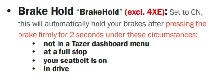

Does the Tazer have a function that does this? I took my Jeep into a shop for a suspension test inspection to diagnose some bump or wobbly feels and they mentioned an ABS issue. When they stepped on the brake pedal at a stoplight the lights would flash. I knew this happened but I thought it was a Jeep thing or a mod through the Tazer.
basically you stop as normal at a light or construction thing then push the brake pedal a bit harder and it ā€œholdsā€ the brake for an unlimited amount of time. Kind of like hill start assist stuff but it doesn’t matter whether there is an incline or not. To turn off just push the gas and it releases. Shop didn’t know anything about it. I discovered it one day by accident. Should I be concerned or just enjoy it?

Yes, the warning lights will flash. That is normal function of the Tazer BREAK HOLD.
I've emailed ZAutomotive years ago if they can program out the warning lights but they can not.

Yes, it's a Tazer live function. If I remember right, when it was first introduced in a beta, it defaulted to on and confused a whole lotta people (IMNHO, people who don't RTFM should not install beta software), so later releases defaulted it to off.

Ok so it’s working as it’s supposed to then. Tazer was on the Jeep when I bought it so still learning the functions. I’ll see if there’s an online manual for it. I did figure out the light show function by accident!! :like:

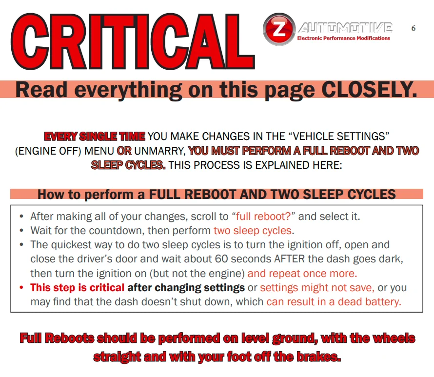

Instructions are here:
http://www.zautomotive.com/instructions/z_tzr_jlm
Read this part carefully. Then read it again. It's not a suggestion; failure to follow this part is the reason for probably 95% of the Tazer complaints people post here. Also, since you bought it used, you should probably check to make sure the firmware is up to date, and update it if it's not.
The manual is absolutely horrible… FYI šŸ™„
I ended up re-writing my own ā€˜notes’ because some of the stuff isn’t clear.
If you don’t do something right, the Tazer could give you all sorts of issues.
Love the devices features, hate it's documentation and usability. It's so comically unintuitive that I sometimes think it must be intentional. As some sort of joke.
FWIW, I also am not entirely sure this Brake Hold works on the manual trans either, I feel like I tried it way back when I first got the Tazer and didn't notice a difference.......but, to the point above, I am for sure never gonna be bothered enough to go through the convoluted programming and reboot process just to test that theory.
