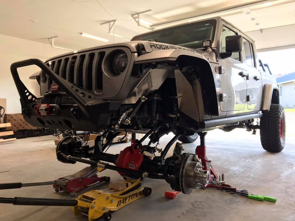

I look forward to you letting us know when you’ve done this. When will it be done and who you gonna have do it? You gonna do the High speed offroad suspensionntoo?
The work has started. Hope to be back on all 4 by the end of the year.

You're building this...
in your garage? HA HA HA

lol, funny. It may look like a garage to you but it is indeed my shop that we just finished building. Also, I have built quite a few rigs including 2 race Jeeps, first being a JK and the 2nd a JL in my garage before the shop was built. As for photoshop, I suck at it. In fact, I paid someone to do the rendering of my current build.
