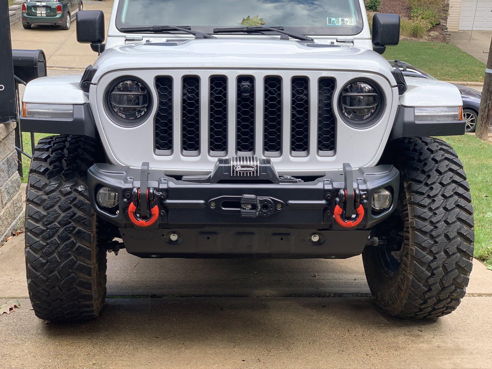

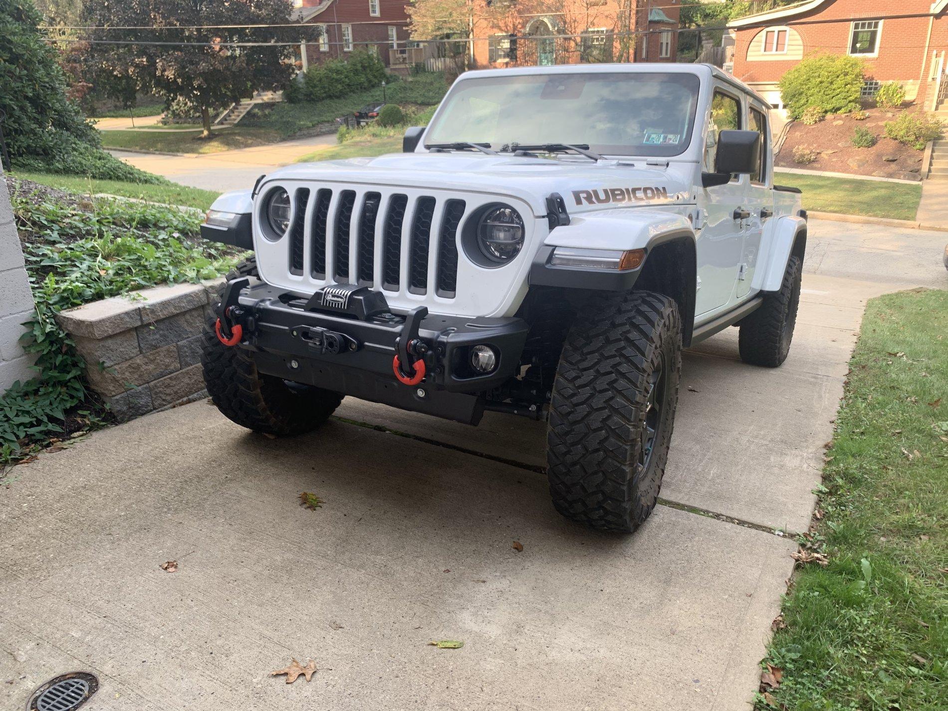

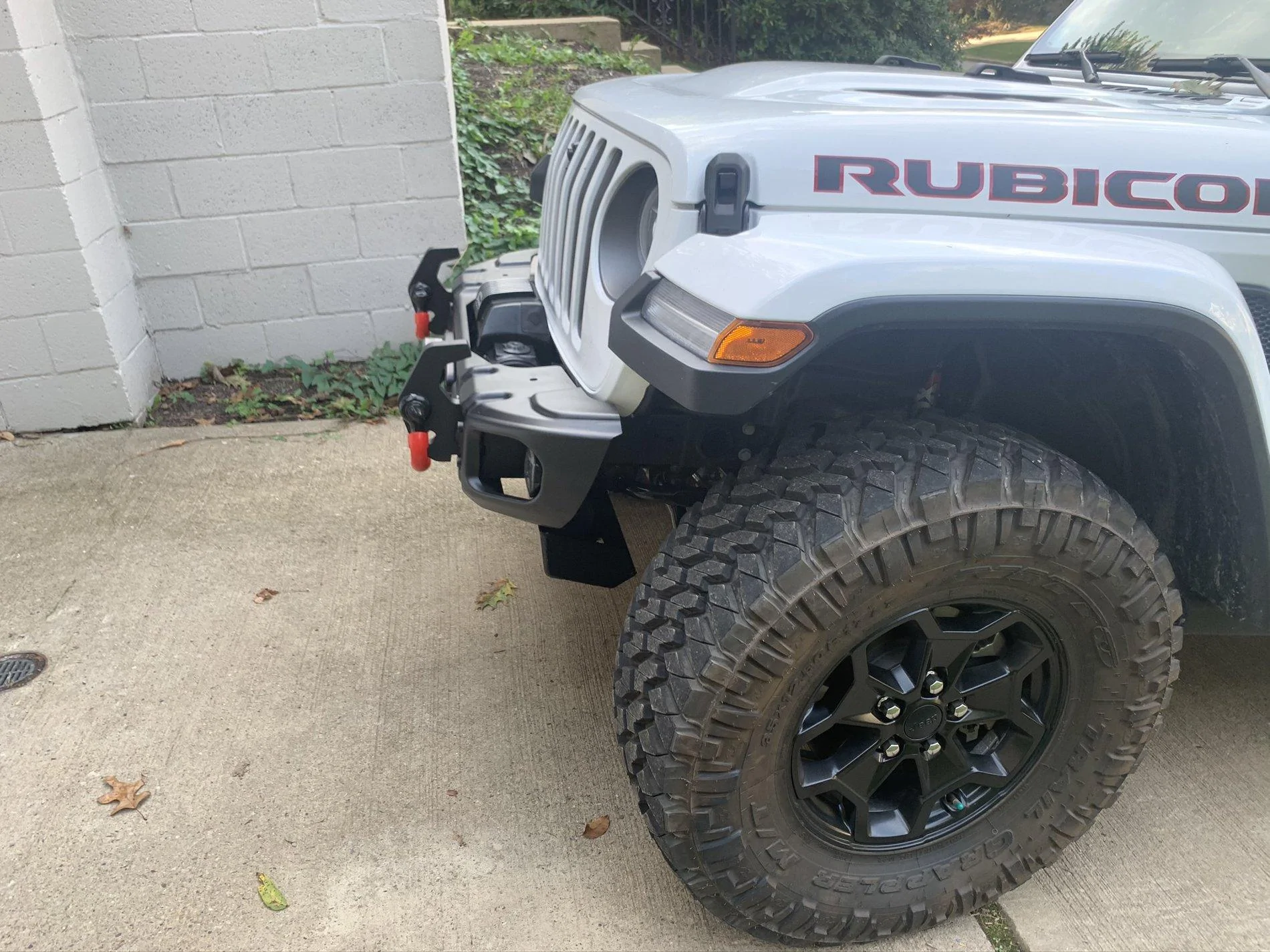

https://www.quadratec.com/p/rugged-...umper-overrider-jeep-wrangler-jl-gladiator-jt

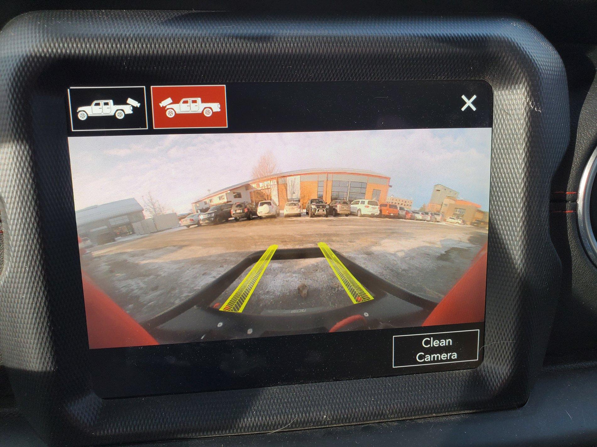

Liking the Rugged Ridge Arcus. Haven’t put the overrider bar on it but it’s the same price with or without it, so I figured I’d keep the option. Works great as it is with the trail cam, I can see the hooks and just enough of the bumper to see where it’s at.
Edit: I’m running the oem plastic rubicon bumper’s LED fog lights in this, the steel bumper’s LED fog lights wouldn’t have fit. It did include instructions for overland and sport fog lights as well.
Took a couple hours to install along with the winch, didn’t need any help but a second set of hands would have been nice. Make sure you put the fairlead in before the winch, it doesn’t tell you to and it’s a pain to get the bolts in after.
Also installed Quadratec’s skid plate and it all fit fine with it.
https://www.quadratec.com/p/quadratec/aluminum-modular-front-sway-bar-skid-plate-jeep-wrangler-jl
Jeep Gladiator BUMPERS! 286721EB-0BA9-46D3-BD85-9D757DA7DAF1
Jeep Gladiator BUMPERS! 8BFFB5D5-B4D5-4CDD-B004-B0E12AF07C5D
Jeep Gladiator BUMPERS! 4159EA94-7FE0-4713-8D38-6AABB79645FD

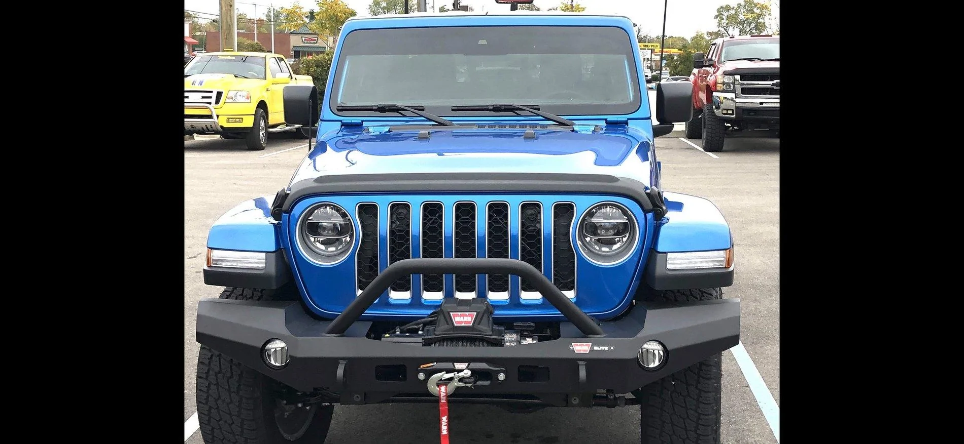

I know some of us are searching hard for the perfect bumper replacement....Could we start a thread of all the bumpers out there that you have personally installed on your gladiator?? Please share a picture labelled sport or rubicon and whether the stock fog lights fit the bumper or not. Thanks!!
Overland- fog lights work-
Warn elite full length steel with bar
Jeep Gladiator BUMPERS! 40FE382B-B13D-475A-965A-DBE51199C9B4
Jeep Gladiator BUMPERS! 4339C262-9551-4392-9BEE-D7FA580FE9FD
Jeep Gladiator BUMPERS! 86BE07B4-CDAD-4A59-85AA-86950756277E

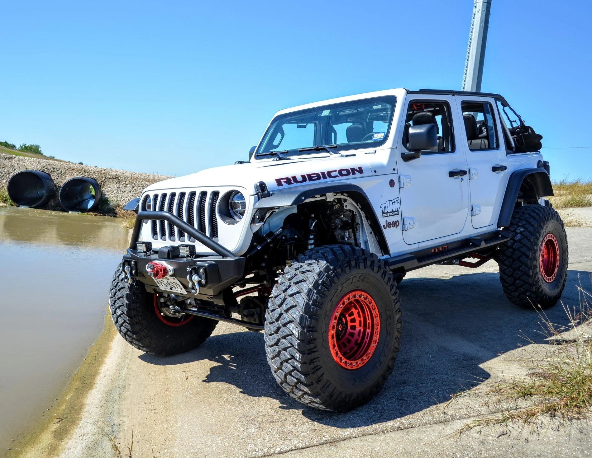

This looks so good. Can i ask a really dumb question. If I go with something like this do i have to lose my fog lights altogether? Am i better choosing something that has slots for the fogs?
Thanks,
You can mount foglights to the top, but on that bumper with the recessed winch there would be no way to have them inside.
Here's the same bumper on my wife's a while back. We mounted two driving lights to the top, but you could do the same with foglights (not the factory)
Jeep Gladiator BUMPERS! DSC_1230~2

Really helpful, thank you. Your wife drives a beast!!!

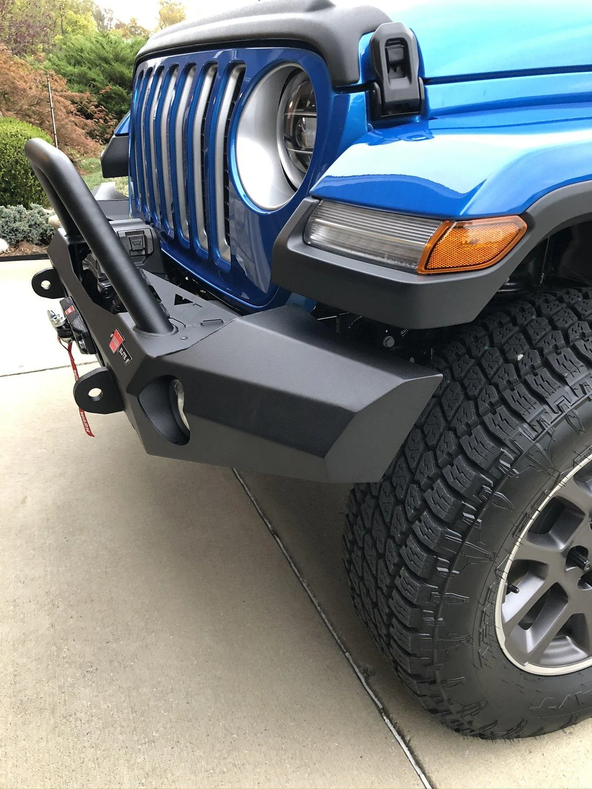

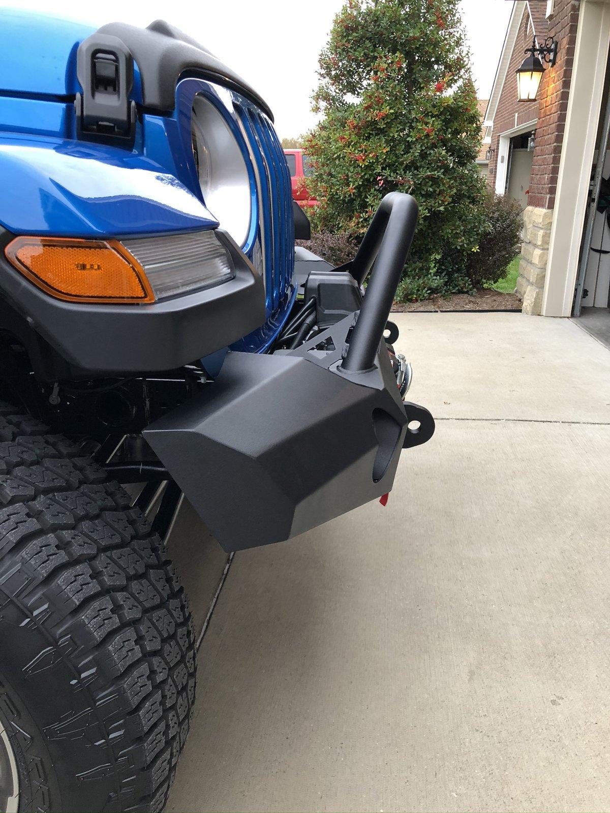

That is super clean, great lines! I have JCR front and rear of JK. This time i tried Poison Spider. Test fitted it with winch and lights. Don't mind the mallet marks...
The skid plate did not come with hardware or instructions, but must be installed prior to the bumper going on. So I put it on real quick the other day without the skid. i went and grabbed the hardware today and need to pull it and finish installing it. Poison Spyder unfortunately doesn't ship out hardware kits, but instead asked that I return it and repurchase which seemed odd. 4WD Hardware, 4wd.com is where I ordered everything and they were awesome. I told them it was fine, I would just keep it and grab the hardware myself, not a big deal really. They then credited my card to cover it and then some! Too generous!. Anyhow, I also ordered some piaa fog lights to mount up. Ill post some more pics when it is up and running. The next couple days are nice out and the kids are home, so hard to justify the time. We spent the day out of cell range on backroads and trails today. Didn't get anywhere too crazy (sans running winch!), but enough that we were scraping belly.
I have been thinking about the Poison Spyder bumper for mine as well. How is the trail camera view with the hoop?
